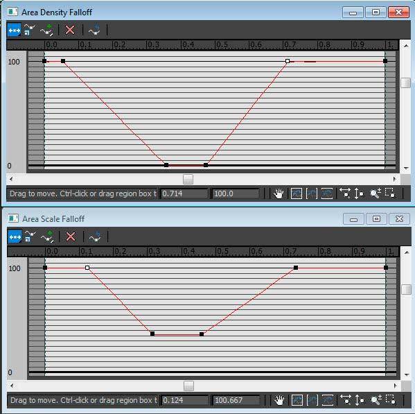

The ability to control size and density with falloff curves is a powerful feature of Forest Pack. Typically we use it to create natural transitions around boundaries but with a little creative control other interesting effects are possible.
  • Distance affected by the falloff curve is controlled by the range values, with separate controls for include and exclude areas.
  • The amount the falloff affects individual areas can be controlled by the falloff affect percentage spinner, enabling a degree of control over the strength of the falloff for each area independently.
  • The invert curve button flips the falloff curve, this is a fast way to create items that only spawn around the perimeter of areas.
  • In the areas rollout, tick to turn on falloff control for density and scale
  • Set the include size to about 2000mm, approximately half the width of the track.
  • Now we want to create the distinctive double trough of the rough track. Click on edit curve for both density and scale - it's helpful to be able to see the affect of these at the same time. Create a shape similar to the one shown in the figure below.

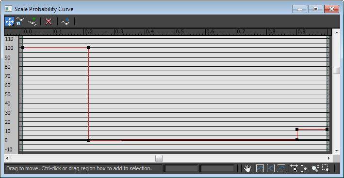

  • We want the majority of the stones to be in the 80 to 120% scale range with occasional larger stones at about 200 - 220%. To achieve this turn on probability curve for the scale controls.
  • Click on edit probability curve and create a curve that looks like the one below:
Probability curves
When creating probability curves the x access relates to the minimum and maximum range parameters and y axis represents the probability. The graph above represents a 100% chance of creating a small stone and a 12% chance of creating a large one.
As always in forest pack probabilities are normalised, there is no need to ensure they add up to 100% manually.

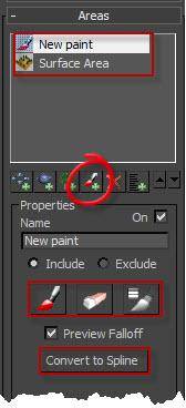

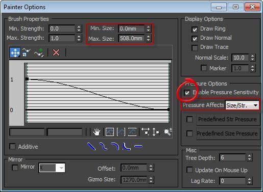

  • To create splines use two tools, Paint and Erase. When in these modes the size of the brush can be controlled from the painter options menu (shown below), accessible by selecting the brush options button. Control the size of the brush by changing the minimum and maximum size.
  • If you have a tablet you can use pen pressure to control brush size by turning on enable pressure sensitivity and setting the pressure effects drop down menu to size
  • Paint areas can be converted to splines by clicking Convert to Spline. This enables you to use Max's built in spline editing tools.
  • Any spline object can be converted to a Paint Area for further editing by clicking Convert to Paint.
  • Like spline areas, paint areas can be set in either include or exclude mode.

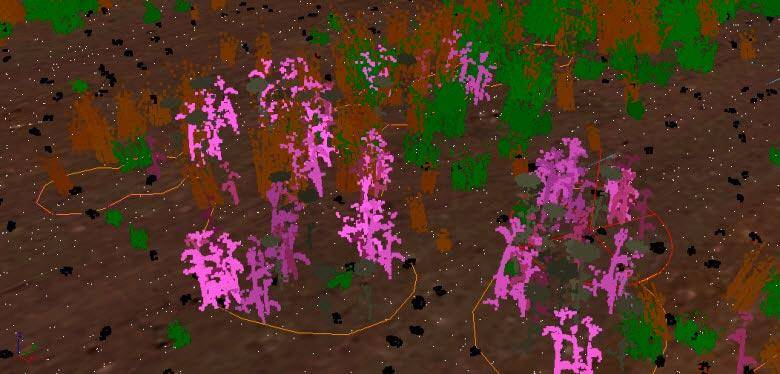

  • Create a new Forest Object named "Forest_flowers" selecting the "ground" and "road" as surfaces. This will allow us to paint flowers anywhere in the scene.
  • In the Geometry rollout add "flower1", "flower2", and "flower3" as custom objects. In the Transform rollout enable Translation, Rotation, and Scale. For this example we'll just use the default settings.
  • Set the distribution map to "dense" and the density to 4000mm
  • Now we are ready to start painting. Go the the Areas rollout and click Add New Paint Area.
  • Adjust the brush size to 400mm
  • Use the mouse or a tablet to create patches of flower growth down the center and the side of the track.
