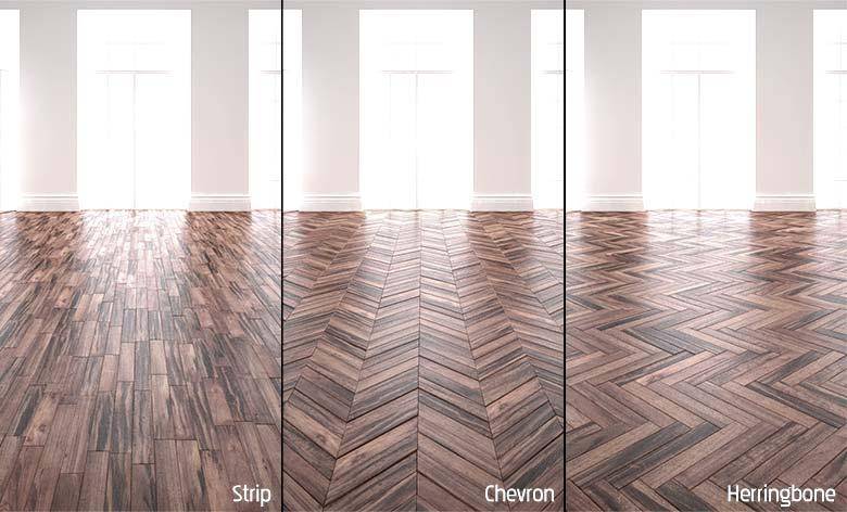

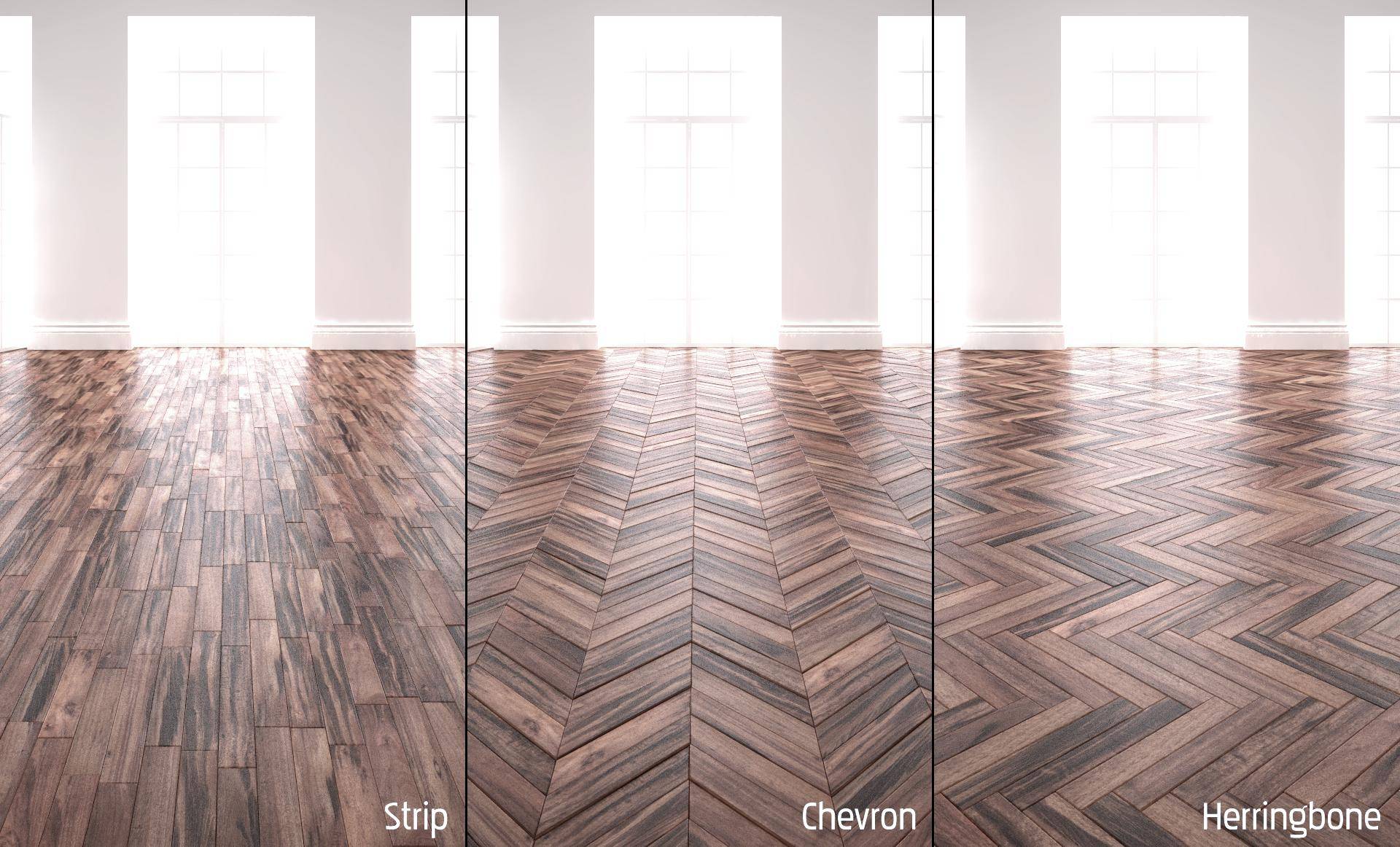

When preparing the geometry for floors it's best to think in terms of rows and columns and it may make sense in some circumstances to rotate the planks prior to creating a new style. If this is the case, remember to reset the XForm or adjust the pivot so that the local coordinate system aligns to the world. The top view below shows the arrangement of the geometry for the 3 styles covered in this tutorial.

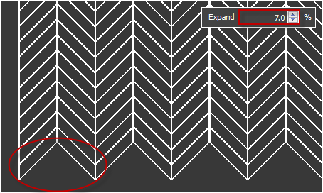

- As in this case, some patterns may leave spaces around the boundaries of the clipping path. To fix this simply go to the Array Generator's properties and increase the General>Clipping Area>Expand value to 7%. This function increases the physical size of the array that was calculated automatically by turning on Extend X/Y Size to Area.
