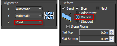

  5. Create a new Segment object. Set Properties>General>Alignment>Z to Pivot and Properties>Deform mode to Vertical. This will ensure the supports remain upright.

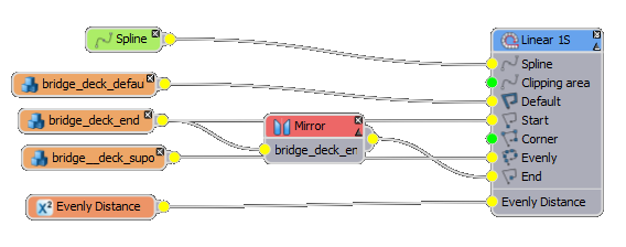

  10. With the new node selected press the Properties>General>Object button and select the mesh named bridge_deck_end then connect it to the Start input.
  11. Wire the bridge_deck_end segment to a new Mirror operator, then wire the Mirror operator to the End input of the generator.
  12. Add the supports by copying and pasting either segment a third time, this time pick bridge_deck_support_fixed from the scene and connect to the Evenly input.

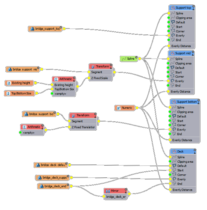

  2. We'll keep the existing L1S generator but in this example it will only be used to create the bridge deck. The supports will be created using three further generators - one each for the top, middle and bottom as demonstrated below..

  5. The geometry for this segment already has a pivot point aligned to the top of the road surface. To use this change Properties>General>Alignment>Z from Automatic to Pivot.
  6. To stop the geometry from bending along the spline, turn Off Properties>Deform>Bend and set the mode to Stepped.

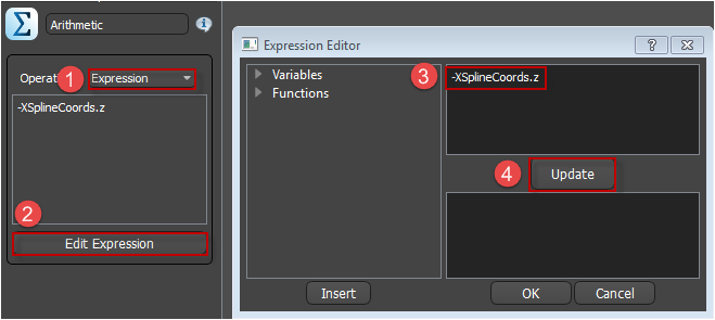

  9. We need to move this segment down so that it always sits exactly on the RailClone object's Z position instead of following the spline. To do this it's necessary to determine the Z distance between the RailClone object and the spline at the segment's current position. Luckily there's a function in the Arithmetic operator that does just that. Create a new Arithmetic operator and set the Operation Type to Expression. Click Edit Expression and enter -XSplineCoords.z. Note that the variable has been made negative to move the segment down on the Z axis, below the spline. Wire the Arithmetic node's output to the new transform operators exported Z Fixed Translation input.

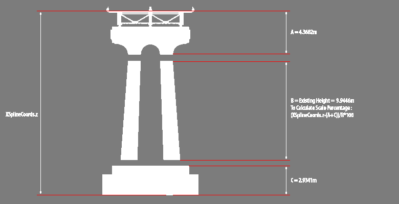

  11. As we've just seen we can use XSplineCoords.z to find the distance between the RailClone objects pivot point and the z position at the segments location along the spline. By deducting the heights of the top and bottom sections from this value we can find the measurement required for the middle section to fill the remaining space. Unfortunately segment's do not currently have a Z height property measured in scene units but we can achieve a similar effect by using the height of the segment's geometry to calculate a scale factor (expressed as a percentage). The equation will therefore be desired_height/geometry_height*100 so for instance if the geometry is 2m high but we would like it to be 20m high the equation would be 20/2*100=10*100=1000%. To recreate this in RailClone we need to know a few measurements:
  12. Using this information we can construct the equation. Create a new Constant parameter called Top+Bottom Height and enter a value of 7.3023m, this is the sum of the top and bottom heights.
  13. Next create a second constant called Existing Height and enter a value of 9.9446m.

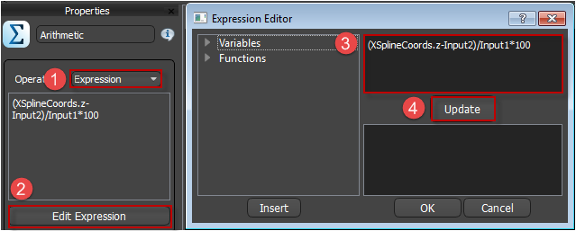

  14. Now create the equation. Connect Existing Height to Input 1 and Top+Bottom Height to Input 2 of the Arithmetic operator. Set the Operation type to Expression and open the Expression Editor. To translate our equation desired_height/geometry_height*100 to RailClone, enter (XSplineCoords.z-Input2)/Input1*100 in the expression editor and hit Update.
