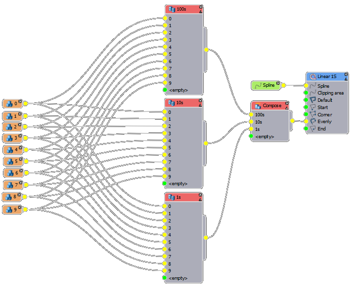

The node tree for this style.

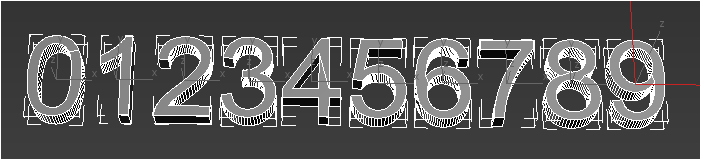

  1. Create ten number meshes from 0 - 9 and add them as segments to a new RailClone object.
  2. Wire these to a new Sequence node.
  3. The next steps depend on the maximum size of the number you intend to create, but we'll assume it's three digits. We need to duplicate the sequence operator so that there's one for each digit, rename them 0s, 10s, and 100s.
  4. Connect the three Selector nodes to a Compose operator in the order 100s,10s,1s. Wire the Compose operator to the Default or Evenly input of an l1S generator.

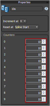

  5. Next we need to ensure the numbers at each position increment in the correct way. In the 10s Sequence operator's properties, increase the Count to 10 for all the segments.
  6. In the 100s Sequence operator properties, increase the Count to 100 for all the segments.

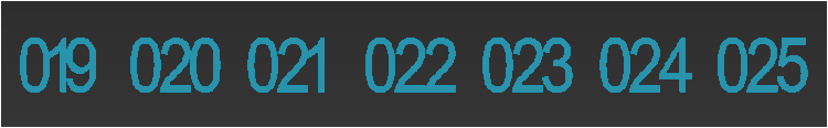

  7. This should give you geometry that counts up as the segments increase.

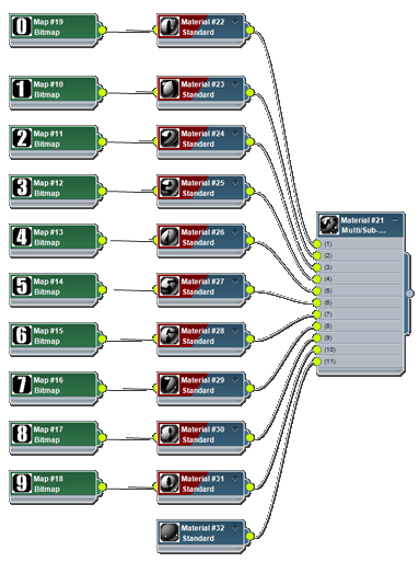

As an alternative to using geometry, it is also possible to create numbers by controlling material IDs. For this to work it's necessary to create a Multi-Sub Object material that has the numbers 0-9 in the material ID slots 1-10.
The material setup for this style

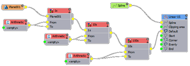

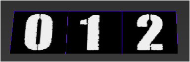

  1. Create an object that has 3 material IDs (1 to 3), one for each number. UVW map the object so that each ID fits a single number map. Add this to a new RailClone object.
  2. Create 3 Material operators, each one targeting one of the 3 IDs created in the first step. Wire them in sequence and attach the segment to the last one. For each material node Export the From and To values and rename the nodes 1S, 10s, and 100s.

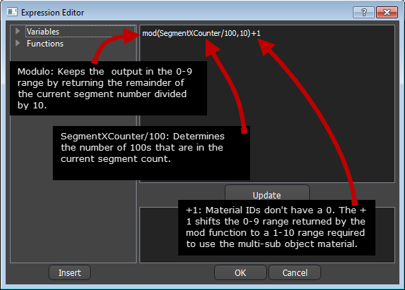

  3. Add a new arithmetic node and create a custom expression. For a 3 digit number we need to divide the segment's index by 1,10, and 100 to calculate the values required to reconstruct the number. For the 100s enter mod(SegmentXCounter/100,10)+1
    Segment Counts
    SegmentXCounter returns the number of the current segment in an array on the X axis. It is also possible to count a segments position on the Y Axis using SegmentYCounter.
  4. Wire this arithmetic operator to the 100sMaterial operator's From and To inputs.
  5. Create a new Arithmetic operator and wire to the From and To inputs of the 10s Material node. Enter the custom expression: mod(SegmentXCounter/10,10)+1
  6. For the remaining material operator create a new Arithmetic node and enter mod(SegmentXCounter,10)+1 as a custom expression.
