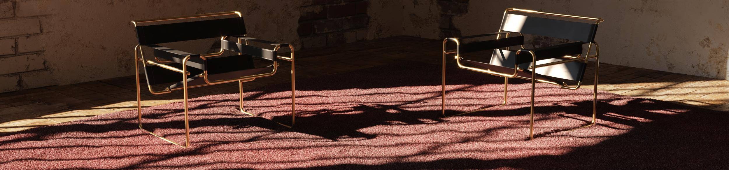

It's quite common to use scattering tools like Forest Pack to create a rug, but what happens when you want to put furniture on it? In some cases, it can be challenging to get the furniture to look as though it is sitting on the rug convincingly, especially if it has thin leg elements or is a particularly deep pile rug.
Take this example, which has both those characteristics. You can see the bottom of the chair is lost in the rug. You could move the chair up, but then it will look as though it’s floating on the top of the fibres.
In this tutorial, I’ll show you a quick way to simulate the strands of the rug being pushed aside by the chair, much as they would be in real life. Here’s how our close-up would look with this effect.
Much better, I hope you’ll agree. Even at mid distances, the effect is still apparent,
 and at wide angles too! These small differences really help make things look more believable.
