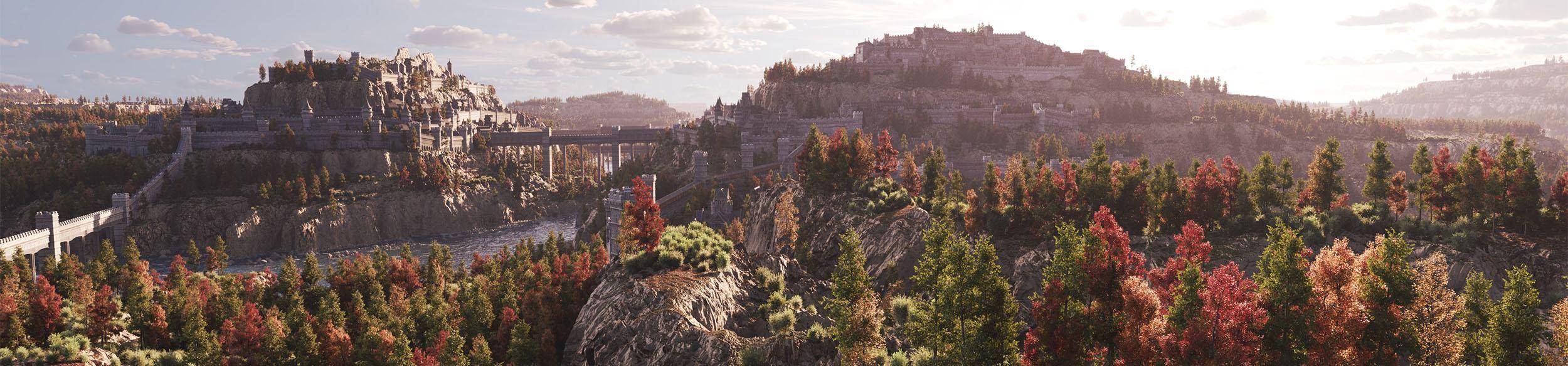

Let’s use the FP8 promo scene to take a look at how it works. We’ll start by looking at how to use Forest Sets with Areas.
To simplify things, we'll demonstrate using just two Forest Pack objects, this is a somewhat limited example of what you would probably expect to do in production, but we just want to keep it nice and simple to make sure the basic principles are clear.
In the scene there e got two Forest Pack objects, one adds trees, and the other adds buildings. I want to use the same areas for both to create a village on the ledges of these mountains.
