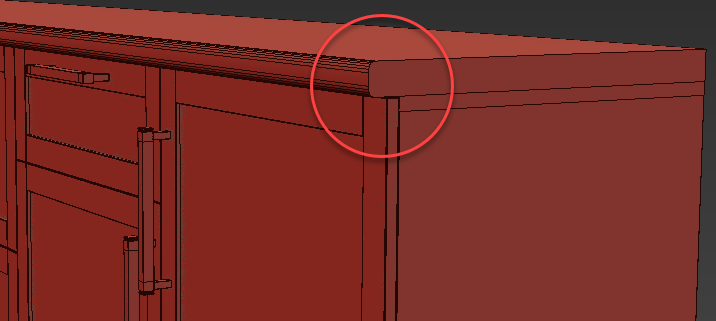

- Worktop Overhang is used to extend the worktop over the cabinets. You can also use a negative value to reverse the effect if necessary.

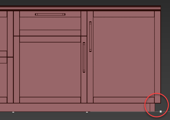

- Finally Door Padding can be used to adjust the gap surrounding the doors. When combined with Door Offset you canalso use this parameter to decide if the door is housed inside the frame, or mounted on the face of the cabinet.

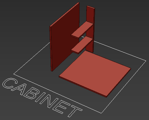

Above this, the cabinet is divided into the 3 parts: The bottom, the sides and the back. If necessary you could also add the top of the cabinet as an extra segment, but in my example I'm just reusing the bottom.

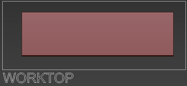

On top of the cabinet we have the worktop which is a single object. Nothing special here.

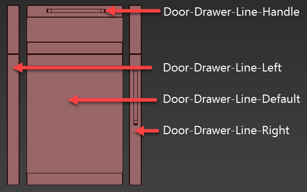

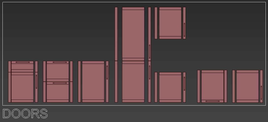

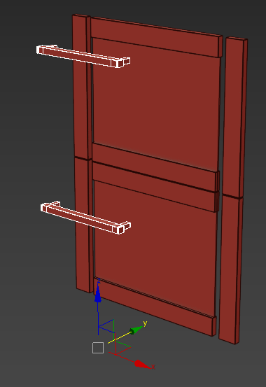

Finally we have the doors, these involve the most work because we need to separate them into those parts that can be stretched on the X axis and those that must remain the same size to avoid distortion. This usually involves splitting them into 3 parts, with two fixed size sides and a third section in between that scales to fill the available space. Any handles on the doors should be placed on the right hand segment as show below.
Handles in the centre of the width of the unit will need to be separate objects with the pivot aligned to the bottom of the door.

- It's most likely the doors you will want to change. To do this locate the clusters of segment nodes attached to 3 Selector nodes called Door Left, Door Default, and Door Right. These segments relate to the door pieces we saw earlier, the order that they are connected to the Selector operators determines the material ID number used to assign them to a spline section. Starting from the top the material IDs increase for each additional connection, so in this graph at the moment there are 8 different door type that can be selected. To add more just connect additional segments.
![Kitchen Cabinets with RailClone-image2016-6-24 11:54:43.png]()
- Let's add a door so that it is selected using Material ID 1. Remember it is made of 3 parts (4 if you include the centred handle)
![Kitchen Cabinets with RailClone-image2016-6-24 11:59:13.png]()

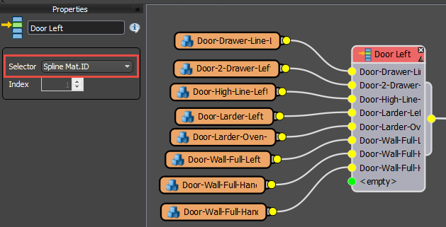

- Select the first Segment node connected to the Selector operator called Door Left.
- Go to the Properties Panel, Click the Object Picker button and Door-Drawer-Line-Left from the scene.
![Kitchen Cabinets with RailClone-image2016-6-24 12:8:26.png]()
- Now do the same for the other two selectors, making sure that the same input is used in each so that the IDs will match. Select the first Segment node connected to the Selector operator called Door Default.
- Go to the Properties Panel, Click the Object Picker button and Door-Drawer-Line-default from the scene.
- Finally select the first Segment node connected to the Selector operator called Door Right.
- Go to the Properties Panel, Click the Object Picker button and Door-Drawer-Line-right from the scene.

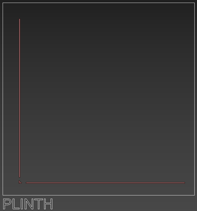

We'll start at the bottom with the plinth. There's already a RailClone object in the scene we can use for this exercise. It's largely empty with the exception of the segments that have been added to save a little time later. These are at their default settings except the Alignment > Y setting which is changed to top to align with the base spline correctly, as we'll see.

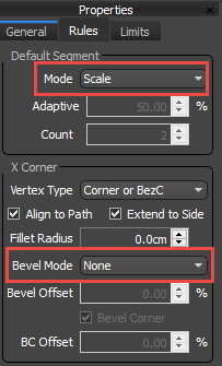

- Set the Generator's Default > Mode to Scale. This is so that the plinth segment will scale along the length of the spline without getting sliced. You should also change Bevel Mode to None to prevent the spline being sliced at each vertex change. This will maximise the amount of instancing that takes place as sliced segments render as static geometry.

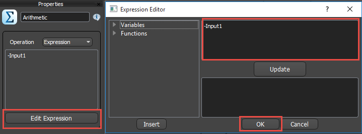

- Now we need to return the negative of the output from the Y Size node. The way to do this with the fewest nodes is to add an Arithmetic operator, change the mode to Expression and enter -Input1 into the expressions editor. Wire the Y Size node to the arithmetic node and then wire the arithmetic node to the generator's exported Y Offset input. If you get an error message, in this case it can be ignored because you're not using any incompatible features and it'll work fine. You can now adjust the depth of this from the Modify Panel and the plinths's back is aligned with the spline!

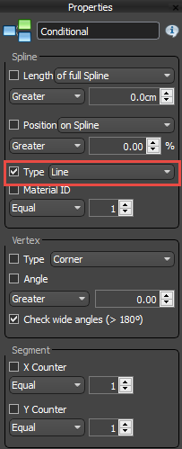

- Wire a Conditional operator to the Default input. we'll use this to detect the type of spline. Open the node's parameters and turn on Type, change the drop-down menu to Line.

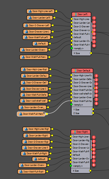

- Wire the Door Left selector operator to the first Conditional node's True Input.
- Wire the Door Left selector operator to the second Conditional node's false Input via a Mirror operator.
- Wire the Door Right selector operator to the second Conditional node's True Input.
- Wire the Door Right selector operator to the first Conditional node's False Input via a mirror operator. We have now set up some conditional that swap the geometry based on vertex type. Now let's scale the middle part of the door.
- Select the Transform node and export X Fixed Size . Wire the Door Default selector the the input.

Creating Centred handles
Finally, what about the handles? For the sides that's not a problem because we've already added them to the door segments but for handles that are on the top or bottom, for example on drawers, we can't use this approach because they will scale incorrectly with the default segment. Instead.we use another generator and add them to the Evenly input with a count value of 1 to keep them centred.Here's how:
- Duplicate the Doors L1S Generator and remove the existing segments from the inputs.The Z and Y Offset are set correctly for this one already.
- You need to make sure that the spline is always broken on the corners. To do this, wire a null segment to the Corner input.
- Change the Evenly mode to Count and enter a Count Value of 1. As mentioned this will add one handle to the centre of each spline section. Remember, where no centred handle is required a null segment is selected instead.
- Wire a transform operator to the Evenly input and wire the Handles selector to the Transform operator. Change Alignment > Y to Top and Alignment > Z to Pivot. This is to ensure they align correctly with the rest of the geometry but what we haven't done yet is allowed for the thickness of the door, so to do this export the Y Fixed Translation value.
![Kitchen Cabinets with RailClone-image2016-6-28 16:17:4.png]()
- Create a new Arithmetic node, set the mode to Expression and enter -Input1. Wire this to the Y Fixed Translation input.
- Finally right-click on the Door Default selector node and export the Y Size attribute. Wire this to the Arithmetic node to offset the handle the thickness of the door.
