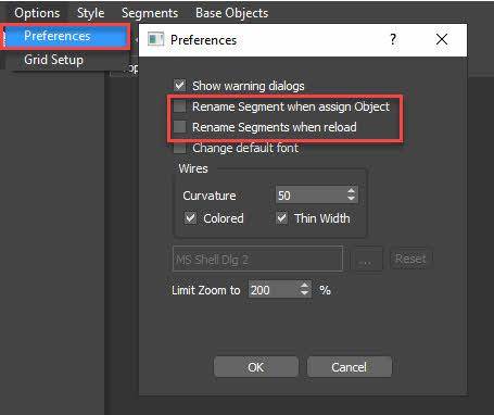

1: More control over segment renaming
We have introduced an option in the Preferences menu that allows you to decide whether segments will be renamed to match the source object. For instance, if you have assigned segments specific names to assist in identifying their function within the graph, RailClone 6 now allows me to maintain these names even when selecting new geometry. In previous versions of RailClone, when selecting new geometry, the names would be overwritten.

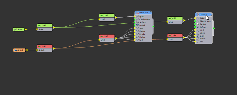

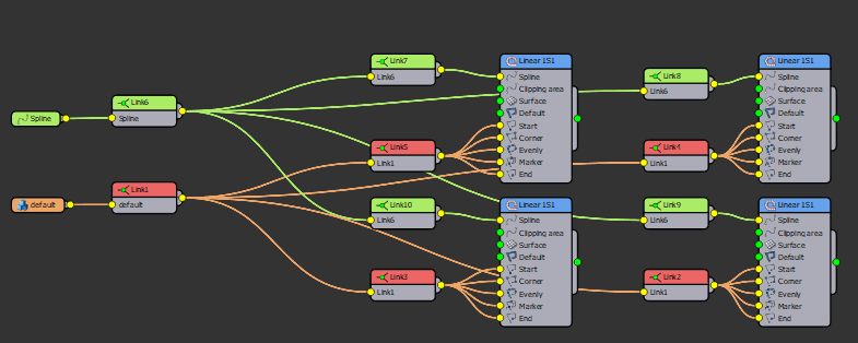

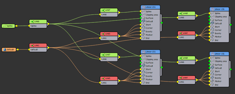

2: Shift and Drag to duplicate nodes
You can now duplicate nodes and wires using Shift and Drag. This function simplifies the creation of node and wire copies. Less obviously, but perhaps even more useful, you can also clone a wire in the same way. Simply select a wire from the input, hold down Shift, and drag to a new input. It's a small detail but a real time saver!

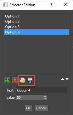

4: Save drop-down lists as presets
To further streamline your workflow, you can now save presets for drop-down lists, making it easier to reuse common settings. To use this, create a new drop-down list in a Numeric node, then save it as a preset by clicking on the Save icon. You can then load the list into a new Numeric node by clicking on the Load button and importing the file. You could create a folder full of extensively used lists and save a great deal of time!
5: Change wire thicknesses
This one is more about aesthetics - we've added the ability to change the wire thickness using a new option in Preferences>Wires, which allows you to customise the appearance of wires by choosing from two different thicknesses to suit your preferences.

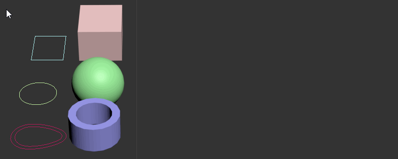

6: Import scene selection
Next, and this is a big one made possible by the always-on-top style editor. We've added an option to import the current scene selection to the Style Editor as new segment and spline nodes. This feature allows you to quickly create new nodes from existing selections, saving you the hassle of manually creating each node from scratch. Just select geometry or splines from the scene, right-click in the Style Editor and choose Import Scene Selection. A new base object node of the correct type will be created and the objects assigned accordingly.

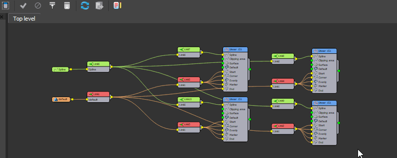

8: Hide wires
We've added a new option to hide all the wires, except for those connected to the currently selected node. You enable this in the View menu, or using the keyboard shortcut Ctrl + W. This feature reduces visual clutter, allowing you to focus on the node you are currently working on.

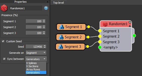

10: New Sync Between options
Finally, for even more control, both the Randomise segments and Random number nodes' Sync between Generators option has been renamed to simply Sync between, and it now provides several brand-new options. These allow you to further determine how to coordinate randomisation between various parts of an array. For this example, if you set the Seed options to Randomise per segment. Normally this would result in total randomisation, but what if I wanted to maintain randomisation, but ensure all the rows matched? To do that you can now change the Sync Between mode to Array Rows. If you'd rather create a randomised pattern that repeated for every section of the array, instead you could choose X Section.
Say you want a randomised pattern for each row, but that I want it to match on all the sub splines. You can now do that using Sync Between X Splines.
These options make the Randomise Segments operator much more flexible. And if you want to use these settings to randomise other parameters of a RailClone Style, you can do that too. The Randomise Number node also has the same settings.
