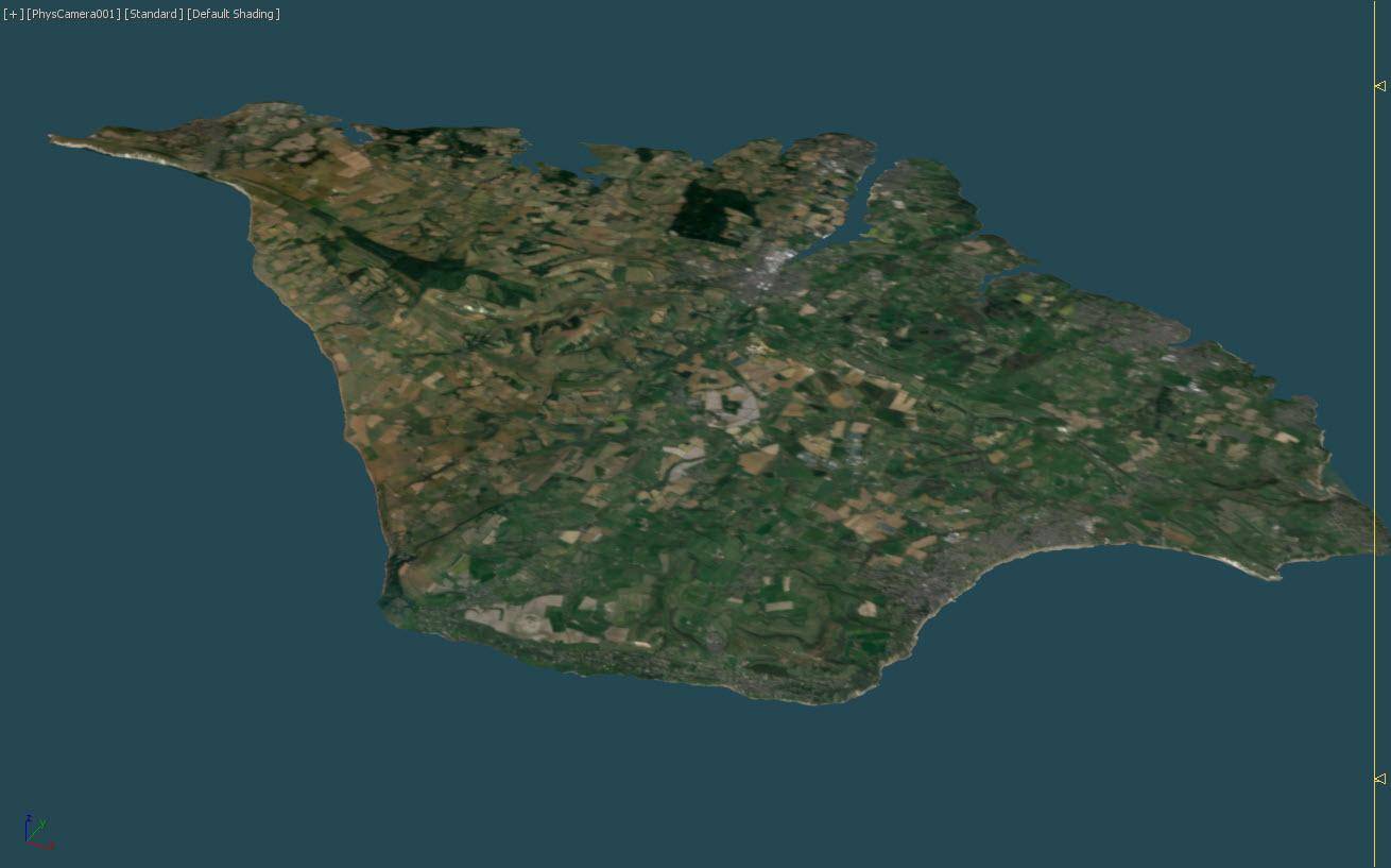

So, in 3ds Max Here’s how the Isle of Wight looks with its existing distribution of trees (we’re not sure how many are already there, we haven’t had time to count).

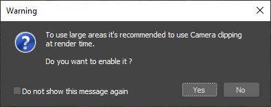

- Accept any pop-ups that arise, they’re just giving you good advice to optimise your scene including using camera clipping and points cloud display mode. ![Clipping pop-up]()

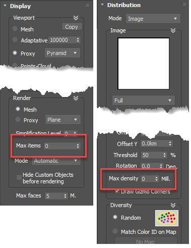

- The first thing to do is to remove some limitations. Forest Pack tries to stop you creating scatters that are so large you might crash your PC. Let’s fly without a parachute and remove them by going to the Display rollout and entering 0 for Max Items. Then go to the Distribution rollout and zero the Max Density. While you're here, increase the Density so we don’t start with an unmanageably dense distribution.![Removing Limitations]()

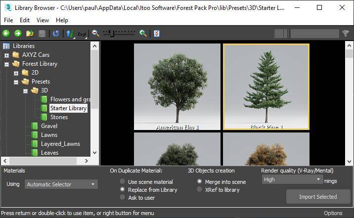

- Time to pick a tree. Go to the Geometry rollout and choose a tree from the built-in library. I’m going to go for this Black Pine.![Black Pine]()

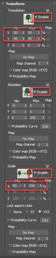

- That solid white distribution map creates an unpleasant grid-like pattern. Let’s break that up by going to the Transform rollout and adding some Translation randomisation. While we’re here. Let’s randomise the Rotation and Scale of the trees to try to disguise the repetition of a single model. ![]()

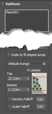

- Trees seldom thrive in the ocean, to remove them - go to the Surface rollout and turn on Limit by Altitude. Adjust the Bottom value until the trees are removed from the sea. Increase the Top value too if necessary,![Surface Rollout]()

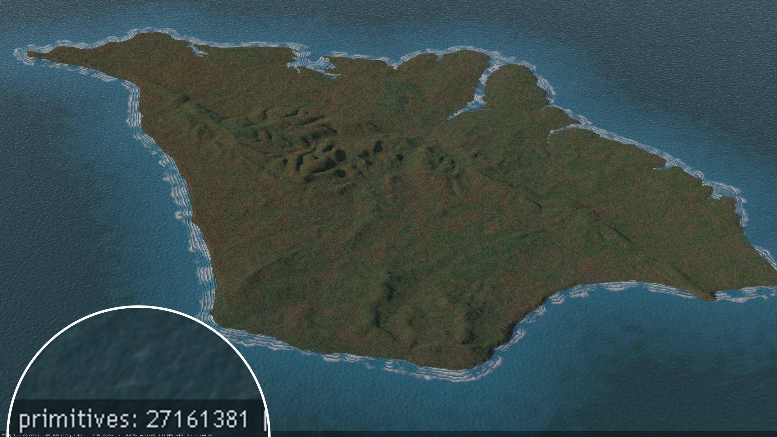

- Hit Render and … wait. There's a bit of a delay here - it is 20 million trees after all! After a while though, the render finishes and in our sample scene it looks like we decided 20 million trees wasn’t enough, there are actually 27 million 161 thousand 381 trees in this scene!![IOW Render]()
At this scale, it just looks like a green moss, but if we move the camera in closer and then render it again you can see that indeed that this scene contains individual trees. Moreover, the models and the materials were not optimised - in fact the tree I chose has in the region of 1.5 million polygons. That’s over 40 trillion polygons in the scene.
