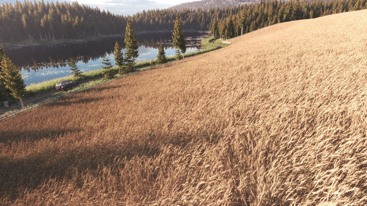

The next mode uses the same settings, but this time a map can be used to precisely specify the placement of a sample point from which the animation will start.
This can be useful in many situations for example, in the demo scene we used a simple noise map to create the effect of wind blowing across the field of wheat in waves.
