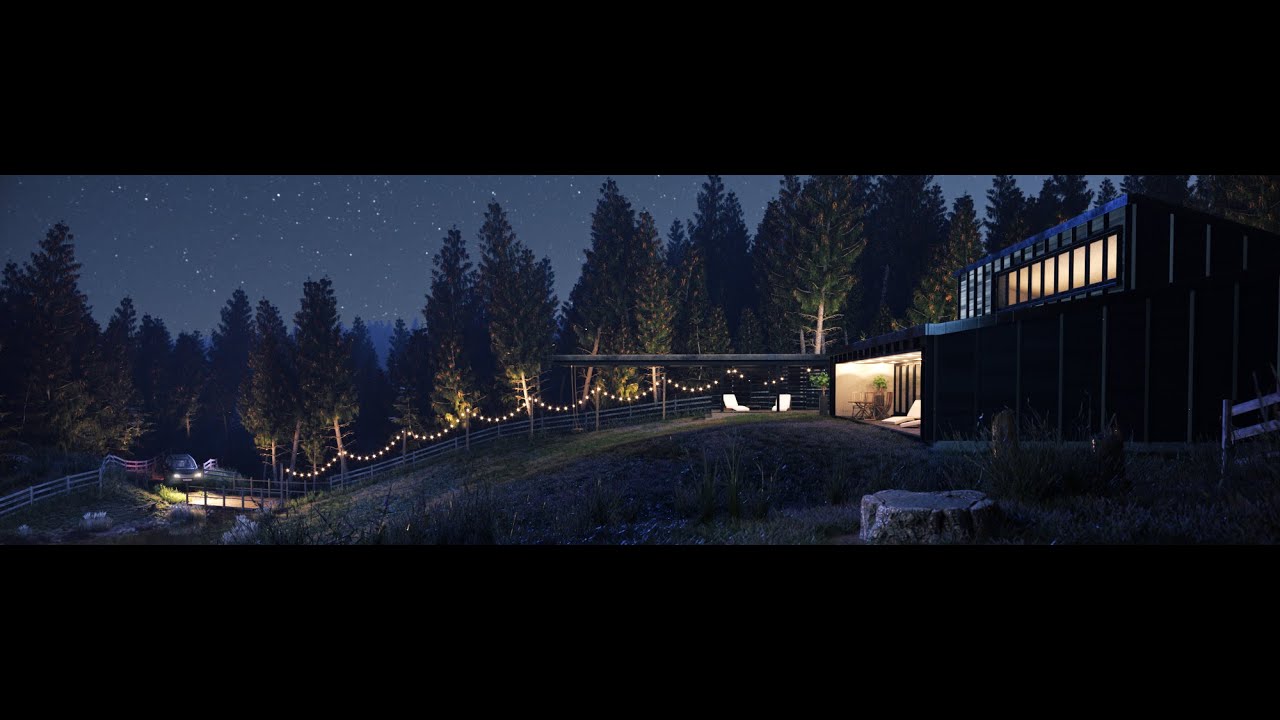

With the release of Forest Pack 7, V-Ray, Corona, Octane and Arnold users can now scatter non-geometric objects, including lights!
To use this feature there’s really no need to learn anything new, you just add a light to Forest Packs items list in the usual way as though it was geometry. You can now scatter it using any and all of Forest Pack’s many distribution modes. For example:
  • you could use Spline mode to scatter lights along a spline to create festoon lighting
  • You could use map based distribution and define a ceiling area to quickly add light lights. If you want to change the spacing, you can easily edit the FP item at any point making it far more flexible than placing lights by hand.
  • If you’ve received a file with markers where lights are to be added, you can easily use Forest Pack’s reference mode to attach lights to them. If the marker moves, the light moves!
  • Finally, you can even use PFLOW to place lights to open up this feature to a whole host of uses!.
