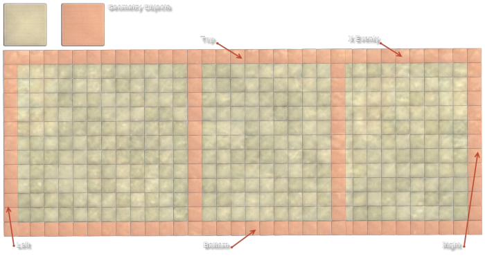

To create 2D arrays, RailClone uses the A2S Generator. In the Seaside Promenade scene this is used to create a paved revetment, using individual paving slabs as segments as shown below. This diagram identifes some of the parts of the Array that can be targeted when using this generator. For more information on the A2S generator, please see our detailed reference.
