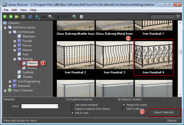

  4. Access the Library Browser by going to the Style rollout and clicking on the Style Name selector button, this will be displaying "none" as no style is currently loaded. The Library Browser will open in a separate window.
  5. In the Library Browser, from the File Navigator on the left hand side, go to Libraries>RailClone Library>Architecture>Railings>Exterior> and select Iron Handrail 4. Either double click, select Import This or Right Click>Use Item(s)

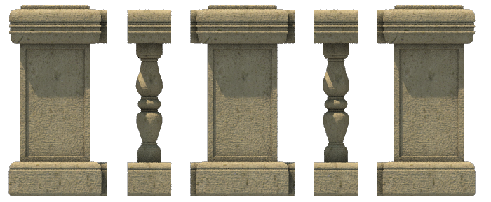

In this section we'll create a new style using the 4 segments picture below. A ruleset will be created to array this along a single spline, repeating the balustrades interrupted by pillars placed at regular 5m intervals. The lights will sit atop every other pillar. Having completed this section you should be able to:

    That balustrade is constructed from 3 segments, a pillar, a repeating mid section and a filler that is used to create a larger space between the two. The pillars and filler will be combined to create 3 composite objects as demonstrated in the image below. We'll look at how these are created using a compose operator:

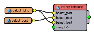

  12. Create a new Compose operator by dragging from the Item List to the Construction View. Rename it "Corner Compose".
  13. To create the corner section, connect segments to the new Compose operator in this order: Balust_Joint, Balust_Post, Balust_Joint. Attach the output of the Compose node to the Evenly input of the L1S Generator.

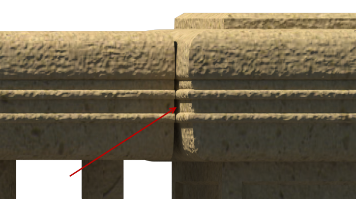

    Space between the Joint and Pillar geometry.

  19. To remove the gap between the joint and the posts go to the "Balust_Post" segment's Properties>General>Padding and change the Left and Right Padding to -0.04m. A negative value will move the adjacent segments closer, closing the visible gap.

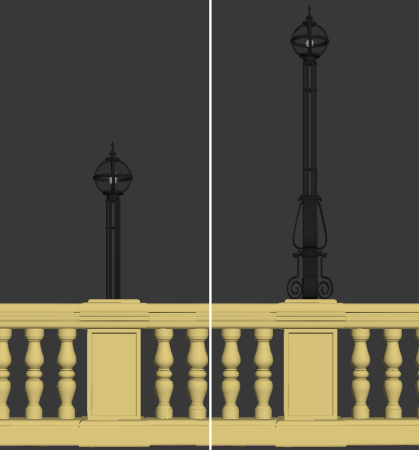

  21. Select the Balustrade object and reopen the Style Editor, we'll duplicate the existing L1S generator to create the lights. Right click and select Copy, then Right Click anywhere in the Construction View and select Paste.
  22. Attach the existing Spline object to the new Generator's Spline input.
  23. Create a new Segment object and pick the "Lamp" from the scene. Connect this to the Evenly input of the new generator.
  24. There's now a lamp intersecting each pillar, to raise and rotate the lamp so it sits on top of the pillar adjust the lamp segment's Properties>Transform>Translation>Z value to 1.094m and rotate on the same axis by 90 degrees
