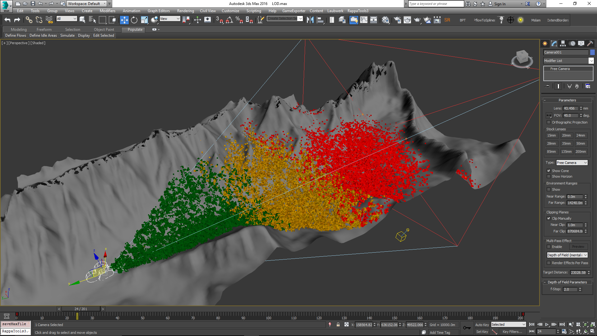

As well as LODs based on distance you can also control transitions according to their size in the camera view. To do this simply switch the mode to Minimum Screen size and then adjust the percentages. Note that you won't see the effect of this mode until you switch the viewport to the camera view.
- Change the mode to Min Screen Size.
![Level of Detail-image2014-10-16%2017%3A51%3A6.png]()
- Add Visibility > Max Min Screen Size values for each LOD level. The higher the value the closer to the camera, so the more complex models should have the larger values. Alternatively you can click
to automatically create values based on the object's order in the LOD list.
![Level of Detail-image2014-10-16%2017%3A52%3A44.png]()

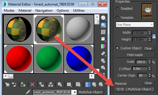

Assign materials to LOD levels
In addition to switching geometry you can also assign a different material to each LOD level. For example, you might want the trees nearest the camera use a 2 Sided V-Ray material, use a standard one sided material with an alpha in the mid ground, and for the background, where the leaf shapes are too far away to see, remove the alpha and use simple rectangular cards. To add custom naterials to LOD levels, follow these steps:
- Click on an object from the
LOD List.
![Level of Detail-image2014-10-16%2017%3A56%3A57.png]()
- Drag a material from the Material Editor to the Material slot in the Properties group. Simpler materials would normally be used furthest from the camera.
![Level of Detail-image2014-10-16%2018%3A4%3A42.png]()
- Repeat for each object in the LOD List. Alternatively if you have a unique object for each LOD level, you can also apply materials directly to the source geometry.

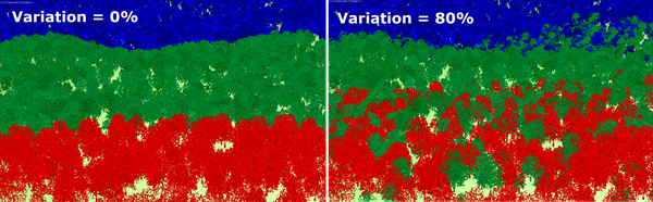

Adding variation to minimise popping
To blend between the LOD levels, ForestLOD provides a variation parameter. Use this to add randomness to the Maximum Distance or Screen Size settings to blur the boundary and help to disguise the transition from one LOD level, reducing visible popping when rendering animations.
