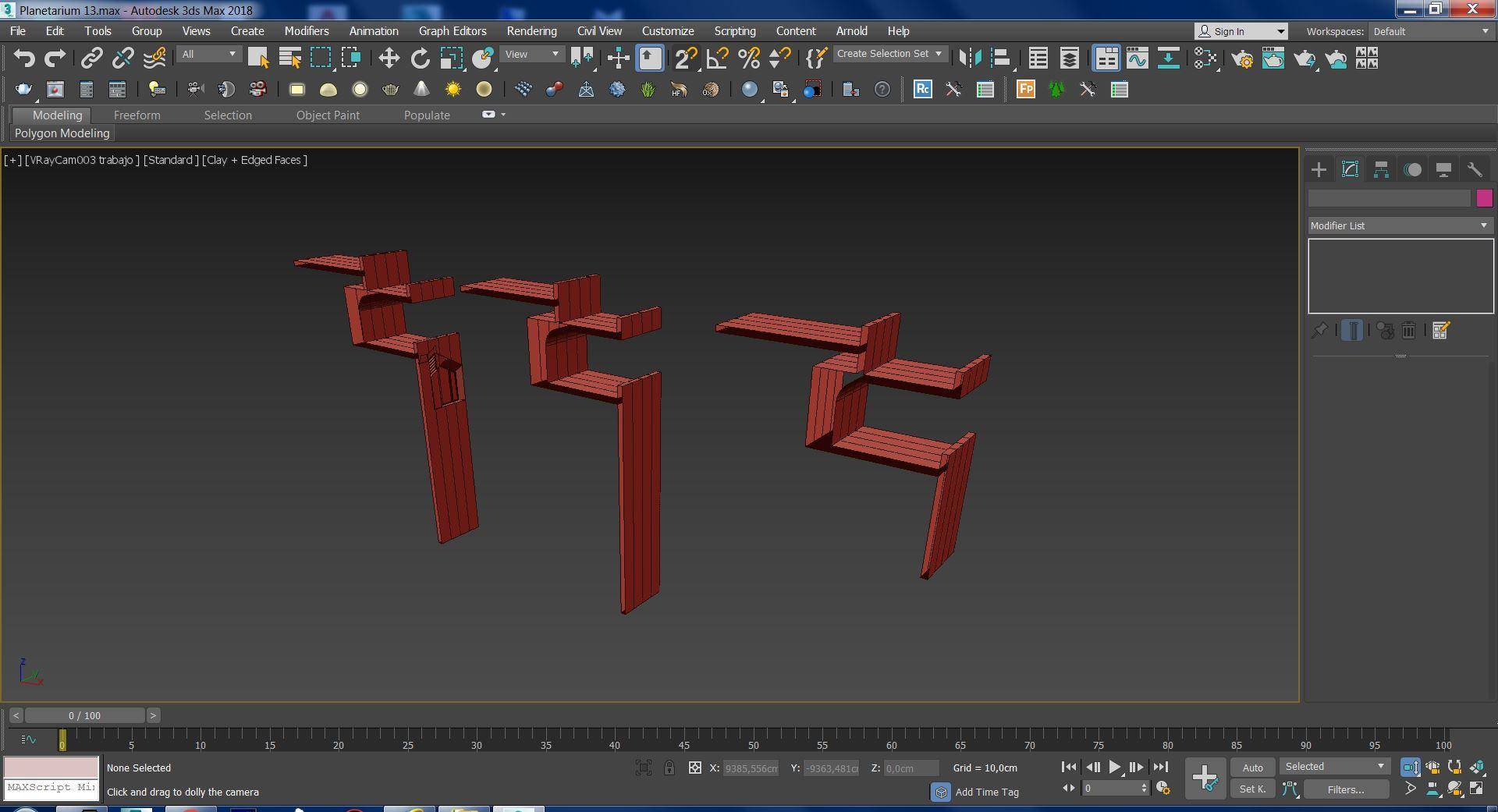

One of the reasons RailClone can help artists like David is its ability to make large sophisticated procedural objects from relatively simple and easy to model repeated elements. The Ramp in the Gordon Strong building is a good example. The whole object is created from the 3 modular pieces shown below. These are much easier and faster to model that then the entire building, and it only takes a little forward planning and understanding of RailClone’s approach to modelling to save a lot of time.
Frank Lloyd Wright - Using RailClone to create his unbuilt masterpieces

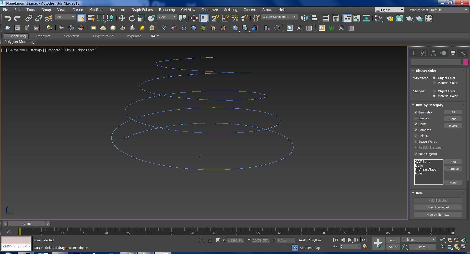

You might wonder how these 3 simple pieces become a whole façade? It’s actually very simple. RailClone is able to repeat and distribute geometry along splines, and deform it to follow the curvature of the path. By arraying the pieces along the helicoidal spline shown below it was possible to make the whole ramp section from just a few pieces. Best of all, because RailClone is a procedural object, it’s easy to edit. By tweaking or substituting the original 3 segments, the whole building can be quickly iterated.

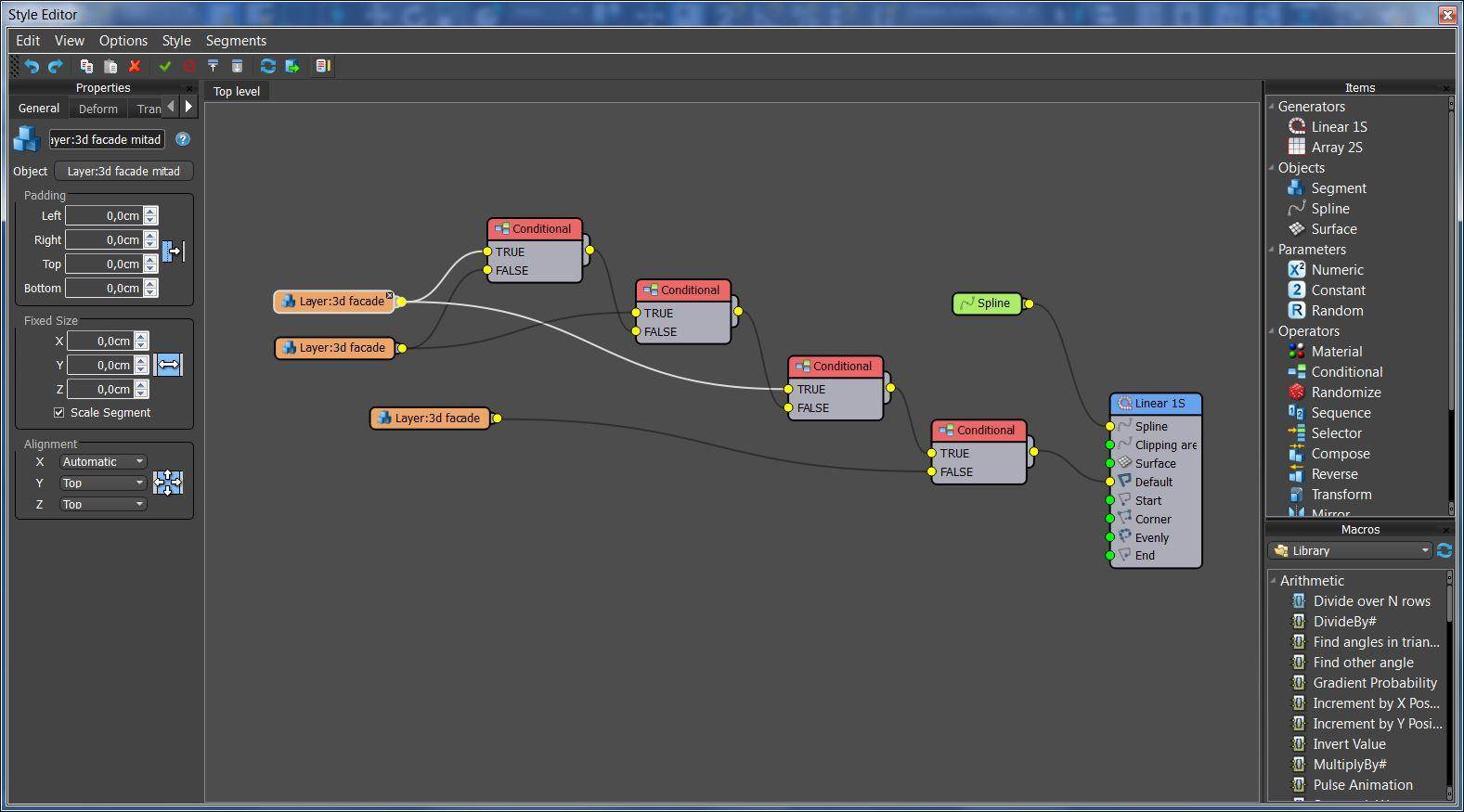

To control where the 3 source pieces were distributed along the spline, David used Material ID numbers assigned to the spline’s segments. By using RailClone’s Conditional operator it was then possible to target these parts of the spline with different geometry simply by testing to see if the segment was currently on the spline in an area with a correlating material ID. Compared to the rat’s nest of nodes seen in some procedural tools, the final graph shown below is refreshingly simple and quite easy to read, even if you are new to the plugin. You can see the Conditional operators connected in series to test for multiple IDs:

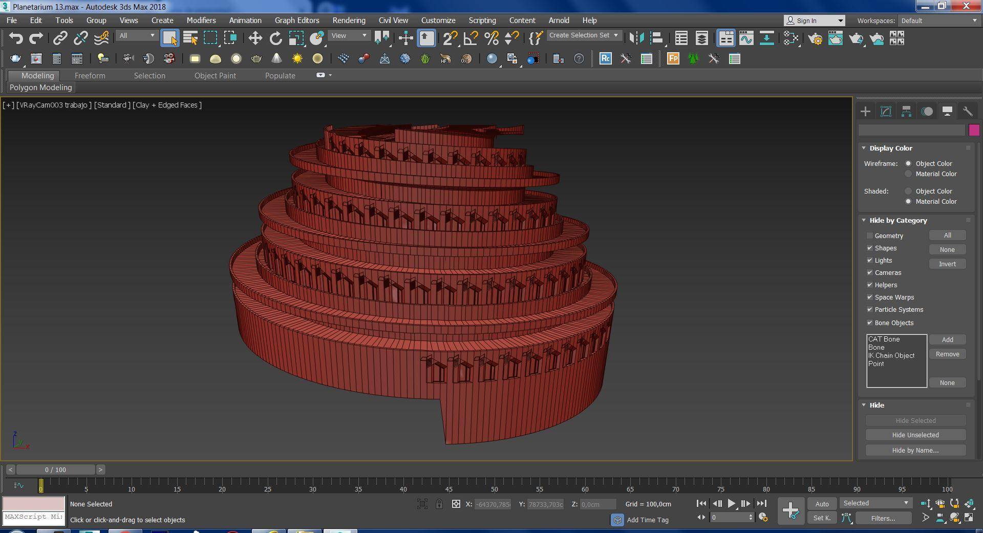

The final geometry for the building’s shell is shown below in the viewport and a render.

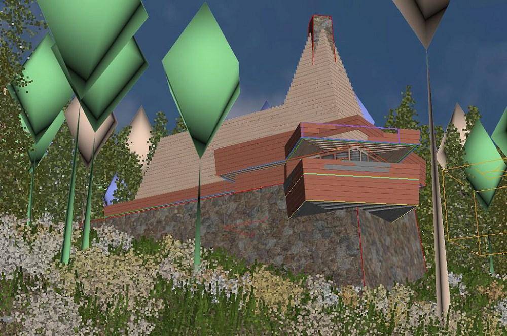

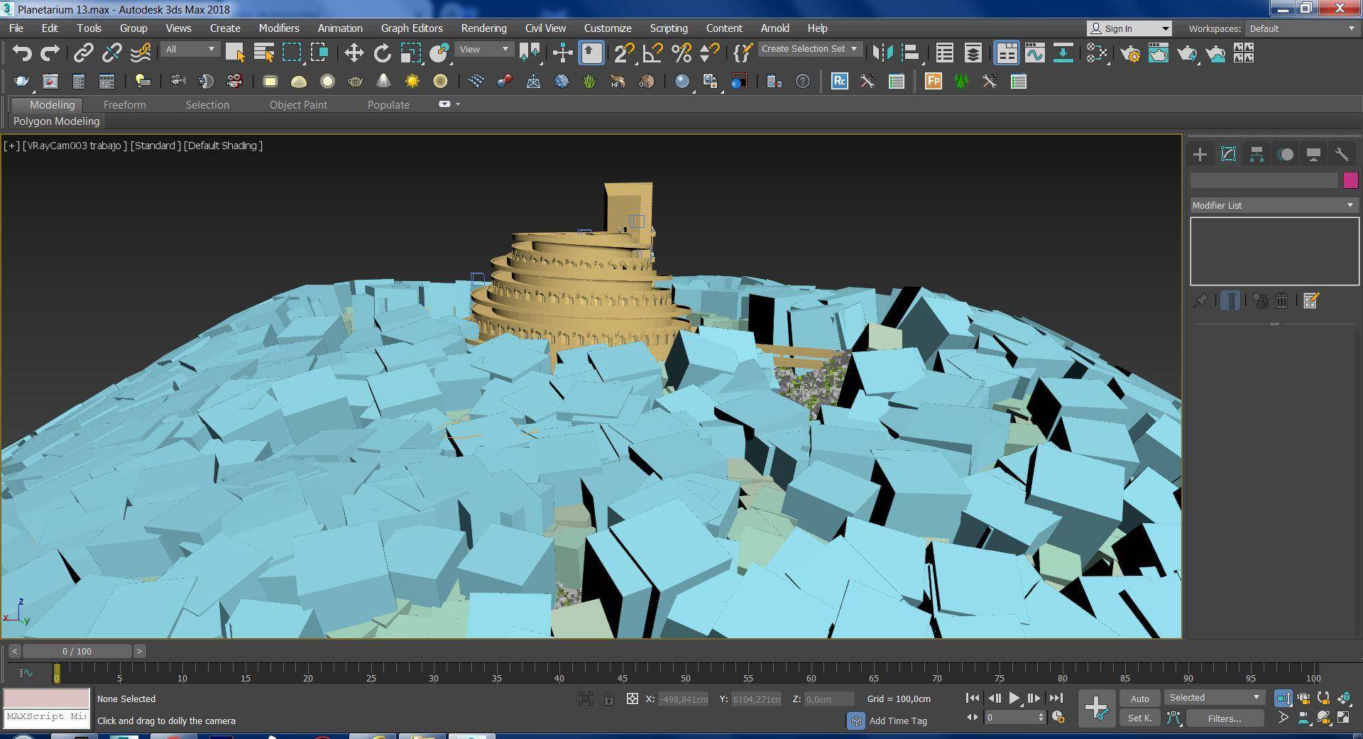

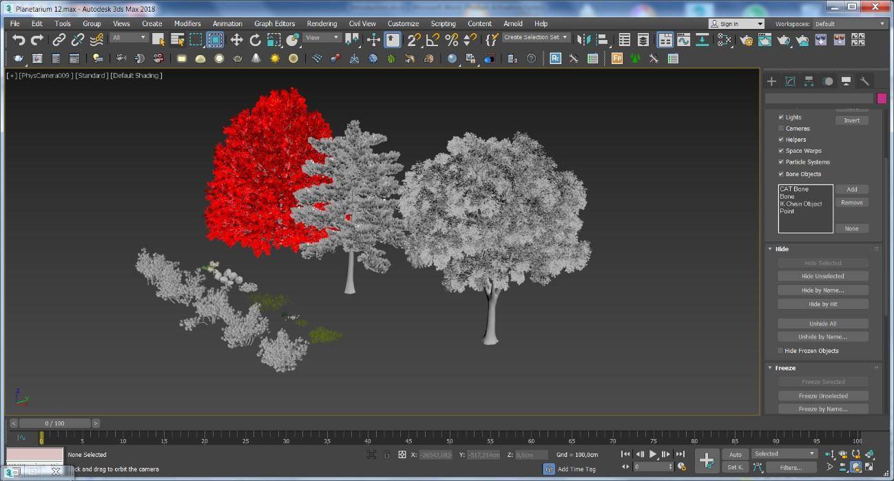

How many trees? Not as many as you’d think. By randomizing the translation, rotation and scale of plant models it is possible to disguise the fact that you are using just a few variations with no obvious visible repetition. In fact, there are only 3 trees used in the entire scene and just a handful of smaller plants, bushes rocks, and other ground cover as shown in the image below.
Using several Forest Pack objects to scatter these objects in successive layers on the terrain, David was able to create all the vegetation for the scene in a way that would render efficiently and was easy to update.
