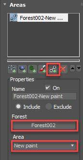

In this case though, rather than load the entire contents of another Forest Object’s Areas list, instead you can link to them individually. To illustrate, I’ll select the grass scatter and add a Paint areas in Exclude mode. I can then use this to remove some grass to add a path.
Now, if I wanted another scatter to add some stones, leaves or other things to the path I don’t really want to have to paint that all again. It’s inefficient and later if I change that path I don’t want to have to do it from 2 or more different Forest Objects.  Instead, I’ll link it to the existing area. Here’s how
  1. First I’ll add the surface, like we did above.
  2. Next go to the Areas rollout. There’s a new button here called Add Linked Area.
  3. I’ll click it and select the Grass Forest object
  4. The drop-down list allows you to select the Area in the linked Forest Object that you’d like to use. In this case I’ll pick the Paint area.
  5. Although the area is linked, it retains its own local parameters. This means that although the original area was set to Exclude, in this scatter I can use it as an Include area.
  6. Now if I go back to the Grass layer and start painting, you can see that in this scatter I am excluding the grass, but at the same time I am automatically adding leaves to the path using a second Forest Pack object.
