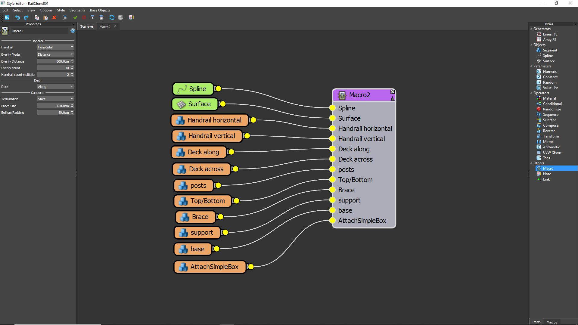

  • Begin by creating a new Macro node.

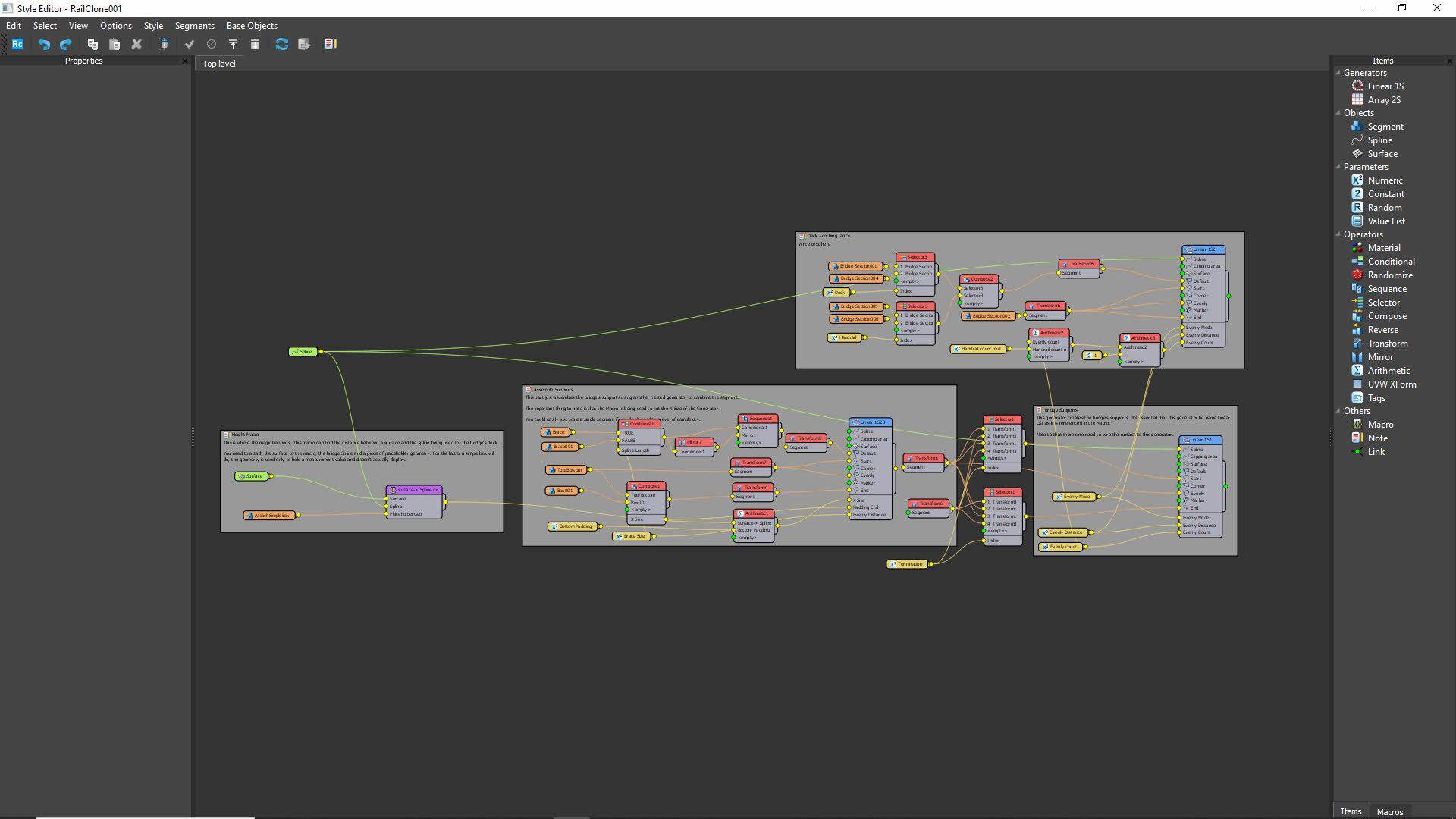

  • Select the entire graph, excluding the Macro node, and copy it.
  • Open the macro node's sub graph in a new tab by double clicking on it. Paste the copied graph here.
  • Once you switch back to the main graph, you'll see your new macro! From RailClone 6 onwards, all base objects are automatically converted into inputs, and numeric nodes, including drop-down lists, are turned into properties.

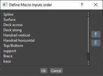

Changing input order
To change the order of inputs:
  • Return to the Macro's graph.
  • Navigate to the Macro menu at the top of the window and select Define Inputs Order.
  • From there, you can select an input and use the arrow keys to move it to a more logical position.

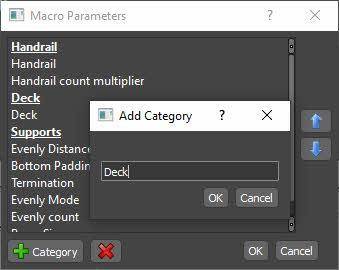

Organising Parameters
In RailClone 6, you can also organise your parameters.
  • Again, navigate to the Macro menu in the Macro's graph and select Define Parameters order.
  • Apart from changing the order of the parameters using the arrows, you can add labels to create logical categories.
  • Add a category, Click on the + button, give it a name, and position it using the arrow keys, just like we did with the parameters.
  • Once you return to the main graph and select your macro, you'll see your newly organised parameters in the Properties panel.
