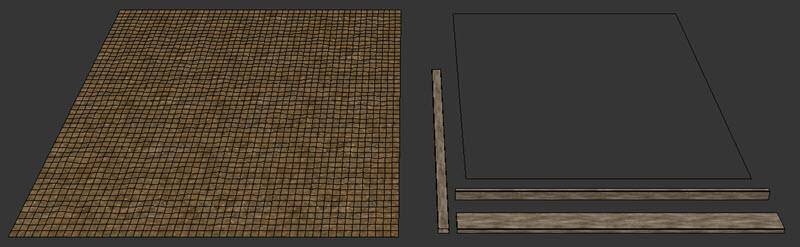

Let’s get started by creating the geometry for RailClone. It’s pretty straightforward, just 3 boxes and a plane for the bed. We need one box for the horizontal planks, one for the vertical stakes, and a third that will add a cap to the top. Finally, a plane is used with a noise modifier for the soil. Either make it large enough so that it will cover your biggest flower bed, or make sure that it will tile.

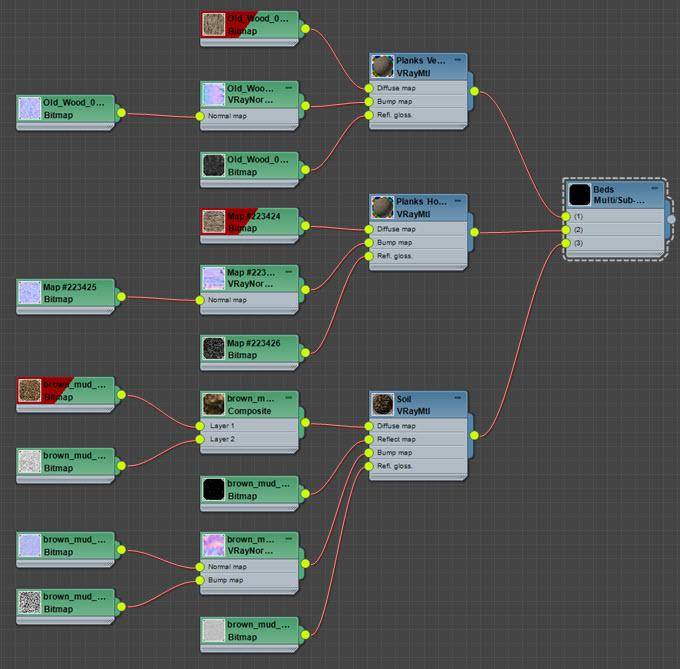

materials
The materials are equally simple. The shader starts with a simple free PBR wood material. Create a Multi-sub object material and wire this to Input 1. In this scene, we are going to use RailClone to automatically box map the objects using real-world map sizes and randomise the UVWs for variation. Because of this, we need two versions of the wood shader, the existing one with the boards running vertically, and a copy in which the maps have been rotated by 90 degrees. This one will be wired to Material ID 2
Apply this material to the source objects and check the alignment of the textures. If necessary, edit the Material IDs on the geometry so that the boards are running in the correct direction. Remember we have vertical boards on material ID1 and horizontal boards on ID2
Finally, we have a soil material on Material ID 3 for the mud, and that’s it! To see the final material, see the downloads for this tutorial.

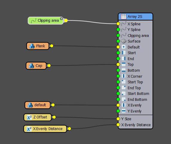

  5. Create a new A2S Generator.
  6. Create a Spline node and wire it to the generator’s Spline input. Select a closed path from the scene.

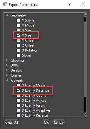

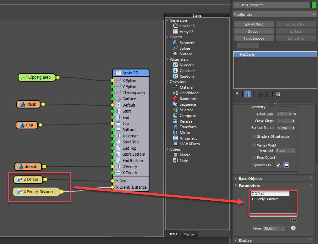

  7. Right-click on the Generator and export the Y Size and X Evenly Distance
    Export dialog
  8. Add two Numeric Nodes, change the type to Scene Units and wire them to the newly exported properties. You will now be able to edit these values from the Modify panel.

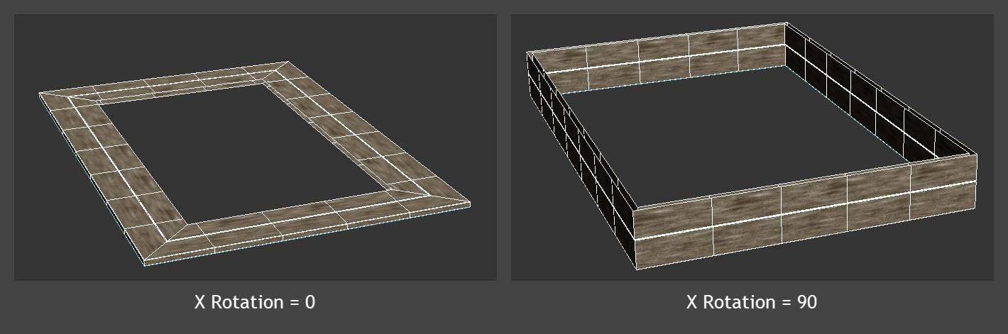

  11. Increase the Y Size value from the Parameters rollout in the Modify panel and you’ll see that the array is laying flat on the X/Y plane. To rotate it to be vertical, change the Generator’s X Rotation to 90 degrees.
    Image rotation

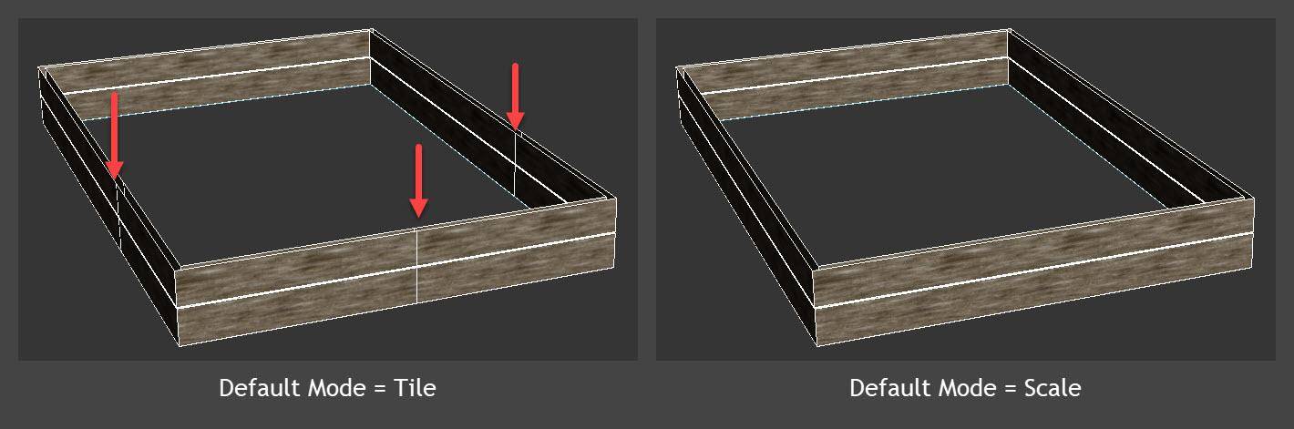

  13. To change the way the Default segment is distributed along the spline,  go to the Generator’s Default Segment settings. It is set to Tile, instead we want to change the mode to Scale. A single segment is now scaled between the Corners and/or Evenly segments.
    Default  Mode
  14. Create a new Segment node. Don’t pick any geometry but wire it to the X Evenly input. The boards will now be divided at regular intervals which can be adjusted from the modify panel. This is done so that the materials on each section between the stakes can be randomised separately for more variety.
  15. Let’s add a Cap. Create a new Segment node and pick the Cap geometry from the scene.
  16. Wire the Cap to the Generator’s Top input.
  17. Select the Cap Segment and change the Y Alignment to Bottom. The Y Size is now measured to the bottom of this cap geometry.
    Bottom Alignment
  18. Finally, to stop the cap from being divided by the Evenly segments, go to the Generator’s X Evenly settings and uncheck Extend to Side. While we’re here, let’s enable Adaptive too so that all the bays are an equal size.
    Evenly Settings

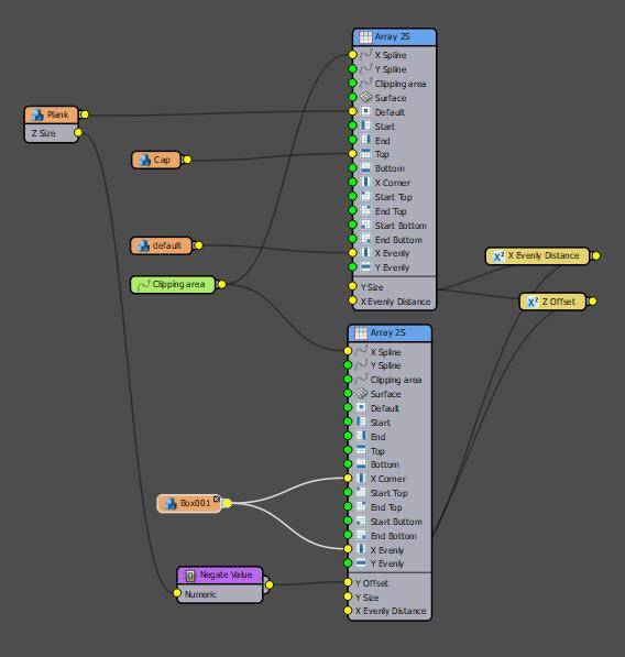

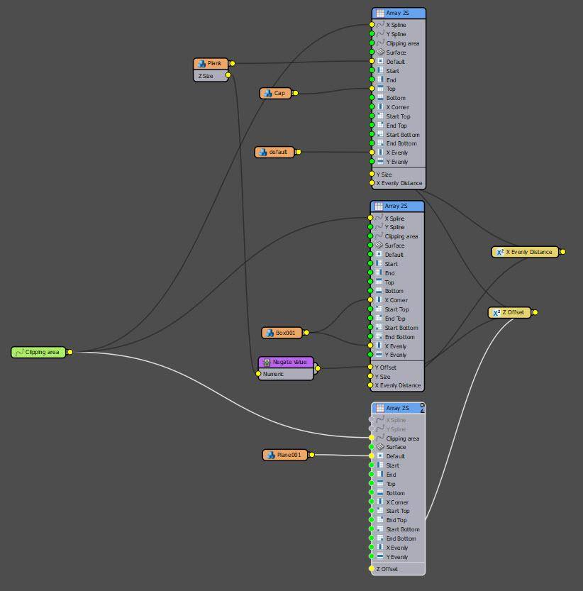

  5. Wire the Segment to the X Evenly and X Corner input. You will now have a stake on the corners of the spline and at each place the planks are divided, however, they intersect the boards instead of appearing in front of them. To fix this we will offset the entire array.

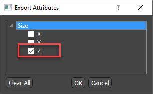

  6. Rather than hard-code the offset value, it is better to automatically read it from the plank geometry. That way you can change the geometry easily at a later date and the style will update automatically. To export the Plank’s size, right-click on the Segment node and choose Export Attributes > Z-Size
    Export attributes

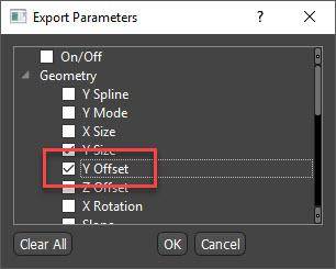

  7. Right-click on the new generator and choose Export Parameters> General > Y Offset
    Export Y Offset
  8. Connect the two new exposed slots together. The array has now offset the thickness of the plank, but in the wrong direction. To reverse the number, we need to multiply it by negative 1. You can do this with an Arithmetic and a Constant node, alternatively, there’s a macro called Negate Value especially for this purpose. Connect it to the middle of the wire.

  1. Create a new A2S generator
  2. This time we will use a different approach. RailClone can fill a closed spline with geometry. To enable this mode, go to the Generator’s setting and turn on Extend X/Y Size to Area
    extend X/Y size to area
  3. Attach the existing Spline node to the generator’s Clipping Spline input
  4. Create a new Segment node and select the soil geometry from the scene. Wire the segment to the Default input
  5. The soil is now filling the area, but it needs to be raised to the top of the bed. To do this, export the generator’s Z Offset property and wire it to the Y-Size numeric node. If you like you could always adjust the height from this point using the segment’s Z Fixed Translation parameter

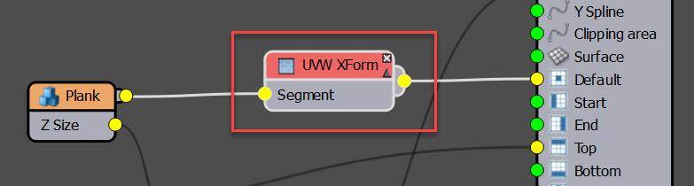

  1. Wire a UVW XForm modifier between the wood segments and the generator.
    UVW XForm

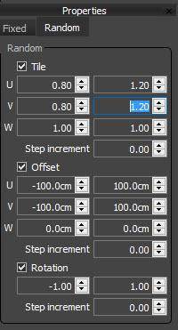

  2. Go to the Random tab in its settings and enable Offset. Enter a value of -1000cm to 1000cm for the U and V axes.
    UVW Settings
  3. You could also add a little Tile and Rotation variation too if you like.

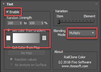

  5. Add a RailClone Colour material after the Wood material's diffuse maps.
  6. Enable Tint
  7. Change the Gradient setting so that it is white and one end and grey at the other.
  8. Change the Mode to Multiply. Each time the segment is used, it’s brightness will now be randomised.
    Tint Settings
