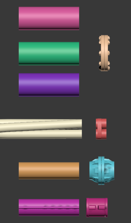

  1. There are six types of pipe in this scene, the first 3 have different textures and use the same joints and the remaining 3 have their own joint types.

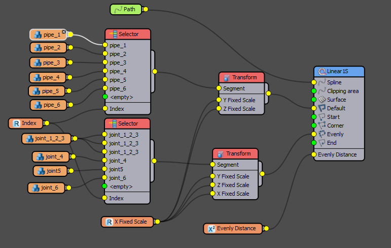

  3. To do this we need to employ a different technique to randomise the segments that gives us much more control over when a new random number is generated. This involves using Selector instead of Randomise operators. Normally Selector nodes are used to select a specific segment using a numerical input. But by attaching a random number generator to this value we can create a randomise function with considerably more control. To set this up, create a new Selector Node and wire all the pipe segments to the inputs. Create a second Selector operator for the joints, but wire joint_1_2_3 to the first three inputs. This is because pipes 1-3 use the same joint segment. Wire the remaining 3 joints to input slots 4 - 6.
    Creating a RailClone Tree-image2015-12-14 15:26:18.png
  4. In order to use a random number generator to select these segments it's necessary to create an input for the Index value. To do that Right click on the Selector node and go to Export Parameters > Index. Do the same for both Selector operators.
    Creating a RailClone Tree-image2015-12-14 15:32:33.png
  5. Create a new Random node and wire it to both the exported Index inputs. Select the Random node and go to the properties to set the Range. We have 6 possible segments so enter a value of 1 in the Min field and 6 in the Max.
    Creating a RailClone Tree-image2015-12-14 15:51:25.png
  6. All the pipes will now be identical because the Random node is generating only a single number. However the reason we use the Random node is because it's actually extremely flexible, it allows you change this to one of 6 possible options.
    • Start - Generates a new random number once for each instance of the RailClone object.
    • Segment - Generates a new random number for each individual segment.
    • X Spline Start - Generates a new random number for each spline sub-object found in the X Spline input of the Generator.
    • X Spline Section - Generates a new random number for each spline segment. For the purposes of this calculation a segment is the section of spline between two Corners or Evenly segments.
    • Array Y Row - Generates a random number at the start of each new Row. Only works in conjunction with the 2D arrays - Generator A2S
  7. We want a new random number per spline, so change the mode to X Spline Start. You now have a new pipe type for each spline and because the two selector operators share a Random node, they are kept in synch.

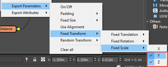

  1. Create a new Transform operator and wire it between the pipe's Selector operator and the Generator's Default input.
  2. Right click on the Transform node and export Fixed Transform > Fixed Scale > Y and Fixed Transform > Fixed Scale > Z
    Creating a RailClone Tree-image2015-12-14 16:9:50.png
  3. Create a new Random parameter and wire it to the newly exported Scale Y and Z inputs. The pipe is scaled between Evenly segments by the generator so we don't need to worry about the X axis.

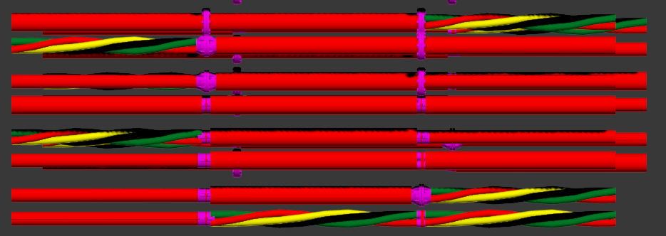

We've randomised the type of segments and their size; now let's look at materials. The twisted pipe has 4 materials applied using IDs 3-6. Pipe 1 also uses ID 3 and we'd like it to be randomise as well so that it takes one of the same 4 materials. RailClone has a Material operator for this purpose that we can add between the selector node and the Default input of the Generator:
Creating a RailClone Tree-image2015-12-14 16:26:54.png

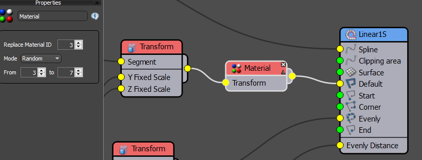

The material operator has a few limitations though: it generates a new random value per segment, and it can only randomise a single source ID at a time. The first problem is easily solved using a Random parameter node:
  1. Create a Material operator as shown above and change the Replace Material ID value to 3
  2. Right click on the Material node and export From and To.
  3. Create a new Random parameter and wire it to both exported inputs.
  4. Change the Min value to 3 and the Max value to 7 to set the randomisation range.
  5. Change Generate On to X Spline Start to randomise the Material ID 3 between 3 and 7 for each spline.

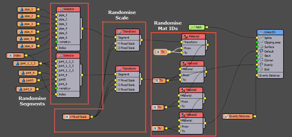

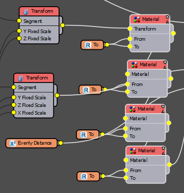

Now to tackle the second limitation. To randomise multiple IDs you can link together Material operators in a chain with one for each ID you wish to randomise. In this case we want to randomise IDs 3-6 so we'll need 4 material nodes in total. To do this:
  1. Select the existing Material node and its Random parameter node.
  2. Copy and Paste the selection to duplicate the nodes 3 times.
  3. Wire the material nodes together in sequence, with the transform operator in the first input and the generator's Default input wired the chain's final output.
    Creating a RailClone Tree-image2015-12-14 16:46:39.png
  4. Change each material node's Replace Material ID value so that the first is ID 3, the second is 4, the third is 5, and the final node is 6.
  5. Finally, change each random Parameter's Seed value so that they don't all generate the same number.
    Creating a RailClone Tree-image2015-12-14 16:50:20.png
  6. And that's it! The final graph should look like this:
    Creating a RailClone Tree-image2015-12-14 16:54:8.png

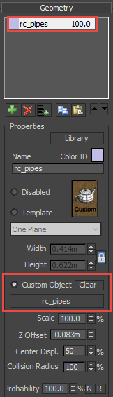

  6. Now select the Forest Pack object and go to the Geometry rollout. Change the Item to Custom Object and pick the RailClone tree from the Scene.
    Creating a RailClone Tree-image2015-12-14 17:41:46.png
  7. And that's all you need to do! Forest Pack is now scattering our RailClone tree - ready to render!
