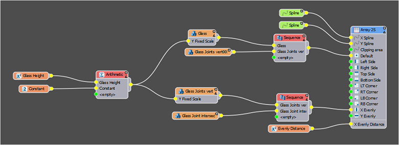

- Next we'll create a expression that allows us to adjust the height of the glass. To expose the Glass and Glass Joints Vertical segment's scale value so that we can control it with an expression, right click on the segments and select Export>Fixed Scale>Y.
- Create a new Constant node and set the type to Scene Units and the value to 100cm, this is the original size of the glazing geometry.
- Create a new Numerical node, name it Glass Height, and set the type to scene units. From the parameters roll-out found in 3DS Max's modify panel, change the property to 125cm.
![Creating Spider Glazing-params.png]()
- Create a new Arithmetic operator, wire in the Glass Height numerical parameter and the constant node, in that order.
![Creating Spider Glazing-constant1.png]()

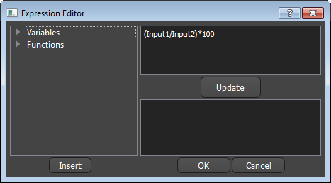

- From the Arithmetic operator's properties, change the operation type to Expression. Click on Edit expression and enter (Input1/Input2)*100. This will calculate the scale factor needed to resize the segment's height.
![Creating Spider Glazing-expressions.png]()
- Wire the arithmetic node to the Y Fixed Scale inputs exposed in step 10. You will now be able to control the height of the glass from the parameters roll-out.

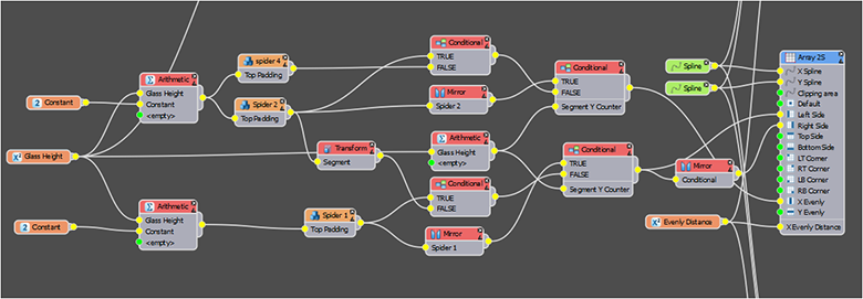

Generator 2. Create spider fittings
- Create 3 new segment nodes, set the Y Alignment to Pivot, turn off Slice and select Spider 1, Spider 2 and Spider 4 from the scene.
![Creating Spider Glazing-sliceoff.png]()

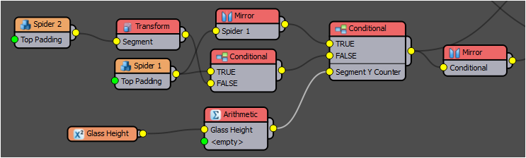

- We'll start with the sides of the array, in this column we need a Spider 1 segment at the top and bottom of the array, with a Spider 2 segment in between. To achieve this, create a new conditional operator and set the Segment>Y Counter>Equal property to 1. Wire Spider 1 to the true input, this will ensure that it appears as the first segment in the vertical array.
![Creating Spider Glazing-conditional1.png]()
- Wire Spider 2 to a new Transform node and set the Transform>Fixed>Z>Rotation to -90 to rotate the geometry. Wire the transform node to the False input of the conditional operator.
![Creating Spider Glazing-transform1.png]()
- Next we need to add a Spider 1 segment to the top of the column, to do this we need to calculate how many glass segments are likely to appear on the Y axis of the array so that we can use the Conditional Y Counter technique used above. To calculate this create a new Arithmetic operator and wire the Glass Height numerical parameter to one of its inputs. Change the operator type to Expression and enter ceil(YSplineLength/Input1). This expression divides the spline length by the glass height, rounds up and returns the value as an integer. Using this we can target the last segment on the Y axis.
![Creating Spider Glazing-expressions2.png]()
- Create a new conditional operator, right click and export Segment Y Counter. Wire this to the arithmetic node created in the previous step.
- Wire the Spider 1 segment into the True input of the new Conditional node via a Mirror operator with the Axis set to Y.
- Wire the conditional node created in step 2 to the empty False input of the new one.
- Wire the new conditional operator's output to the Left input of Spider Array.
- For the right side attach the same conditional node via a new Mirror operator with the axis set to X.
![Creating Spider Glazing-left_right.png]()
The node tree for the left and right inputs
- Next we need to do a similar process for X Evenly. Copy and paste the two Conditional operators we just created. This will give you two new connected conditional nodes. Disconnect any segments that are attached to them after being duplicated.
- Connect the new conditional nodes to the X Evenly input.

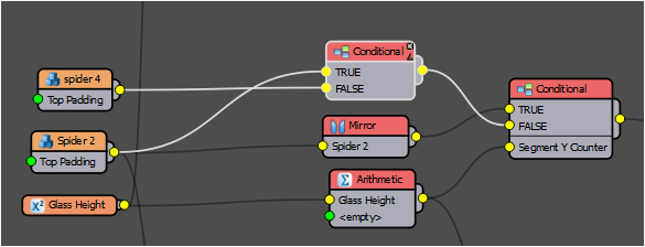

- Connect Spider 2 to the the True input of the leftmost of the new conditional nodes, also connect it to the True input of the second conditional node via a Mirror operator with the Axis set to Y to flip the geometry vertically.
- Connect Spider 4 to the remaining empty False input.
![Creating Spider Glazing-xevenly.png]()
The node tree for the X Evenly input
- For each spider segment, Export the Top Padding property. We will now add a simple arithmetic operation to add the spacing between rows.
- Create a new Arithmetic operator and attach the Glass Height numeric parameter. Set the operator mode to Subtract. Next create a new constant, set the type to scene units, and enter a value of 22.665cm. This value compensates for the size of the spider fixing. Wire this arithmetic operator to the Top Padding input of Spider 2 and Spider 4
- Create a new Arithmetic and Constant node as in step 15, except this time use a value of 15.63cm for the constant value. Wire this arithmetic node to the Top Padding of Spider 1.
- Finally, adjust the generator's Z Offset value so that the bolts sit correctly on the glass.
