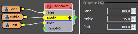

Randomise
The randomise operator does exactly what you’d imagine, it randomly selects a segment from the available inputs. Edit the Probability percentages to control the likelihood of an input being selected. These values are normalised so there is no need to ensure they add up to 100%

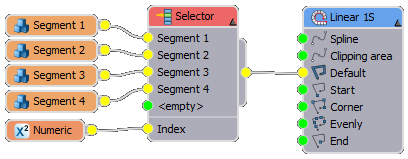

The Selector operator is used to choose from a list of segments using a numerical index or an attribute of the graph or markers.
As a simple switch, it can be helpful to create easy to edit styles. Wire segments to the Selector operator’s inputs. The order is important - the index numbering is built from the top of the list with an origin of 1. If you need to change the order, use the up and down arrows that appear when you select the segment name on the Selector node.
It can also be really useful to export the Index parameter to make changes without opening the style editor. To do that:
  1. Right-click on the Selector node and choose Export>Index.
    Exporting a parameter
  2. Create a new Numeric node and wire it to the Index input.
  3. You can now control the selection from the Parameters rollout of the plugin without opening the style editor.

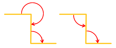

The Angle condition checks the angle formed by the spline at this vertex. There are two modes, When Enable Wide Angle is enabled it tests the spline according to a full 360-degree rotation, this can be useful for detecting internal or external corners. However, If this option is disabled, the angle is measured from both sides up to 180 degrees which will treat internal and external corners the same way.

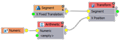

The Transform node replicates many of the parameters found in a Segment node. It’s a useful way to be able to make changes to several segments at once and it can also be useful where you wish to reuse a segment multiple times but with different properties.
It is also necessary to use the Transform operator when dynamically controlling a segment’s properties using arithmetic expressions, as shown in the graph above.

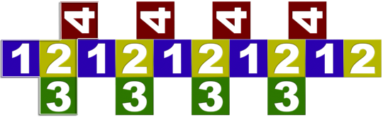

So far we’ve only discussed the Compose operator’s Sequence mode. The operator has a second mode called Grouped that aligns all the segments using their original pivot points.

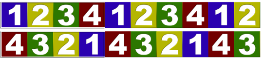

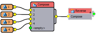

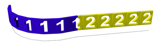

The reverse operator only works with Compose nodes that are using Sequence mode. It reverses the order of elements. For example, here we’ll change our Compose node back to Sequence and wire a Reverse operator to the End input. As you can see, the order is reversed.
Reverse
You also have the option to "Mirror Segments on X" which, as the name suggest, creates a mirror copy of each segment on the X axis. This node is ideal for reusing Start geometry in the End input.

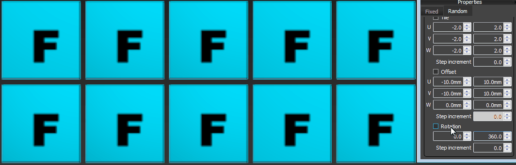

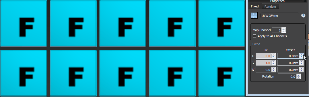

The UVW XForm operator allows you to manipulate the mapping coordinates already applied to a segment. There are two modes available: Fixed mode enables you to adjust the tiling, offset and rotation of UVW coordinates, in this case all segment's will have the same results.
UVW Fixed

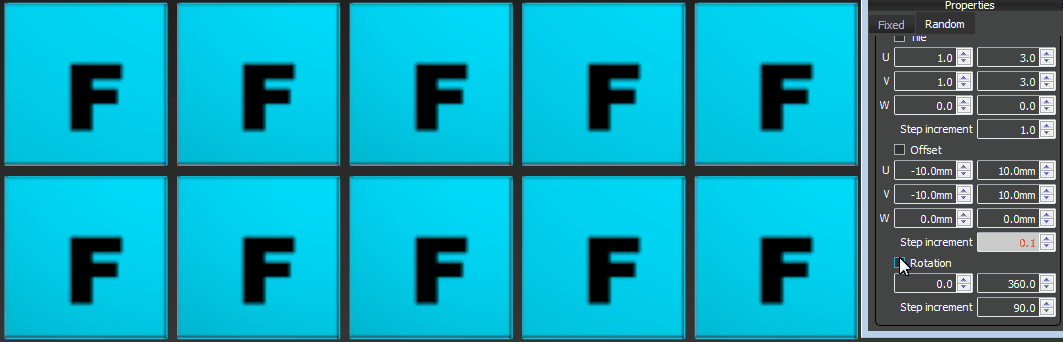

On the other hand Random mode allows you to randomise within a range the tiling, offset and rotation of UVW coordinate to create unlimited variations. There are also stepped increments for the randomisation controls so that you can sample individual parts of a map and add rotations at regular intervals.
UVW Random
UVW Stepped

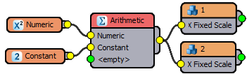

Finally, there’s the Arithmetic node which can be used with any numerical value for common mathematical functions like add, subtract, multiply and more.
