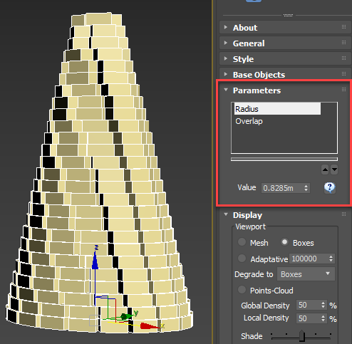

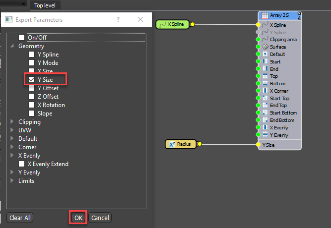

  5. To control the Y size, you could use the parameter in the Generator's properties, but to make it easier to edit we'll export it to the Modify panel. To do this, right-click on the generator and select Export Parameters. Select Y Size and click OK
  6. To add a parameter to the Modify panel, we add a Numeric node. Name it Radius, change the Type to Scene Units, and wire it to the Generator's Y Size input.

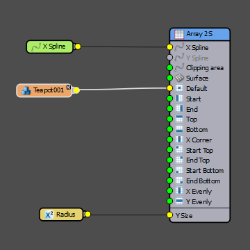

  7. We can't see the results of this yet because we haven't added any geometry. Create a new Segment node and pick an object from the scene, (for this example we'll use the venerable 3ds Max teapot). Wire the segment to the Generator's Default input.

  9. You can now edit the Radius value and the array will expand towards the centre of the spline.

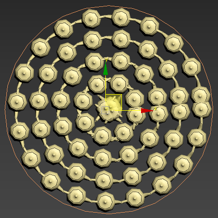

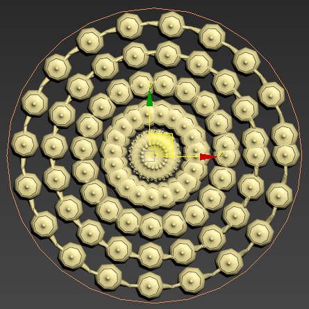

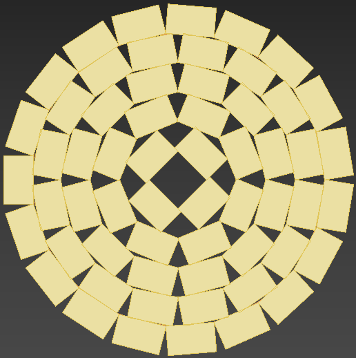

  10. As you can see, the number of teapots in every row is identical. This means that as they get closer to the centre they must overlap. There is a little-known mode in RailClone that allows the segment count of each row in a 2D array to be calculated independently. To enable it, go to the Generator's properties and change General > Y Mode to Free

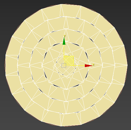

  11. You will see that the segments overlap at the end of the array. This is because the teapots don't fit exactly into the circumference. To fix this, change the Generator's Properties > Rules > Default mode to Adaptive. This will subtly scale the geometry to ensure whole segments fit in the available space.

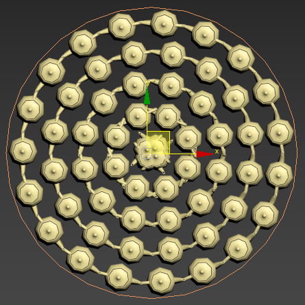

  12. To calculate adjacent segments, RailClone uses the object's bounding box. The side used for the calculation depends on the Alignment settings, and if we turn on Box display mode we can in this example that the outer edge is being used. This explains the overlap, if the outer edge is touching, the inner edges will overlap.
  13. To fix this we can change the Segment's alignment by adding a Transform node between the Segment and the Generator. Enable Alignment and change Y to Top.
    The segments are now aligned to the inner edge and no longer intersect.

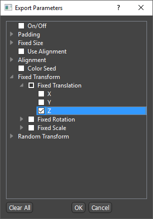

  1. First of all you need to export a parameter that you want to control with an expression. This is no different from exporting the Y Size of the array we looked at earlier in this tutorial. This time we will export the Fixed Z Translation from the Transform node.

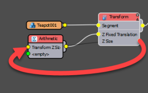

  7. Now we to multiply this by the distance we want each row to be offset. In order for segments to stack, this should be the height of the geometry. We could enter a value manually here, but then we'd need to change it if we swap or resize the segment. Instead it's better to extract the dimensions automatically. You can do this by right-clicking on any node and selecting Export Attribute. In this case we want to export the Z-Size from the Transform node.
  8. Wire this to the Arithmetic node's first input.
  9. To reference this value in the expression you just enter Input followed by the number of the input starting from 1 at the top. So in this case you would add * Input1 to the expression.

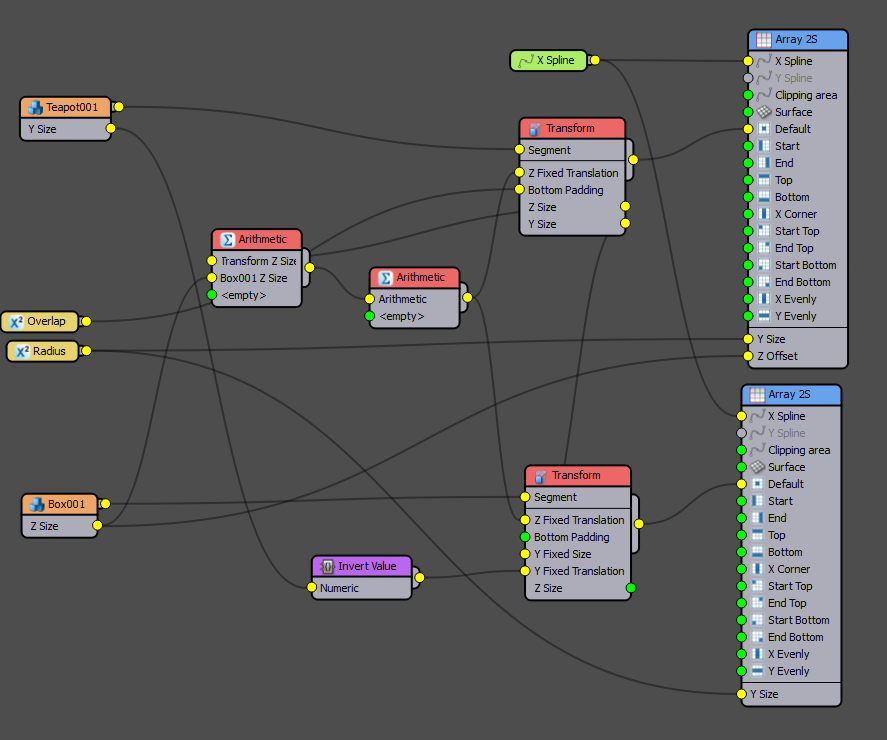

Adding shelves between rows.
As an option, you can also add shelves between rows. This would work well for objects like the tea pot or wine bottles that don't necessarily stack very safely! Here's how to do it:
  1. Select the Generator, Segment and Transform node and duplicate them using Copy and Paste. Disable and disconnect padding inputs. We don't need them for this part of the graph.
  2. In the copied Segment node, pick some geometry for a shelf. Make sure you enable Bend if you turned it off or the geometry won't deform around the spline.
  3. In order for the same number of shelves as there are objects, it should be the same size on the Y axis as the teapot. However we can tell RailClone what size to use for a segment without it actually affecting the geometry. In that way the shelf can be deeper than the teapot, but all of the calculations that determine spacing will assume that they are the same size. To achieve that, in the new Transform node, enable Fixed Size
  4. Uncheck Scale Segment. This will stop the geometry being affected by the new size.
  5. Export the Y Size Attribute from the Teapot's Transform node.
  6. Export the Fixed Size > Y Parameter from the shelf's Transform node and connect it to the Y Size Attribute exported in the previous step.
  7. Next, we'll align the outside of the shelf to the outside of the teapots. To do this, first change the Y Alignment for the shelf to Bottom. Now the outer edge of the shelf is aligned to the spline and all we need to do is move it back along the Y axis the depth of the teapot. This might seem like an odd way of doing things, but it allows us to have a shelf that is deeper the teapots with everything still aligned automatically.
  8. Right-click on the teapot segment and export the Y Size attribute. Note that this is not the same as the Y Size attribute exported from the transform node. The segment Y Size attribute is the width of the geometry. The Y Size attribute on the transform node includes the padding values that we have added or subtracted.
  9. Export the Y Fixed Translation property from the shelf's Transform node. Add an Invert Value macro (which makes a positive number negative or vice versa) then wire it to the Fixed Translation property. Connect the Segment's Y Size attribute to the Macro.
  10. Nearly there! All we need to do now is add the thickness of the shelf into the existing stepping expression. To do this, first export the Z Size attribute of the shelf.
  11. Wire a new Arithmetic node between the existing Arithmetic node and the teapot Transform's Z Size property. Leave the mode set to addition.
  12. Wire the shelf's Z Size property to the second input of the new Arithmetic node. The size between each row is now the sum of the height of the teapot and the shelf.
  13. Finally, to move the teapots on top of the shelves, Export the teapot generator's Z Offset and wire if to the shelf Segment's Z Size, and we're done!
