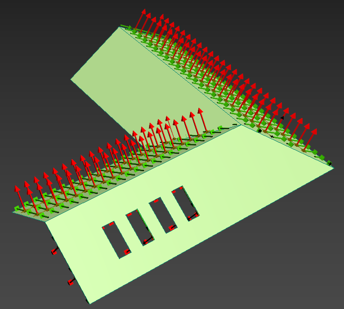

Principle 1 - using closed splines.
RailClone needs to know the size of each roof plane in order to build the array. Additionally, the roof planes are probably not perfect rectangles, so we need to cut the array to fit. Both these operations can be driven by a single closed spline object. These are easy to create either by drawing them manually or extracting them from base geometry. Here's how to do the latter:
  1. Convert your base geometry to an Editable Poly object if it isn't already. We're going to use a feature of the graphite modelling toolset which only works with this geometry type.
  2. Go into Polygon sub-object mode.
  3. Turn on Selection > By Angle and lower the threshold a bit. This will make it easier to select complete planar areas.
  4. Turn on Ignore Backfacing so that you don't accidentally pick polys from the other side of the object. With these options selected, pick a roof plane.
  5. For a selection like this that doesn't have any inside edges, hold down control and click on the Edge sub-object level to convert the polygon selection to edges. If the selection does has internal edges you can use the Graphite Modelling tools to select just the border. To do this go to Modify Selection and hold down Shift while clicking Outline.
  6. Go back to the Modify panel and click Create Shape from Selection. Change the Shape Type to Linear, and click OK. You now have a spline that's ready to use with RailClone.
  7. Repeat this for all the faces of the roof. When you're done, Attach  the splines together. One of the big improvements in RailClone 3 is that it's now possible to add tiles to the entire roof using just one RailClone object.

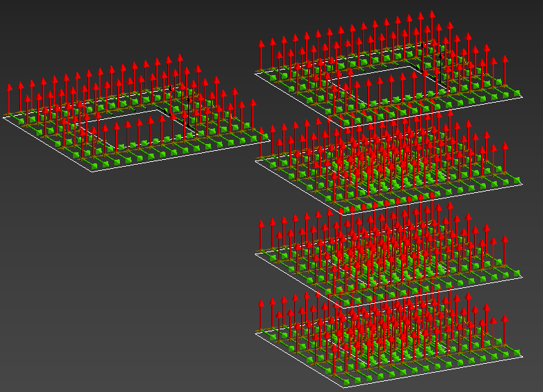

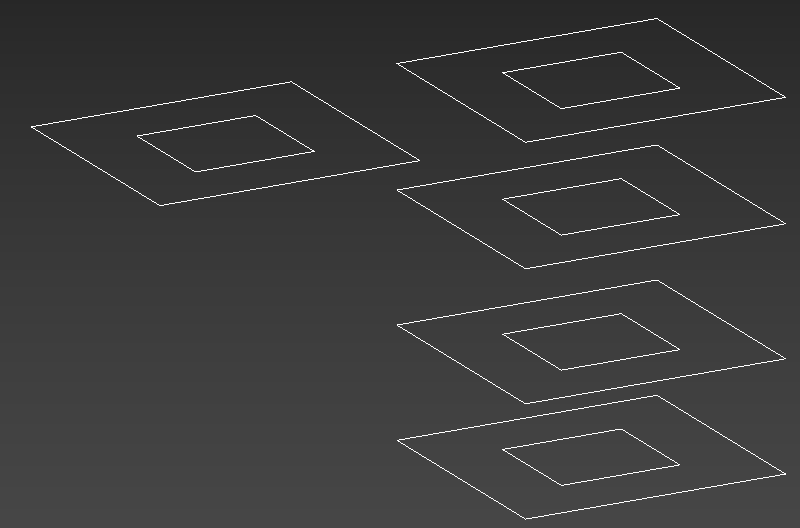

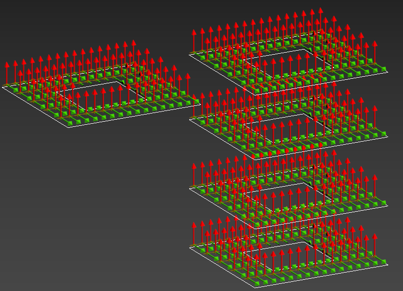

When Hierachy Checking mode is set to None each individual spline generates a unique array. Their position in relation to one another is completely ignored. Although that's not helpful in this case, it's a great mode for adding things like windows and doors to a large building where each spline should generate an individual array.

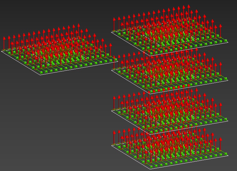

When Hierachy Checkingmode is set to Complete, RailClone will look for splines that are inside one another. It alternates between additive and subtractive operations from the outside in, so the first spline creates an array, a spline inside that clips the geometry, a spline inside that adds geometry back, and so on. As you can see this works well for the topmost splines, but where they are stacked it can't work out which splines belong to which plane. To resolve that we can give RailClone a helping hand using material IDs
To tell RailClone which splines belong together, just select them at the sub-object level and group them by assigning the same Material ID. This is particularly true also of facades where you will also often have splines that overlap if you look at them from the side views.
Once you've assigned your IDs, Hierachy Checking mode is set to By Material ID which uses a version of the complete hierachy mode but this time each group of splines identified with the same material ID is calculated independently, resolving any possible clashes.

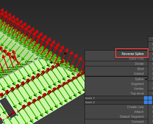

Principle 5- Spline Direction is important
An array is built from left to right, following the direction of the spline, consequently the vertex numbering will determine which way the array considers to be "up". For example, the vertex numbering of a flat spline seen from the top view can increase either clockwise or ant-clockwise depending on the spline direction.  When you create splines by extracting them from meshes, the chances are you'll get a mixture of clockwise and anticlockwise splines. To fix this you'll need to edit them. To check the roof spline we created earlier we can apply our arrow style and immediately we can see that a couple of the roof planes are facing the wrong way.
To fix this, select the offending sub-splines and click Reverse from the Geometry rollout or from the Right-Click menu.

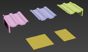

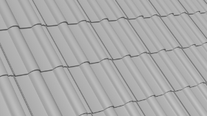

Adding the tiles
Now that we've got the basics down, we can finish this style by adding the tiles. Let's switch the spline back to the basic square while we create this so we can display the full geometry while keeping updates fast. Depending on the type of roof you're creating, you'll need a couple of different segments. Usually that's just a single tile for the default input, and optionally some verges to go on the left and right of the array. For slate roofs you may need a tile that is one and half times the width of the default tile in order to create alternately offset rows.
To create the roof using these segments:
  1. Go back to the style editor. Select the segment wired to the Default input and pick the standard tile (not an end)from the scene.
  2. Set the Generator's Default Segment Mode to Adaptive. This will prevent the final tile from being sliced and subtly scale all the others to fit.
  3. The tiles are butted up against one another, add an overlap by decreasing the Segment's Top Padding value.
  4. The tile geometry's pivot should be set to the bottom of the tile for all of the segments. This will allows us to ignore the different height of the verges.
  5. To use this pivot in RailClone, select the segment and change Alignment > Z to Pivot.
  6. Now go to the Transform tab and adjust the Y Rotation until the tiles sit on top of one another correctly.
  7. Close up the gap between the tiles by adjusting the Segment's Right Padding. Now we can add verges. If you don't need verges then you're done!
  8. Clone the existing segment twice. Wire one to the Left input and one to the Right input.
  9. Pick geometry for the two sides. The Padding for the left segment is probably already correct, but adjust it if not. For the Right segment you'll need to set the Right Padding back to zero, and adjust the Left Padding instead if necessary to get the correct overlap.
  10. Finally, if the verges are a lot larger than the default tiles on the Z axis, it may cause them to get slightly out of alignment. This happens because the bounding box changes as they're rotated. To fix this, just adjust the Y Translation property of the Default segment.

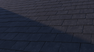

Creating materials

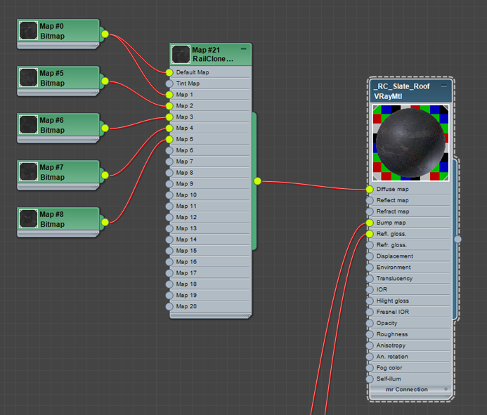

RailClone colour can be used to add another level of randomisation. Let's take a look at our slate example. We have 5 slate maps that we'd like to randomise. In previous versions of RailClone you'd have needed to use the Material node to randomise material IDs to achieve this. In RailClone 3 however you can just attach your images to a RailClone Color map. Each individual segment will be randomly assigned one of the textures.

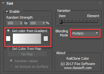

For more variation you can use RailClone Colors Tint options. In this example I've used a simple grayscale gradient and set the mode to Multiply. This will randomly adjust the lightness of each tile.
Below you can see the same roof before and after RailClone Colour was applied.
Creating Roofs with RailClone-image2017-11-10_18-53-49.pngCreating Roofs with RailClone-image2017-11-10_18-53-58.png

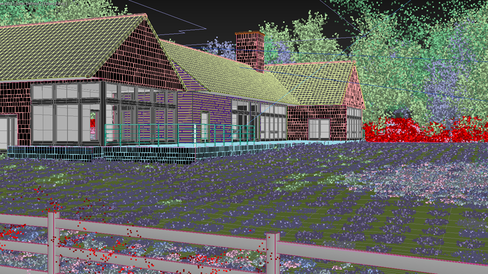

Putting it into Practice
Creating the Splines for the roof
Open the file called rc_roof_tutorial_start.max. This scene contains a small building in a simple environment. We need to add some tiles to this roof.
In this example the roof is bit bigger, so to speed things up a bit we can use a simple script to extract the splines. It's available in the downloads for this tutorial, and essentially it's automating the procedures we saw earlier by converting a poly selection to an edge selection, creating a spline from that, and grouping them using a material ID. To use it.
  1.  Run the script by going to Scripting > Run Script and selecting RC_CreateBoundarySplines.ms.
  2. Enter a name for the new spline and hit return.
  3. Pick your first roof plane and click on the New Boundary Spline button while holding down shift
  4. Do the same thing for all the other roof planes. Holding down shift is the equivalent of using the Graphite tools that we looked at earlier. If you choose not to hold down shift you will create one closed spline per polygon.
  5. Once that's done we have the splines we need, but still need to check to see if any need to be reversed.
  6. Pick the object name _rc_arrow and apply it to the new spline. This already contains a simple arrow RailClone style similar to the one we saw in the previous example. I find it just makes things a bit easier to visualise.
  7. There are quite a few that need reversing, so select them and use Max's Reverse Spline tool to fix the issue.
  8. Now we can go to the Style rollout and click on the Library button. Navigate to the Exterior > Roofing > Tileslibrary and pick a roof style.
  9. Click Import Selected and the roof style is loaded and replaces the arrows. That's the tiles done. Easy wasn't it?
  10. If necessary you might want to just adjust the splines a little bit to make sure that the verges overhang the end of the roof.
  11. You can also choose which material to use. The built in styles have nearly 30 to choose from. In the renders for this scene I've chosen use material 18.
