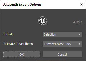

  3. In the Datasmith Export options. Make sure that Include is set to Selection
    Datasmith Export Options

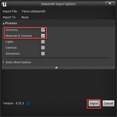

  8. Next, the import options will open. Change the  settings as desired and then click Import
    Datasmith Import Options

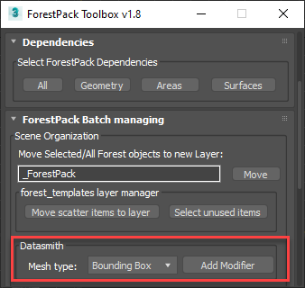

Locating source objects and adding Datasmith modifiers can be a somewhat tedious task if you have a lot of Forest Objects in the scene. So we have written a script to automate the process. It’s a part of the ForestToolbox, an ever-evolving set of handy functions that registered users can download from our forum. To use this:
  1. Select one or more Forest Objects.
  2. In the Datasmith section, change the mode to Bounding Box and click Add Modifier
    Forest Toolbox UI

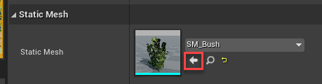

  1. Select the Hierarchical Static Mesh actor and in the Details panel, select the Hierarchical Static Mesh component for the object you wish to replace.
  2. Select an object you wish to substitute from the Content Browser
  3. Click the Use Selected Asset in Content Browser button to assign the new object to the Hierarchical Static Mesh component. All instances will be updated.
    Static Mesh

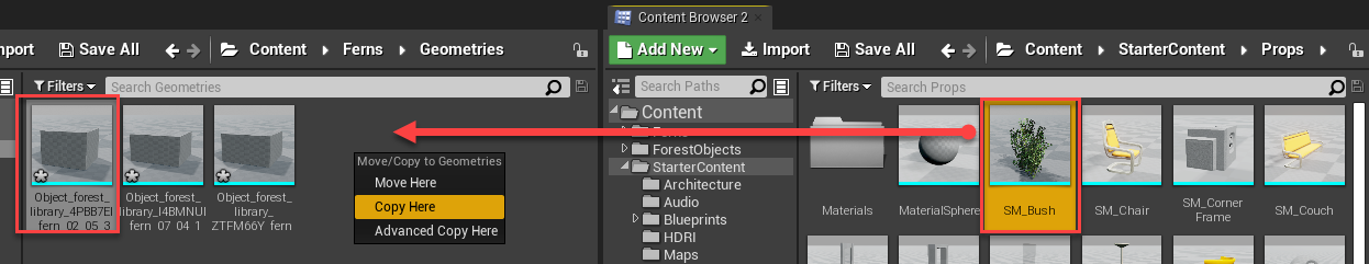

The Hierarchical Static Mesh Component lists all the instances in the UI. Because of this, scatters that contain too many objects can cause slow-down or freezing as the UI attempts to list all the items. To swap items like this, you can use a different approach that doesn't involve you needing to open the UI for the component. Here's how:
  1. In the Content Browser, find the folder containing the placeholder assets used in the scatter.
  2. Open a second Content Browser and locate the object you’d like to substitute
  3. Drag the new plant into the same folder as the placeholder. Makes sure you choose Copy. This is so that you don’t accidentally end up deleting items from the content browser that you might need later.
    Replace Bounding Boxes

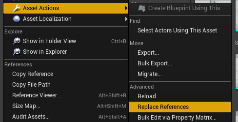

  4. Now select the new object and the placeholder object.

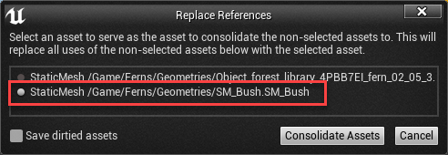

  5. Right Click and select Asset Actions > Replace References
    Replace References
  6. A dialog opens. From the list you need to select the asset you wish to keep. The unselected assets will be removed and the references swapped to the selected asset.
    Replace references Options
  7. Click Consolidate Assets
  8. The scatter will update in the scene.
  9. Using this technique you can easily swap any geometry imported from Forest Pack.
