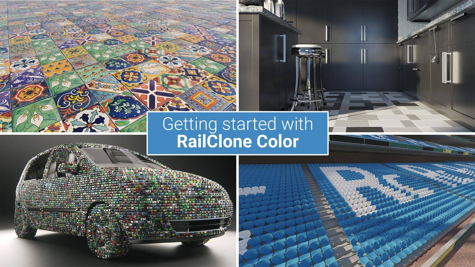

Introduction to RailClone Colour
In the following four videos we introduce users to the core features of RailClone color.
