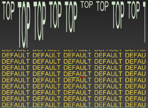

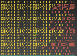

    This is because the A2S generator is essentially a stack of 1-dimensional arrays, each row is calculated independently and the height of each row is determined by its largest segment. What this does mean though, is that a segment placed in the left or right inputs can be used to clip the default segments a random distance from the edge of the array.

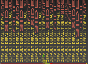

    Armed with this understanding it's a simple case to rotate the array to move the left and right sides to the front and back, simply by swapping the X and Y Splines. (You may need to reverse the Y Spline to change the direction of the array).
    We now have the randomised side segment at the back of the shelf, where it can be used to control the number of objects that are placed in depth.

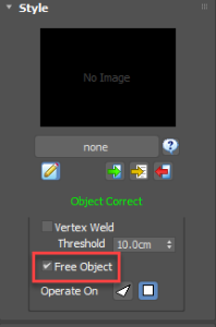

  9. We never want this geometry to be cut or bent to follow the path, so for each segment node, go to Properties > Deform and turn off Slice and Deform.

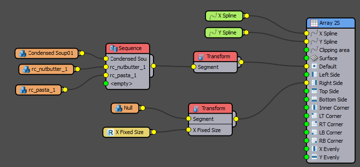

  10. Wire the 3 segments to a new Sequence operator. Wire this to the generator's Default input.
  11. Because we've rotated the array, we need to change the sequence operator to work on the Y axis. To do this change Increment On to Y.

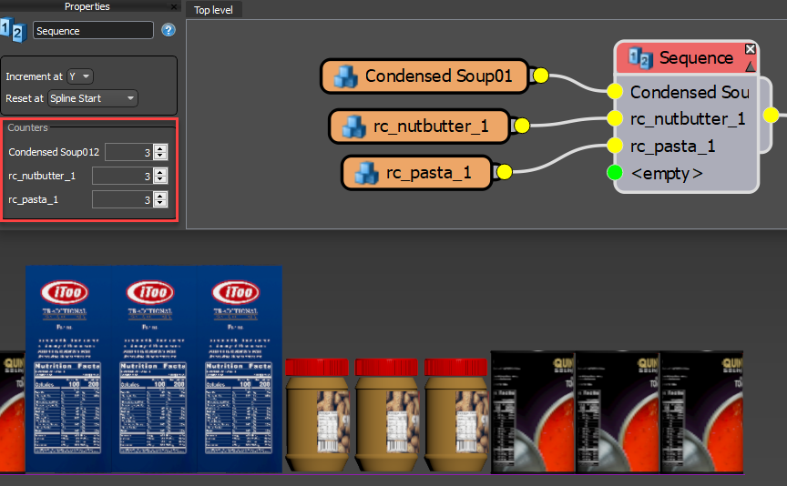

  12. You can now control how many times a product is repeated using the Sequence operator's Counter parameters. This allows you to create the groups of products we mentioned in the introduction.

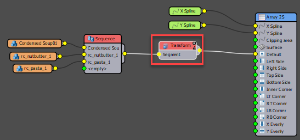

  13. To control and randomise the rotation of the products, we can add a new Transform operator between the Sequence operator and the Generator.
  14. Go to the Transform operator's Properties and enable Random Rotation. Enter minimum and maximum values to get the desired look. In this case, to turn the items towards the front of the shelf and get some random rotation I used a Minimum value of -80% and a Maximum value of 100%.
  15. Finally, to randomise the number of objects distributed in depth, create a new Transform operator and wire it to the Right input. Create a new Segment node and wire it to the Transform operator. We won't be using any geometry for this segment, it's only to add a space.
  16. Right-click on the Transform operator, select Export Parameters and choose X Size then click OK. Go to the node's Properties and make sure Fixed Size is enabled.
  17. Finally, add a new Random Number node and wire it to the newly exported X Size property. Change the Type to Scene Units and set the minimum and maximum values to get the desired effect. Finally change Generate On to segment so that each row gets a new random value.
That's the style completed. The final graph is shown below:

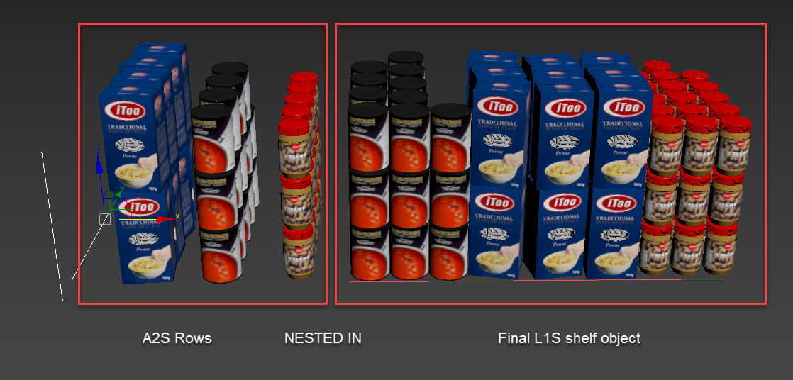

Nesting segments
The previous technique works really well if you only need a 2-dimensional array of objects, but what if you also need products to be stacked on top of one another? There isn't a  3-dimensional array in RailClone so we have to resort to some tricks. The first is using nested arrays, which involves using one RailClone object as a segment inside a second.

  11. To distribute these along the shelf's length next create a new RailClone object. Open the Style Editor and add an L1S Generator
  12. Create a Segment node for each of the RailClone objects we just created and pick them from the scene. Disable Bend and Slice.
  13. Create a new Sequence operator and wire it to the Default input. Connect all the  segments to the Sequence operator's inputs and set the number of desired repetitions using the Counter parameters
  14. Finally, the default behaviour is to centre segments to the spline on the Y Axis. We want to align our products to the front of the shelf, so go the segment's Alignment options and change Y Alignment to Bottom.
You will now have a 3-dimensional array that is controlled by 3 splines. The height and depth splines control RailClone objects that are nested inside a final style with a third spline to control the shelf's length.
