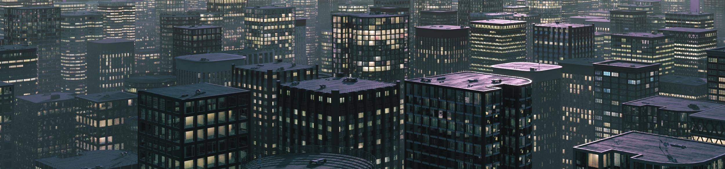

Using ParametricLibrary Background Buildings assets
How to use the individual building presets including in our ParametricLibrary Background Buildings collections.
