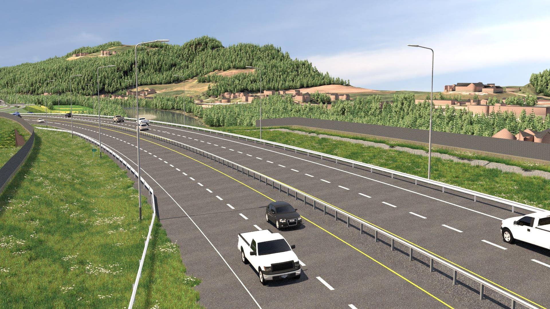

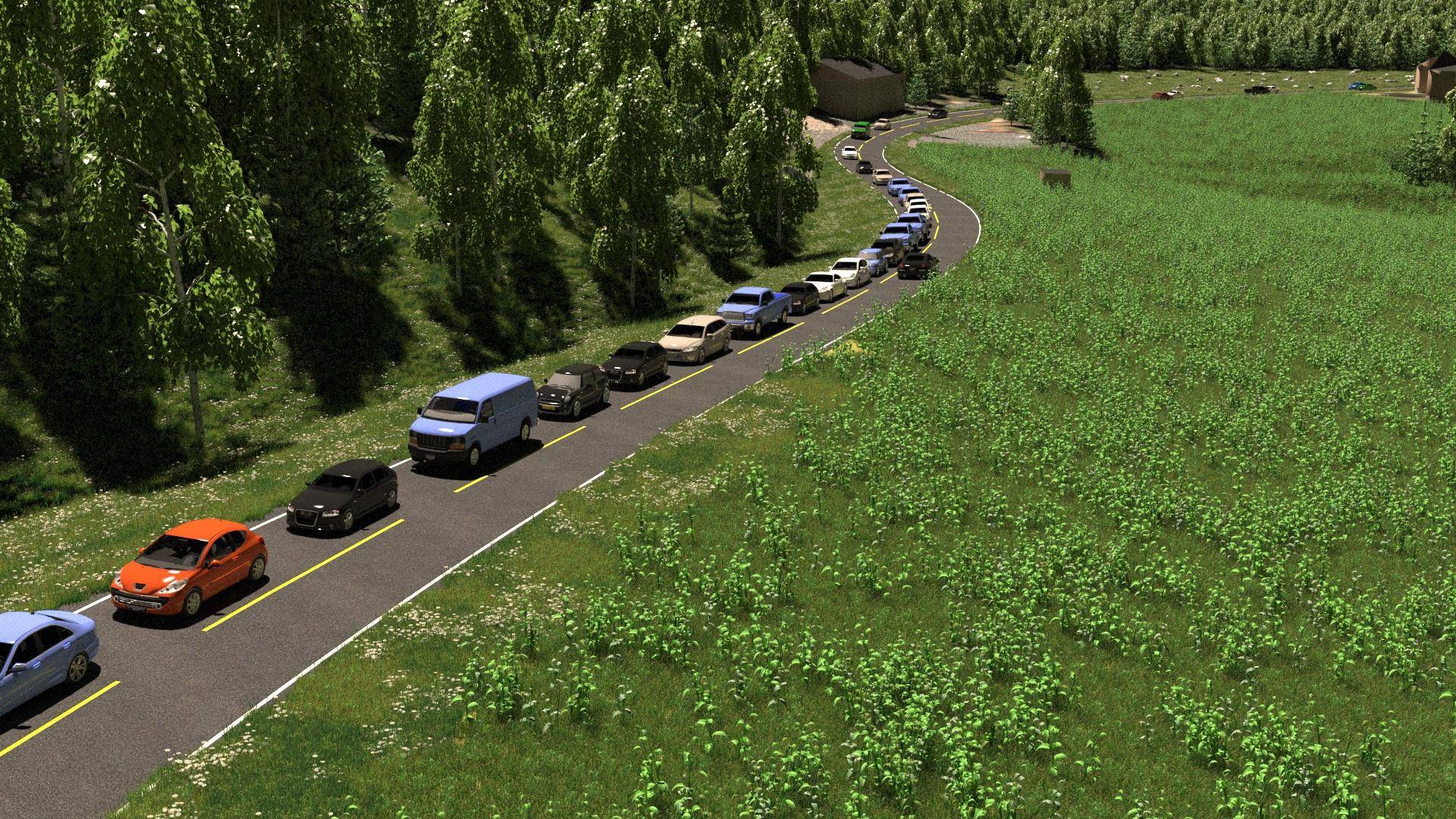

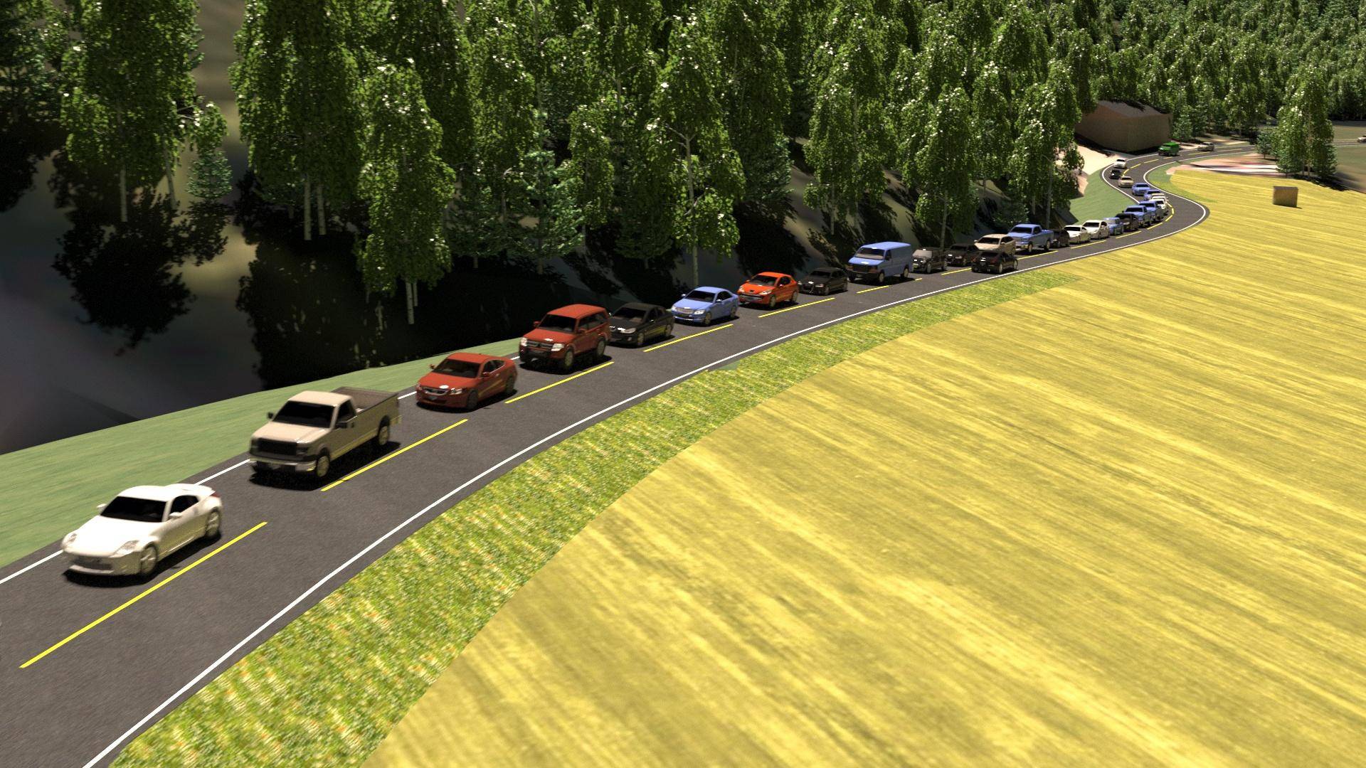

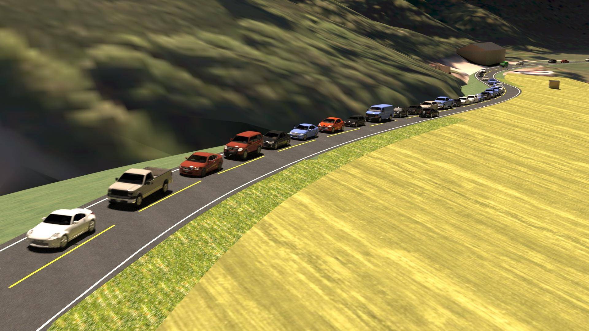

In my work, I divided the use of vegetation into three levels. One without the use of FP, just orthogonal photography and separate low-res textures for fields and paths (gravel) etc. At “level 2”, I used trees only, but over large areas. At “level 3”, I use vegetation, as well as stones and gravel, on all surfaces in the terrain model.
Figure 1 – Rendering without Forest Pack Pro, “level 1”
Figure 2– Rendering with trees only, “level 2”
Figure 3– Rendering with full vegetation, “level 3”
For flyover shots, I found that using just trees gave a good balance between time efficiency and visual result. I used V-Ray RT as a production render and at 1920x1080, I was pleased with the number of render passes completed in about 3 minutes per frame. For close-ups, the use of full vegetation on all surfaces gives a much more realistic presentation, but with my hardware I was just able to get a decent result after 15-min of rendering. The rendering was done with an NVidia GTX 970.

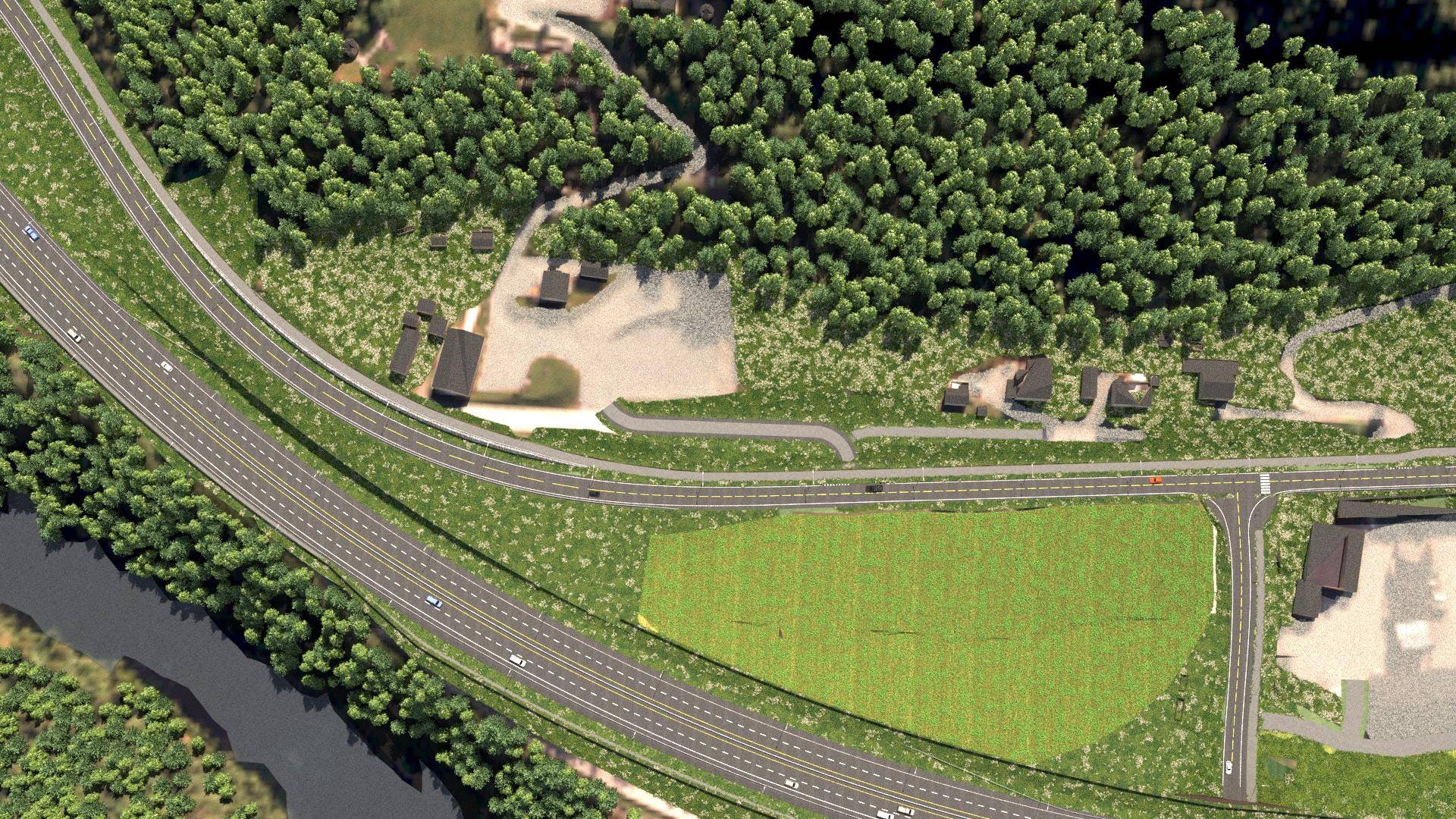

For me Forest Pack Pro gives my models and presentation a much more professional look. Since the focus is to show the traffic situation for existing and future roads, at first glance covering the terrain with vegetation might not seem to be worth it. What is so good about Forest Pack though, is the ability to choose the level of detail for necessary for the task at hand. Using just trees is fast in both placement and rendering and can be used even in small projects, for example, on just one intersection. Introducing more detail is for me a thing for the future. However, as both hardware, FP and V-Ray is in constant development, it seems like the render times, even for complex large scenes, soon will be low enough for the use in my projects.
For engineers who would like a more realistic and professional presentation of traffic simulation, I would certainly recommend taking a look at Forest Pack Pro. The step up in visual quality, from just using a simple terrain surface, is huge. In addition, with the ability to do it in just a short amount of time, I do not see why you should not.
