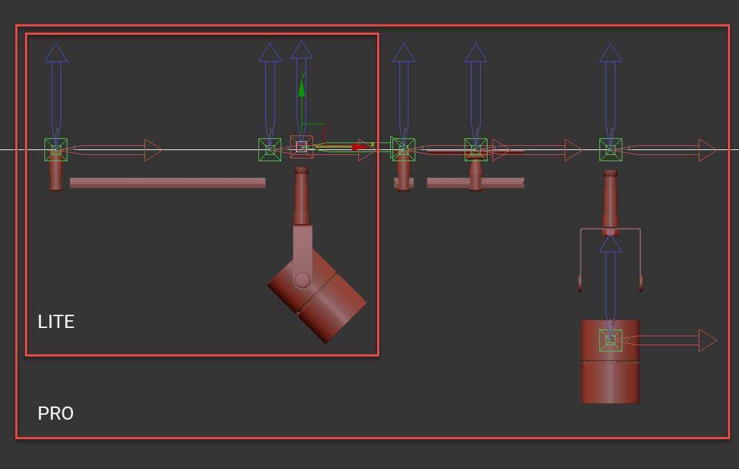

To get started you’ll need some base geometry. This isn’t a modelling tutorial so we won’t explain that process, but it’s helpful to understand how many pieces you should split a model like this into, and why.
Where possible, think about dividing any design into smaller, more manageable sections. In this example, I planned the rail section and the light itself separately. The rail could consist of as few as two pieces: one bracket piece and the metallic strip. To make sure that this all aligns correctly once added to RailClone, the pivots for both pieces should be aligned at ceiling level. If you are using RailClone Pro you could optionally use two additional pieces for the start and the end since you will be able to use more segments
For the light fitting, in RailClone Lite you will use a single object. This will allow you to randomise the rotation on the Z-axis, but the other angles are fixed. If you are using RailClone Pro you can split the light into two parts: A top section that connects to the rail and can rotate on the Z-axis, and a separate light so it can be rotated on the other axis. The first of these segments has had its pivot adjusted so it’s connected to the rail. The light itself has its pivot aligned to the position we would like it to rotate around.

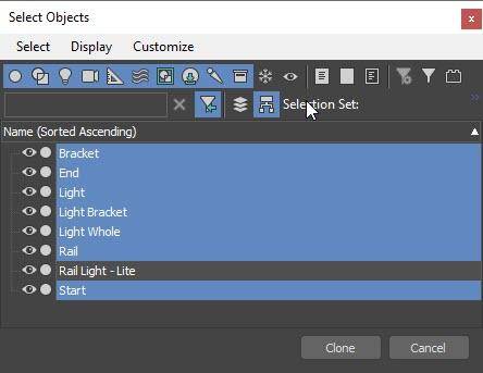

- Now let’s import the geometry. Create a single Segment node. Right-click on it and choose Clone Multiple. Select the objects and click Clone. This is a nice fast way to import a lot of things quickly.

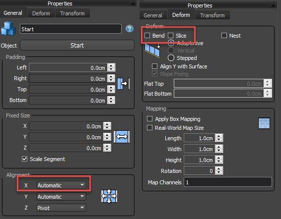

- Wire the Bracket Segment to the Start, End, and Evenly inputs. Change the Alignment > Z option to Pivot so it sits below the spline. Turn off Bend and Slice. The only segment that should bend in this style is the rail itself

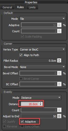

- To adjust the spacing of these you use the Rules> Evenly > Distance parameter. To ensure all the spaces are the same size, turn on Adaptive (without this the first and last spaces are averaged and the remaining ones are exactly the value in the Distance property).

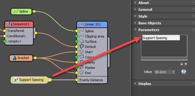

- To make this style easier for people to use, right-click on the Generator and export Evenly Distance.
Attach a new Numeric node and change the type to Scene Units. This property can now be controlled from the Modify panel. This is ideal when creating styles that you want other artists to use, or if you simply don’t want to open the graph every time you need to make a small change. Nearly any parameter can be exported in this way.![Numeric]()

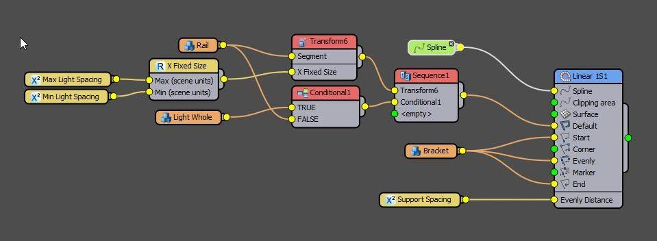

- Select the Light Whole segment, disable Bend and Slice and change X,Y and Z Alignment to Pivot. To add this we will also need to use the Default input, since we want it between the Evenly segments, so let’s create an alternating pattern of Rail then Light using a Sequence operator. Wire it to the Default input and wire the Rail segment to its first input. Next wire the Light segment to the second input. Change the Sequence operator’s mode so that it resets after each Evenly segment by selecting Reset at Spline Section. Finally, set the Fixed size to a small value and disable Scale Segment to force the rail to continue to the centre of the light.
![Sequence settings]()
- So far so good, but the spacing is too regular. To fix this we can randomise the length of the Rail segment. Add a Transform operator between the Rail segment and the Sequence operator. Turn on Fixed Size, right-click on the Transform node and export X Fixed Size.
- Wire a Random number node to this newly exported input, change the mode to Scene Units and adjust the Minimum and Maximum value. Change Generate On to Segment
![Generate On]()
- These are two other settings we might want to change regularly, so we can expose them in the Modify panel just like we did for the Evenly Distance. Right-click on the Transform node and Export Min and Max Scene Units.
- Create two new Number nodes and wire one to each of the new inputs. Don’t forget to rename them so it’s clear what they do.
- So far, so good, but there are some occasions when you might get overlapping segments. To fix that, wire a Conditional node after the Light segment and wire the Light to the True input. Wire the Rail to the second input. You can now change the Conditional node’s settings so that it only returns True (the light) if it is less than 95% of the way along the current spline section.
![Conditional-settings]()
- Finally, select the Light segment and enable Transform>Random>Rotation. For the Z-Axis enter -180 Min and 180 Max.

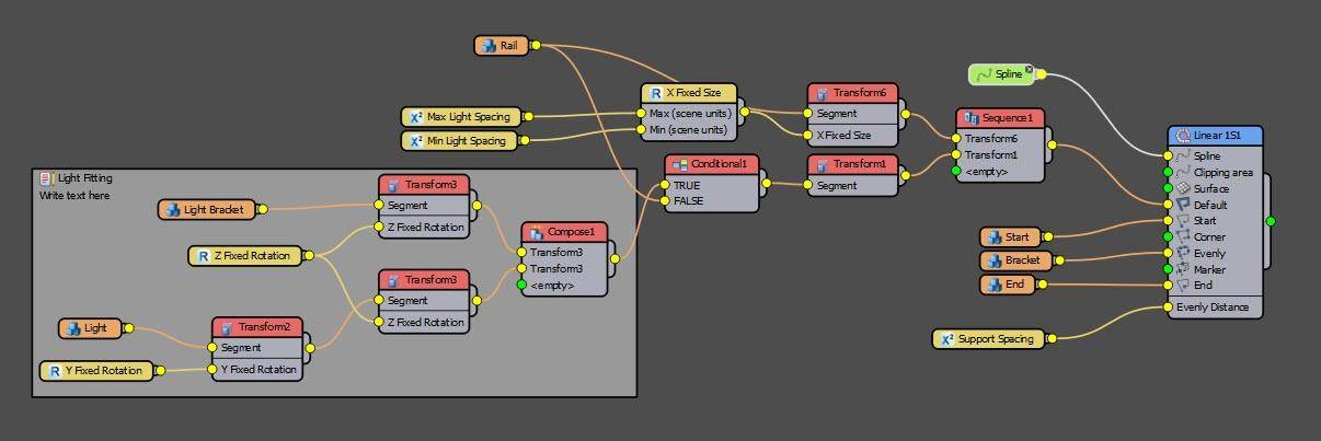

- Wire a Compose operator to the True input of the Conditional operator. Change its mode to Grouped. This mode will align the segments based on their pivot points rather than bounding boxes.
- Wire the Light Bracket and Light segments to the Compose operator.
- Now let’s add some randomisation. Wire a Transform operator after the Light Bracket segment. Right-click and expose Z Fixed Rotation.
- Attach a Randomnumber node, set its Type to Float and set Min -180 and Max to 180.Change Generate On to Segment
- Duplicate the Transform operator and attach it after the Light segment. Both will now be rotating together but the Light segment is in the wrong place. Move it into position by changing the Fixed Z Translation value.
- Create another Transform node and wire it immediately after the Light segment and before the existing Transform operator. You can now use the Fixed Y Rotation property to angle the lights.
- Let's randomise this value by exporting it and attaching a Random number node. Set the type to Float and use a Min value of -90 and a Max value of 90. Set Generate On to Segment
- The way to think about this sequence of Transform operators in RailClone 4 is to imagine processing them backwards. First, we randomise the rotation on the Z-axis, afterwards we randomise rotation on the Y. If this order was reversed you wouldn’t get the desired results.
![Transform order]()
- Finally, we need to fix the alignment and the gap in the rails. To do that, wire a new Transform node after the Compose operator. Set the Alignment for all axes to Pivot and change the Fixed Size to a very small number - just like we did earlier in this tutorial.
