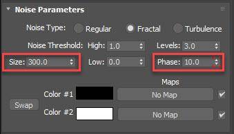

Move the playbar to the end of the animation and enable Auto-Key. Change the default curve type to Linear so that you don’t create an ease-in or ease-out effect for the wind. Now increase the Noise map's Phase value. The larger the number, the faster the grass will animate. For a 400-frame animation, we used a Phase value of 10.
Press play and the grass will start animating. Now we can set the Size property. Larger values will give the appearance of gusts moving across the landscape, smaller values will make plants look as though they are all moving chaotically which is less desirable. In our scene we used a value of 300, but feel free to experiment with this property as well as the noise type which will give you several interesting effects.

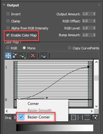

Finally, you can control ease-in and ease-out for the wind effect by enabling the Colour Map options. By changing the Start and End points to Bezier Corners you can parametrically control the acceleration and deceleration of the bending grass.
