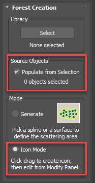

  1. Select the objects in the scene that you want to place with Forest Pack
  2. Go to the iToo Software group in the Create Panel and click to open the Forest Pack create options.
    Create Options
  3. Click the Populate from Selection option. This will automatically add the selected objects to the FP items list and it saves you from having to do it manually later. Alternatively, you could always select objects from the Library which will take priority.
  4. Change to Icon mode, and click and drag somewhere in the scene to create a Forest Pack object.
  5. Go to the Modify panel, and open the Items Editor rollout. Change the mode to Custom Edit and click on the Tree button  to enter the sub-object selection level. When this is active you can add new items or move, rotate and scale existing ones.
  6. To add an item, click on Add Items > Add and click in the scene to place an object. Easy as that!
