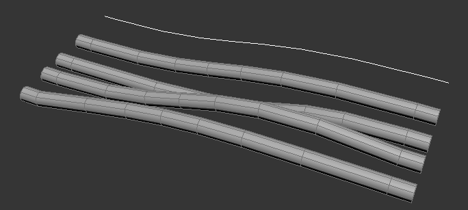

As always when working with RailClone, the aim is to manually model as little as possible and for this example we could get away with only two segments, one for the horizontal weft, and another for the vertical warp. For the latter though in order to create a little more natural variation we will use 4 variations. This are very simple, created using just a spline and a Sweep modifier
For the vertical sections (warps), a simple straight spline is enough as long as there are enough edge loops so that it can be deformed to follow a curve if needed.
For different types of construction material you can easily use a different cross section with the sweep modifier, but even then this geometry is very easy to create. The only other thing to note is that the pivot on the Z axis for all the segments is positioned so that segments align correctly, and that they will tile along the X axis when mirrored and repeated.

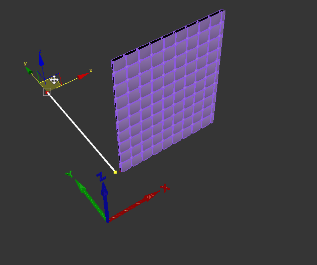

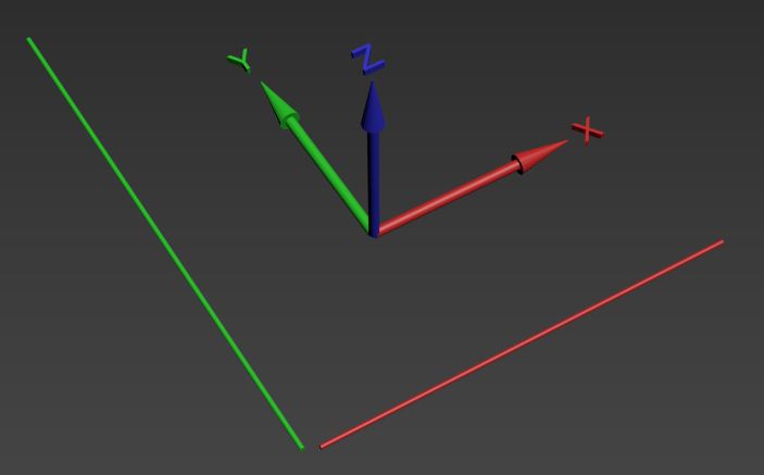

On to the splines, as we're creating a 2 dimensional array, and because the roof  will be curved on the Y axis, we need two splines. The easiest way to create splines for the A2S array is to use the top or perspective viewport. In this demo we'll create them as follows:
  • Spline 1 should be straight along the X axis. This will be used to define the length of the array.
  • Spline 2 should be straight along the Y axis. This will be used to define the height of the array.

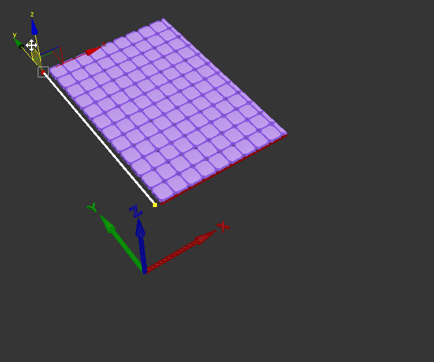

The X Spline is pretty easy to understand as it defines the path of the array. The Y spline defines the shape and orientation of the array on the Y axis, and has the potential to cause more confusion. In RailClone 3 we've made this a little easier to understand - the length and path of the array on the Y axis is defined by the shape of the array as defined on the Y/Z plane. If you rotate the spline sub-object around the X axis, you will see the arrays orientation updates accordingly.

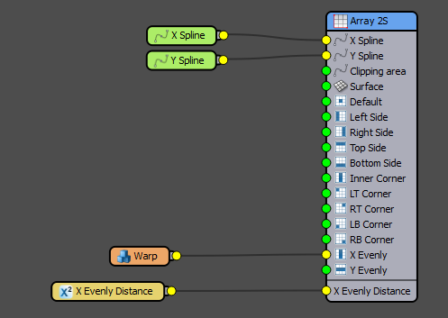

  1. Create a new A2S Generator. Name it Warp.
  2. Create a new Spline node and wire it to the Generator's X Spline input. Go to the Properties panel, click the spline select button and pick the X Spline we just created from the scene.
  3. Create a second Spline node and wire it to the Generator's Y Spline input. For this one we'll pick the Y Spline.
  4. Create a new Segment node. Go to Properties and pick the warp object from the scene.
  5. Wire the Segment node to the X Evenly input. This will add vertical segments at regularly spaced intervals.
  6. Change the Segment's Z Alignment to Center
  7. The distance between warps is controlled by the Properties > Rules > X Evenly >  Distance value. To make these easier to change later we can make this value accessible from the Modify panel. To do that, right-click on the generator and go to Export Parameters. Select X Evenly > X Evenly Distance and a new parameter input will appear at the bottom of the Generator node.
  8. Create a new Numeric node. Wire it the X Evenly Distance input and rename the node Warp Distance.If you look at the Properties rollout in the Modify panel you will see that this parameter is now accessible and can be edited without needing to open the style editor. Enter a value of 10cm for now.
Below is the finished graph for the warp elements. So far so good!

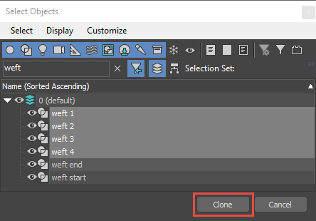

  6. In this scene there are 4 weft objects that we'd like to shuffle. Instead of adding each one manually,  right-click on the Segment and click Clone Multiple. An object picker window opens allowing you to select multiple items. Select weft 1 to 4 and click Clone. All the segments will  inherit the same settings.

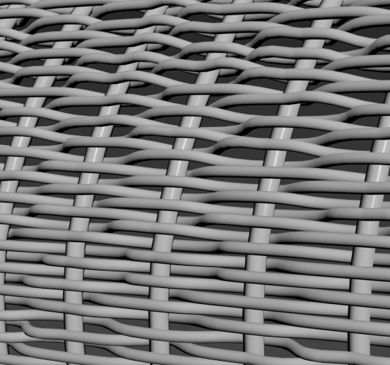

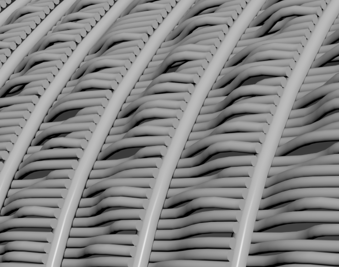

  9. At the moment we're getting a stepping effect as shown below

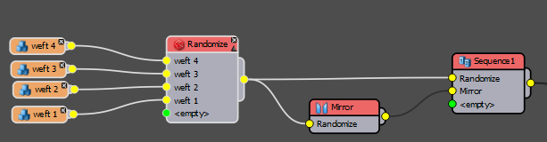

    To resolve this we need to create a version of the segments mirrored along the X axis, and then alternate between mirrored and normal versions. To do this create a new Mirror node, and wire the Randomize node to its input.
  10. Wire the Mirror node to the Sequence node's second input, as shown below.

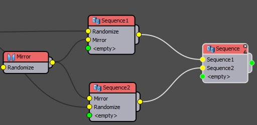

  11. If you change the order of the inputs in the Sequence node you'll notice that the under/over pattern can be offset. This is important because we need to alternate between over and under on the Y axis as well which can be achieved by alternating between two sequence operators, one of which has had the order of its inputs swapped. To do this, clone a the sequence operator and swap the inputs. Create another new Sequence operator and wire the two existing sequence nodes to its inputs.

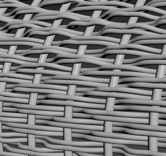

  12. Change the Increment On value for the new sequence operator to Y. Wire it to the Default input. You have no created a repeating alternating pattern on the X and the Y axis!
