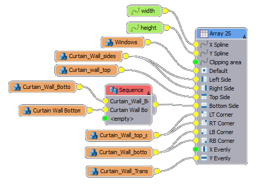

- To create a new Style go to the modify panel and find the Style rollout. Click on the Open Style Editor button (![Create a curtain wall building-rc_button_editstyle.png]() ) The image below illustrates the node tree we are going to create. ) The image below illustrates the node tree we are going to create.![Create a curtain wall building-rc_cw_node_tree.png]()
- In the Style Editor create a new Array 2S Generator (![Create a curtain wall building-btn_array_2s.png]() ) by dragging its icon from the Items List to the Construction view ) by dragging its icon from the Items List to the Construction view
- In this example we are going to use 2 splines to determine the height and width. Drag two new Spline objects (![Create a curtain wall building-btn_Spline.png]() ) into the Construction view. ) into the Construction view.
- Rename the Spline nodes from the properties panel on the right of the Style Editor. Name one "Width" and the other "Height".
	![Create a curtain wall building-cw_5.png]()
- Connect the "Width" spline node to the X Spline input and connect the "Height" to the Y Spline input of the A2S Generator node.
- The spline will now be visible from the Base Objects rollout in the Modify Panel. To pick a spline from the scene, click on the input name from the Base Objects list, click the Pick Spline button, then simply pick a spline from the scene. In this example, Assign the "Baseline" spline to "Width" and "Wall_Height" to "Height".
	![Create a curtain wall building-cw_7.png]() To add default geometryDefault geometry displays in the event that another input slot is not being used. In this example we'll use this slot to add the window panes to the style first.
- Drag a new Segment object (![Create a curtain wall building-btn_segment.png]() ) from the Items List to the Construction view and connect it to the Default input slot of the A2S Generator ) from the Items List to the Construction view and connect it to the Default input slot of the A2S Generator

- Add a new Segment node (![Create a curtain wall building-btn_segment.png]() ) to the Construction View and choose "Curtain_Wall_Top" from the scene. Connect this to the Top Side input of the A2S Generator ) to the Construction View and choose "Curtain_Wall_Top" from the scene. Connect this to the Top Side input of the A2S Generator

- Create a new Segment node, pick "Curtain_wall_bottom" from the scene, and connect it to the Bottom input slot.
- To line up the segment with the floor level we need to move it down. Since we want the adjacent geometry to move as well use padding instead of transform. Go to Properties>Padding>Bottom and set it to -130cm
- There are two bottom segments in the scene, one with lights and one without. To create a pattern whereby we get a light every 6th segment we can use a Sequence node.
- Drag a new Sequence node (![Create a curtain wall building-btn_sequnce.png]() ) into the Construction View and connect the Bottom node we just created to it. ) into the Construction View and connect the Bottom node we just created to it.
- Duplicate the segment node by right clicking and selecting Copy. Right click anywhere and select paste. In the properties panel, change the new Segments geometry to "Curtain Wall Bottom 2" by picking from the scene. Wire the new segment to the second slot in the Sequence node. Now wire the node into the Bottom input Slot of the A2S generator. This will create an alternating pattern between these to items.

- Create a new Segment and pick "Curtain wall transom" from the scene. Wire this to the Y-Evenly slot of the generator.

- Create a new Segment and pick "Curtain_wall_sides" from the scene. Connect this to the Left Side and Right Side inputs
- Go to General>Alignment>Z and set it to Pivot to correctly align the segment
- Add new Segment and pick "curtain_wall_bottom_sides" from scene, set the Bottom Padding to -130cm and ensure the Z Alignment is set to Pivot.
- Wire this to the Bottom Right and Bottom Left input slots.
- Create another new segment and select "Curtain_wall_top_sides" from the scene and wire this to the LT and RT input slots. Adjust the Y Fixed Transform settings to -21.6cm to close up the gap caused by moving the top section down in the step earlier.
