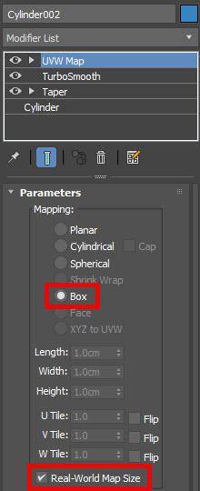

Before you proceed, it's crucial to check the object's mapping coordinates. If your geometry is based on a primitive, enable 'Generate Mapping Coordinates' and 'Real World Map Size'. However, if you've modified the object, add a UV modifier and then activate box mapping, setting it to real-world map size. These steps ensure that your objects are compatible with the Forest Pack preset we’ll be using.

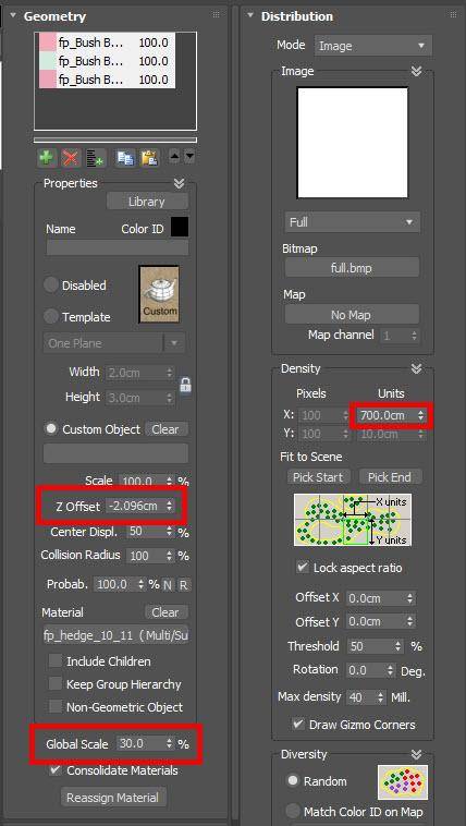

To do so, go to the 'Geometry Rollout' and scale down the geometry to roughly 30% of its original size using the 'Global Scale' settings. However, this will make the density of the foliage too sparse, so you'll need to adjust that next. Navigate to the 'Distribution Rollout' and decrease the density setting to approximately 700 centimetres. Finally, to perfect your design, you might want to adjust the Z-offset to make sure the branches are placed well inside the object.
