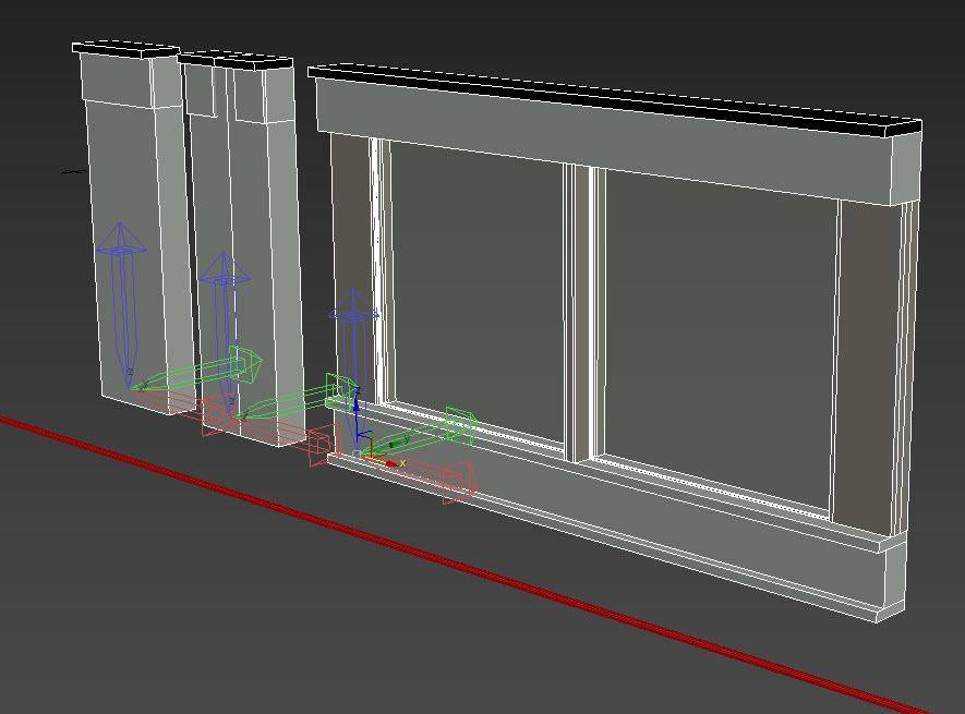

Source Geometry
Before we open RailClone, let’s take a quick look at the source geometry we’re going to use.
When creating the meshes for a RailClone style. it's important to think in terms of how they will fit together like pieces of a jigsaw. In an L1S array, the axes of the source geometry are oriented so that the X-Axis follows the path of the spline, the Y-Axis runs perpendicular to the spline, and the Z-Axis is vertical, matching the RailClone object's local orientation.
The source geometry
In order for geometry to be correctly aligned in the array, it may occasionally be necessary to adjust the orientation of the local axis. To do this:
  1. Select the Geometry object.
  2. Go to 3DS Max's Hierarchy Panel.
  3. Click Affect Pivot Only.
  4. Rotate the gizmo to the correct orientation.
  5. Alternatively, you can just rotate the geometry to align to the world’s coordinate system and then reset the XForm.
As well as orientation, another consideration is the position of pivot points. In this example, we adjusted the pivot points of all the source geometry so that they are aligned on the Y and Z axes.
Finally a word on materials. There are two ways to handle them. You can combine all the materials assigned to the source geometry into one big multi-sub object material suitable for all the components. This material is then also assigned directly to the RailClone object. This has the advantage of being previewable in the viewports, but it also means that you have to manage materials IDs, and a complex material manually. Alternatively, when you create a new RailClone object, you can simply activate the Use Segment Material option from the Style rollout which will automatically use the materials found on the source objects. In this mode, there’s no need to create a global multi-sub material or remap IDs, but the material won’t preview in the viewports.

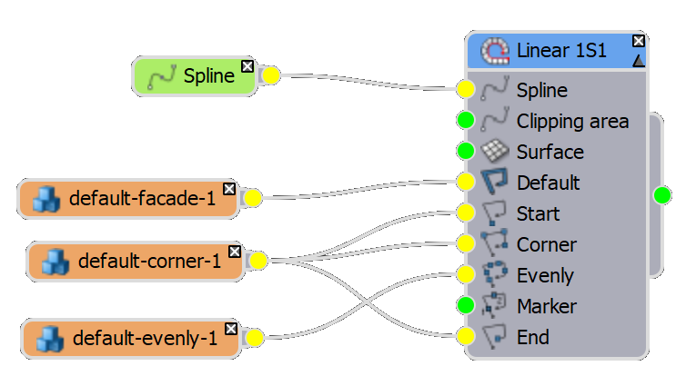

Now that we have our source geometry ready, we can create a new RailClone object.
  1. Go to the Create panel and add a new RailClone object to the scene then open Style Editor.
  2. The first thing we’ll need is a Generator, this is the brain of RailClone, it's where we’ll define all the rules that build the style. In this case, I'm going to use a linear, also known as an L1S generator
  3. Next, I need to define a path. Create a new Spline node and wire it to the Generator's Spline input. Pick a spline from the scene.

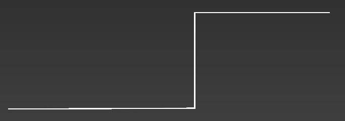

    A Z shaped spline
    When building a new style we like to temporarily use a simplified 3 section path with an internal and an external corner. Note that you can also assign the path from the Base Objects rollout in the Modify panel.
  4. Now we can start importing the geometry. Add a Segment node and pick the Start/End geometry from the scene.
  5. Wire the Segment to the Generator's Start and End input. Pick the material from the source geometry and assign it to the RailClone object.

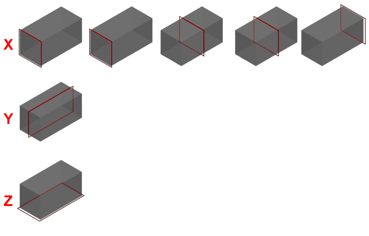

  6. Before we move on, let’s take a look at the Segment > Alignment settings. By default, the geometry’s bounding box is used to place segments. The bottom of its bounding box is aligned with the spline on the Z-axis, and the centre of the bounding box aligns with the spline on the Y-axis. On the X-Axis, however, the alignment depends on which input the segment is attached to.
    Alignment settings
  7. Generally speaking, unless you've got a very good reason to do so, I would leave X Alignment on Automatic, and the ones I regularity change are Y and Z. In this case, because the pieces may be different sizes on the Y-axis, I would change the Y Alignment to Pivot to ensure everything snaps together correctly.
    Alignment Settings
  8. All of the others segments should also use this same alignment, so to save from having to change that setting every time, I'm just going to clone the existing segment using  CTRL+C then CTRL+V to copy and paste a new Segment node
  9. Now let’s pick the Default geometry and wire it to the Default input. The segment fills the spline between the existing Start and End segments.

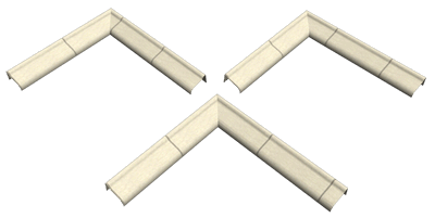

Next we have the Bevel Mode option. This one can cause confusion because it only applies to the way that the Default geometry is sliced, it doesn’t affect the geometry that we’ll wire to the Corner input.  You can use one of 4 modes
The Bevel Modes
  • None disables bevelling the default segments. Instead, it will try to bend the geometry around the corner, or if a Corner segment is present, it’ll stop the default geometry either side.
  • Reset starts the geometry again, so you’ll get a full-width segment after the corner.
  • Extends slices the geometry so that the length of the segment is maintained as if continues around the corner, giving an appearance of continuity.
  • Finally, Symmetric matches the size of the segment on both sides of the corner.

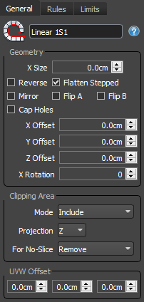

General
If we switch to the General tab, we can find even more handy settings.
The General Tab
  • Starting at the top, we have a Reverse option that reverses the path, but without you having to change the base spline manually.
  • Cap Holes will fill in any parts of the array that gets sliced.
  • X Offset, translates  the array on the X axis.
  • Y Offset expands the path to one side of the spline. This setting is particularly interesting when used in conjunction with the Mirror checkbox above. When this is active, you are actually creating two versions of the array, one on each side of the spline. You then have options to Flip either or both of the arrays as required.
  • Moving down, Z Offset does what you’d imagine, it translates the whole array on the Z-axis
  • Finally, X Rotation rotates the array using the path as a pivot.
