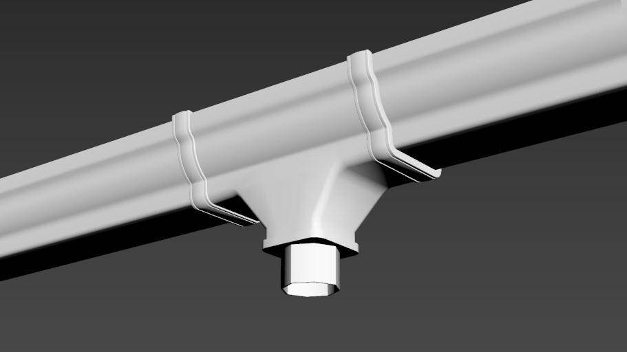

There is another hidden feature, and this is the one we get asked about most. These styles can add a T-junction for downpipes. To add one, just select the spline and add a new Vertex where you would like the junction. Change the vertex type to Bezier and a new T junction will appear. Easy as that!

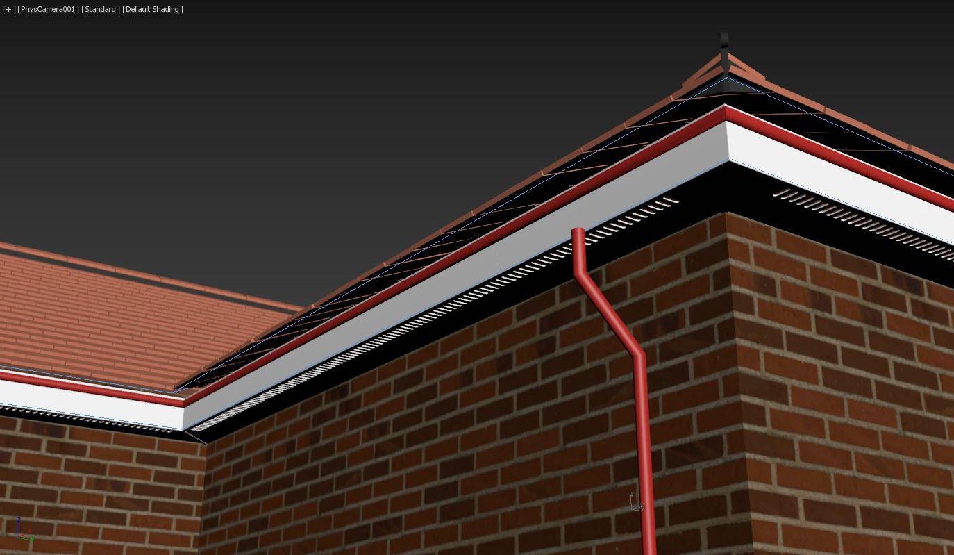

Do add the downpipe itself, follow these steps.
- Draw a new spline to define the path. Once again the vertex types should be set to Corner.
- Create a new RailClone object and choose a downpipe from the library. Select the spline you just created from the Base Objects rollout.
You can now control the downpipe using the settings int he Parameters rollout.
- Spout Rotation changes the rotation of the outlet
- Bracket Rotation changes the rotation of the brackets, allowing you to turn them towards the wall
- Bracket Spacing does what you’d imagine, it changes the distance between brackets.
- Material controls the colour, and finally
- Fillet Radius controls the radius of the curve if there are any corners in your downpipe.
