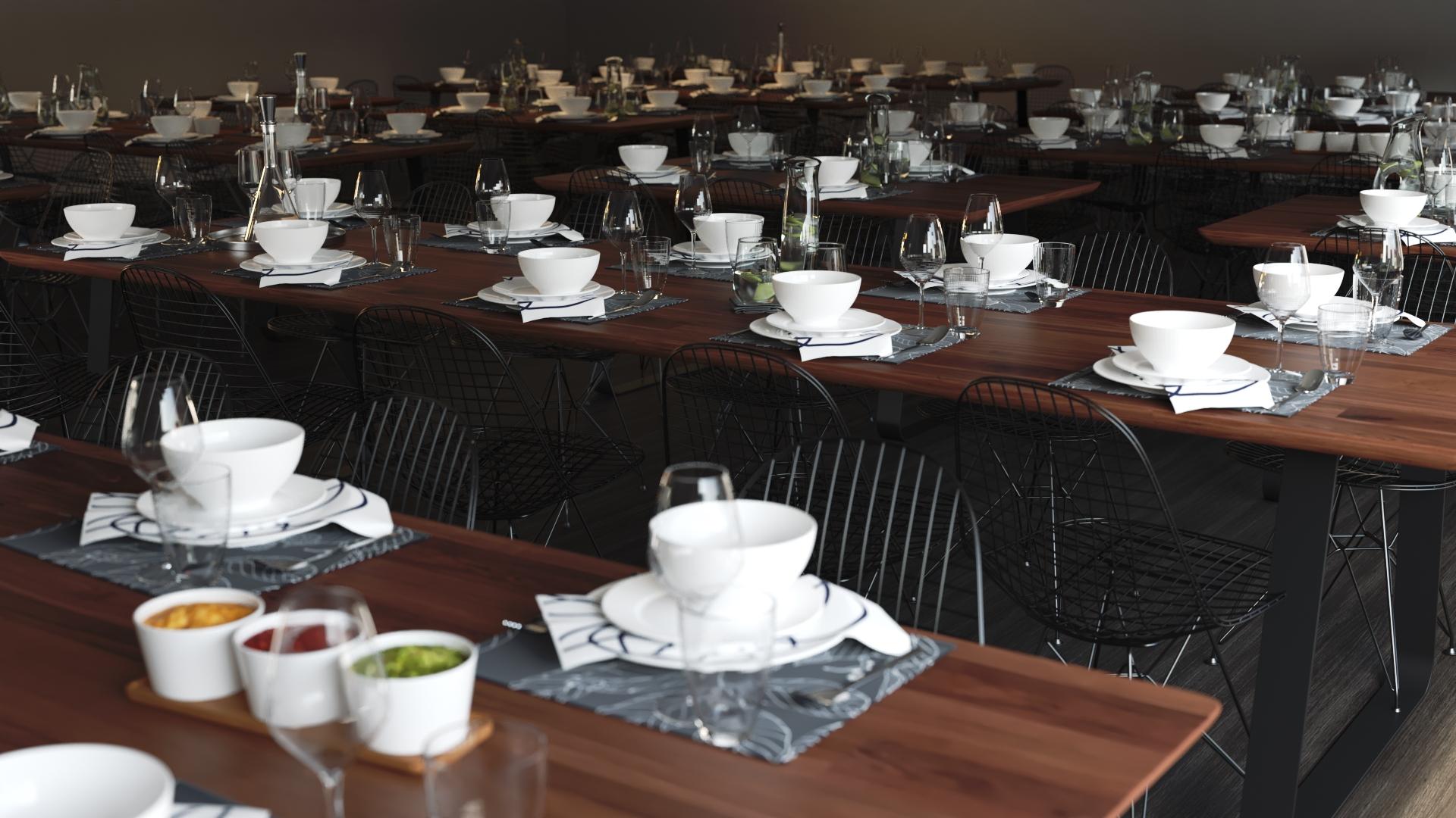

We recently released a 10-Second Tip featuring a parametric table style to illustrate how to render using the materials applied to the source geometry. This is particularly handy when you're constructing style using several assets from stock libraries and you don't want to have to manually create a multi-sub object material and remap all the IDs.
To use this feature. there's a simple checkbox in the style rollout, but following the tutorial, we did get some additional questions asking for more information about how to create the actual style itself. In this tutorial, we'll explain how it was done.
First of all, you'll need to source your assets. For this demonstration, we used a table, a chair and several other related accessories from the Chaos Cosmos library.

We now have a finished style with one Generator used for the table, another for the chairs, a third for the place settings, and finally, a fourth for adding accessories. If we close the Style Editor now, we can assign this easily to multiple splines just by going to the base objects rollout.
