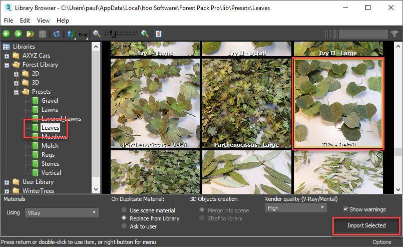

To illustrate how it works, we’ll load a preset from the library:
- From the Create panel, select Forest Pack and open the Library Browser. Pick a leaf preset and click Import selected.

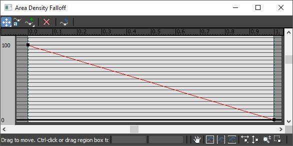

For example, by increasing the Density > Include value the number of leaves is reduced as they get closer to the spline. The amount the density is reduced is controlled by a Falloff Curve. The X-Axis represents the Distance measured from the edge of the area, and the Y-Axis represents the Density.![Falloff Graph]()

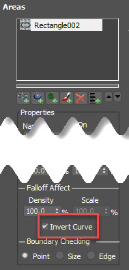

- But what if we want the opposite? What if we want dense leaves around the perimeter, gradually reducing to nothing toward the centre of the area? That’s where the Invert Curve button can help out. Simply by clicking this option, the falloff shape is inverted and leaves are densest around the perimeter, reducing gradually to nothing the further they fall from the edge.
- Essentially the checkbox is inverting this graph so, for example, if you wanted to retain some leaves throughout the area, you just need to lower the point on the left side of the graph a little.
- You can use this trick with Exclude areas too. Just add a new Spline area, pick a spline from the scene, set it to Exclude, and then turn on Invert Curve. There’s a separate Distance control for Exclude areas, so you can have a different falloff size for Include and Exclude areas.
