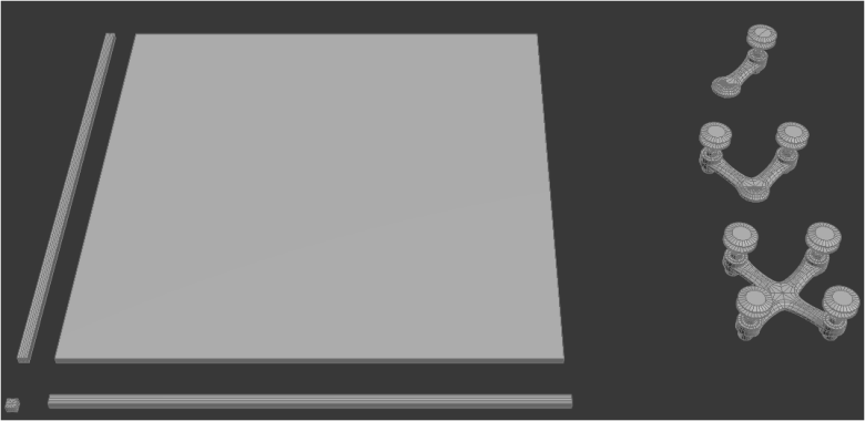

This style uses three types of spider fitting, a glass object, and 3 segments for the silicon seals. The glass pane is 1m x 1m, though the actual size is arbitrary as it will be adjusted as part of the style, but we need to know the original dimensions to enable us to calculate a scale value to produce the new size. For example if we know we want the glass to be 2500mm high we would do the following calculations to find the correct scale value:

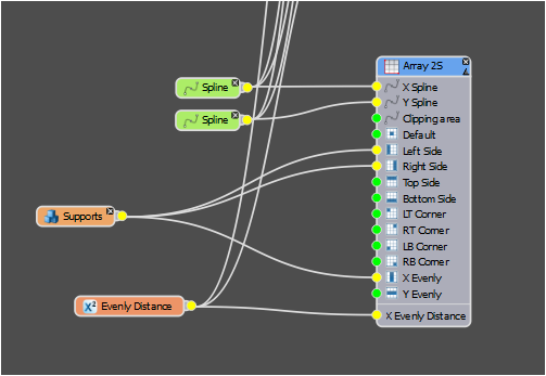

  1. Create a new segment and pick Supports from the scene.
  2. Set the segment's X-Alignment to Pivot.
  3. Wire the Supports segment to the X Evenly, Left and Right inputs.
