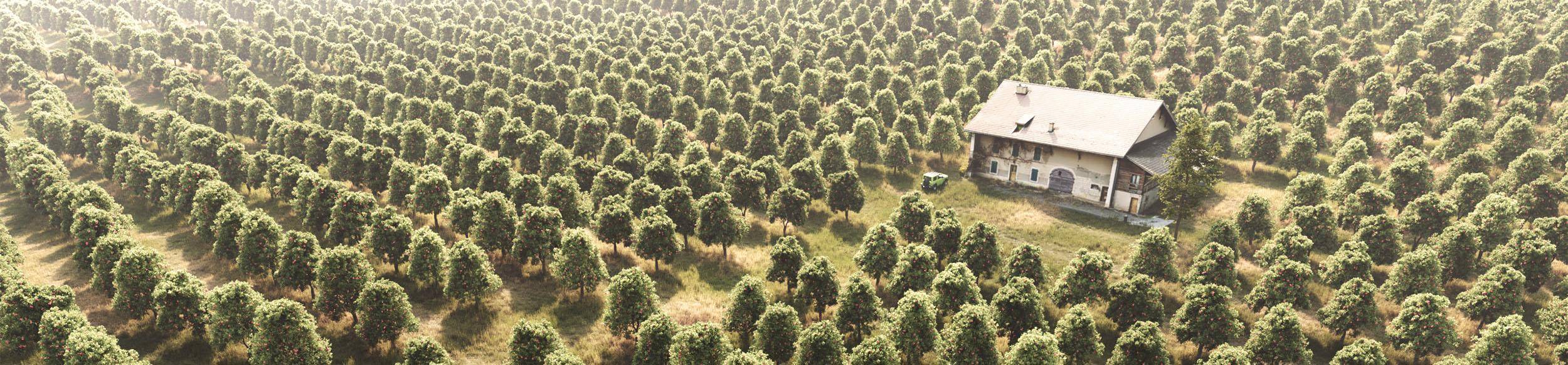

Path Distribution was already a handy way to create scatters, but with the addition of these 4 effects, we hope you’ll find the mode is even more flexible. If you have any other suggestions for Path Deform effects, please let us know!
This render uses the model "Abandoned farmhouse " (https://skfb.ly/otJDD) by sr-prod which is licensed under Creative Commons Attribution (http://creativecommons.org/licenses/by/4.0/).
