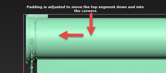

  12. If you look at the top of the blind you'll see it doesn't line up with the brackets on the sides. To fix this select the blind_top Segment and enter a Padding > Top value of 0.007m to move the blind down so that it is correctly aligned.
  13. Because of the shape of the bracket it's pushing the top section along too far. Fix this by selecting the blind_left Segment and enter a Padding > Right value of -0.036m to close up the unwanted gap in the top row. Similarly enter a Padding > Left value of -0.022m for theblind_right segment.

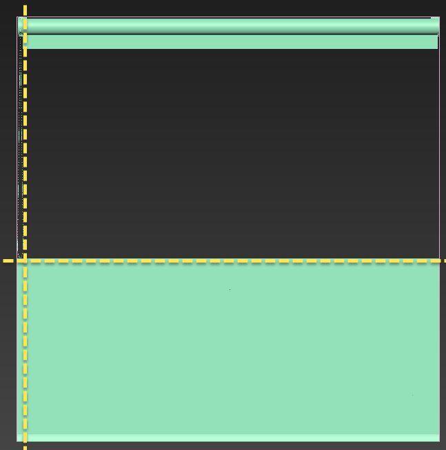

  14. Because of the chain the default segment has a large gap above it, also the default and bottom segments are not inset on the sides to account for the top corner brackets.

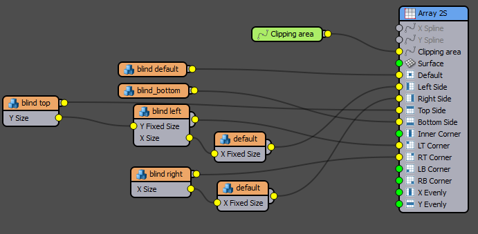

  18. To inset the default and bottom on the sides, add two new empty segments to the graph, one wired in the Left input and one in the Right.
  19. Export the Export Parameters > Fixed Size > Fixed Size > X property for both segments.
  20. Export Export Attributes > Size > X for theblind_left and blind_right segments.
  21. Wire the blind_left segment's X Size output to the Left Segment's X Size input.
  22. Wire the blind_right segment's X Size output to the Right Segment's X Size input. At this point your graph should resemble the image below.

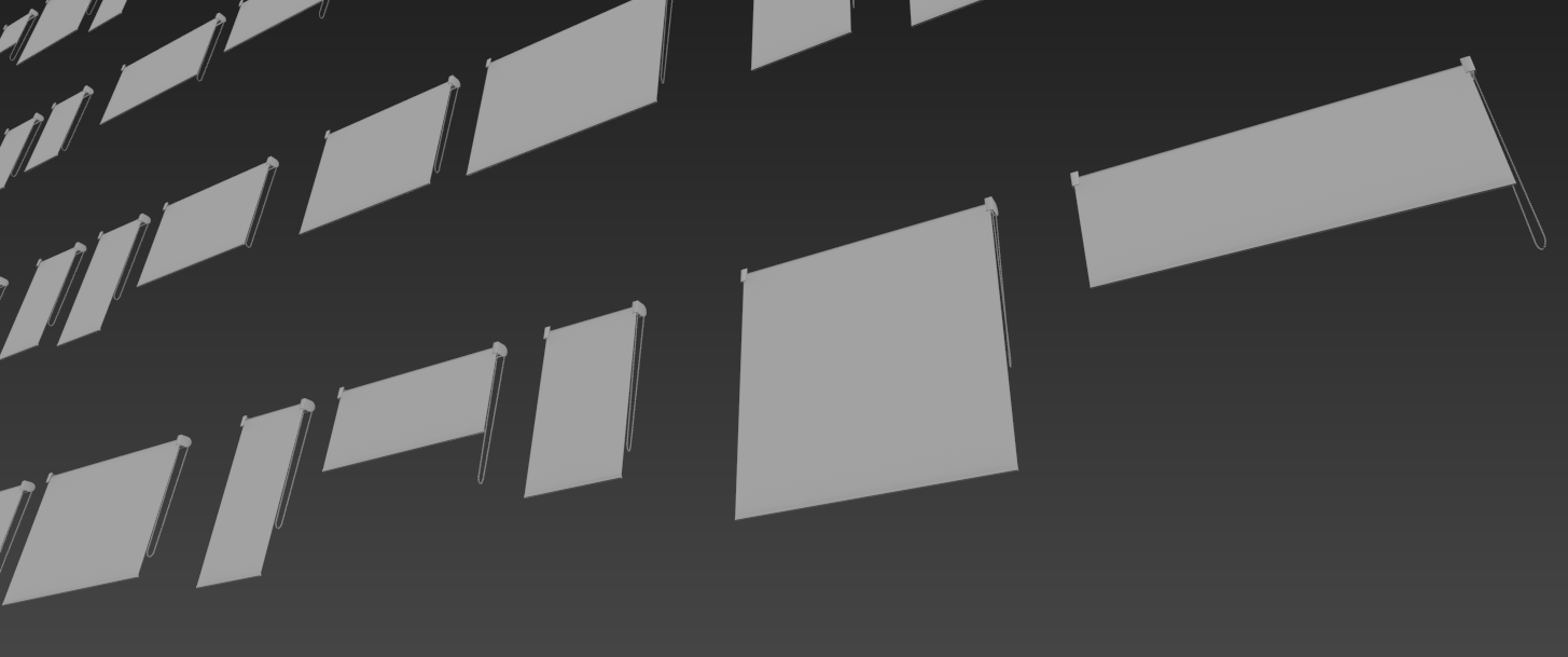

  23. The blind fills the entire clipping spline, in the next few steps we'll randomise the openness of the blind within a minimum and maximum percentage range of the window's height.

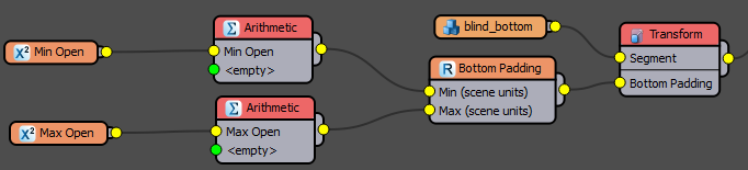

  24. To do this you add a randomised padding value to the bottom segment, but you can't use expressions to control the properties of a segment directly, instead you have to wire the segment to a Transform operator and manipulate that instead. Wire a new Transform operator between the blind_bottom segment and the Generator.
  25. Right click on the Transform operator and select Export Parameters > Padding > Bottom.
  26. We want to randomise this padding value so add wire the exported value to a new Random Number node.
  27. Select the Random node and change the type to Scene Units.
  28. Change Generate on to X Spline Start. This will generate a new random value for each window.
  29. Export Min (Scene Units) and Max (Scene Units). we're going to add an expression so that the random number are within a range determined by a percentage of the windows height. This will mean you can use the style on windows of any size without having to enter measured values.
  30. Wire an Arithmetic node to the Min input. Change the Operation to Expression, open the Expression Editor and enter the following
    YSplineLength*(Input1/100)
    YSplineLength is used in this expression to automatically return the height in scene units of the current array. To get the height for the random operator we multiple this by input1, which is the exported percentage value, divided by 100. When you're done, Click OK.
  31. Next we create the Percentage paramter. Wire a new Numeric node to the Arithmetic operator's input, change the type to Percentage and Limit the range between 0 and 100%
    Randomising Blinds-image2015-11-20 19:54:8.png
    Name the Numeric node Min Open
  32. Select the Numeric and Arithmetic node and copy and paste to create a duplicate. Wire the duplicate to the Random node's Max input. Rename the second Numeric node to Max Open.
    Randomising Blinds-image2015-11-20 19:58:39.png
  33. In the Parameter's rollout, set the Min Open value to 30% and the Max Open value to 80%. Change General > Random Seed to see variations using these values.

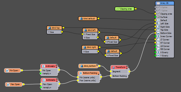

  34. Your final graph looks like this:

  35. The beauty of this style is that we can easily apply randomised blinds to an entire façade. To do this make sure to rotate the whole style 90 degrees on the X Axis, and 180 degrees on the Z Axis so that the blind would face inside the windows and change the Clipping path to the Window spline. That's it, instant blinds with randomised open sizes within a minimum and maximum range.
