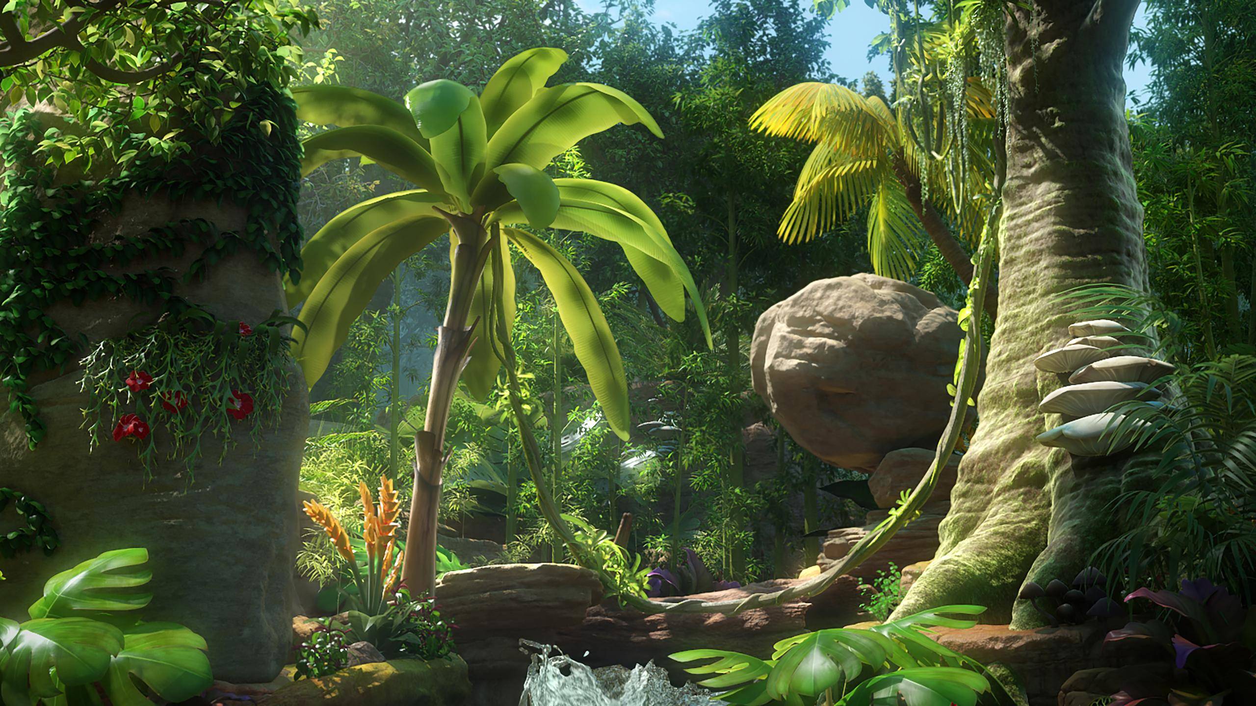

Creating Jungles
We asked Romain which scenes he used Forest Pack for. "All of them" was his response! “We are using it in all of our environments that need a jungle,” he told us “which is probably over 80% of all the environments in the film. Despite this, our basic workflow hasn’t changed much since we started to work with Forest Pack way back in 2011.

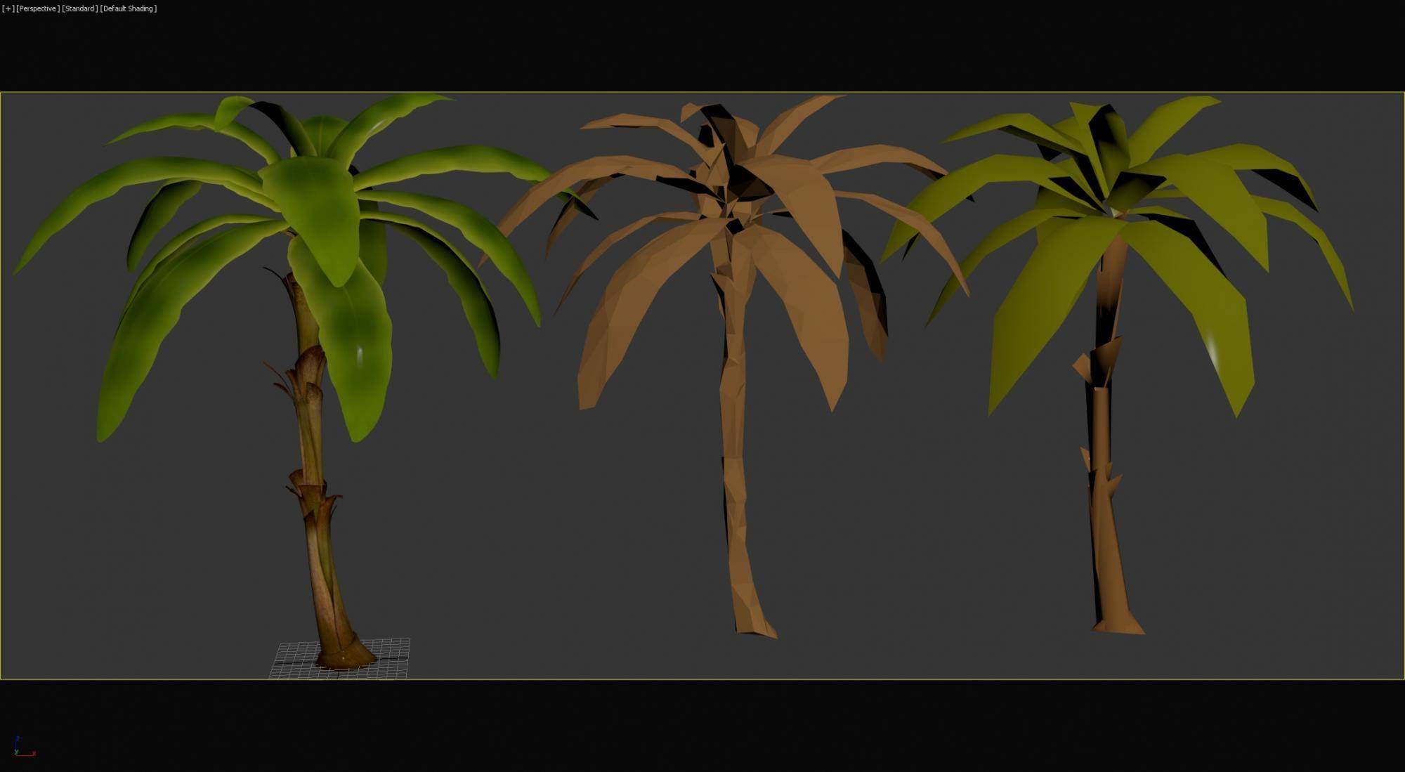

“First of all of our vegetation assets are prepared with 3 levels of detail, so we have:
  • "A high quality version: mainly used for foreground or when the asset needs a tweak for a specific shot.
  • "A medium quality version: optimized and converted to a V-Ray Proxy. These are probably used in 99% of the shots.
  • "A low quality version: this ultra low poly version is also shaderless and it’s for Viewport display only (with Xref objects) and for layout/animation scenes."
TAT Productions use Xref objects extensively to quickly switch between quality levels and to make it easy to update assets in a scene easily. It makes it possible to start work and build an initial version of the set dressing without having to wait for the asset’s final detailing.

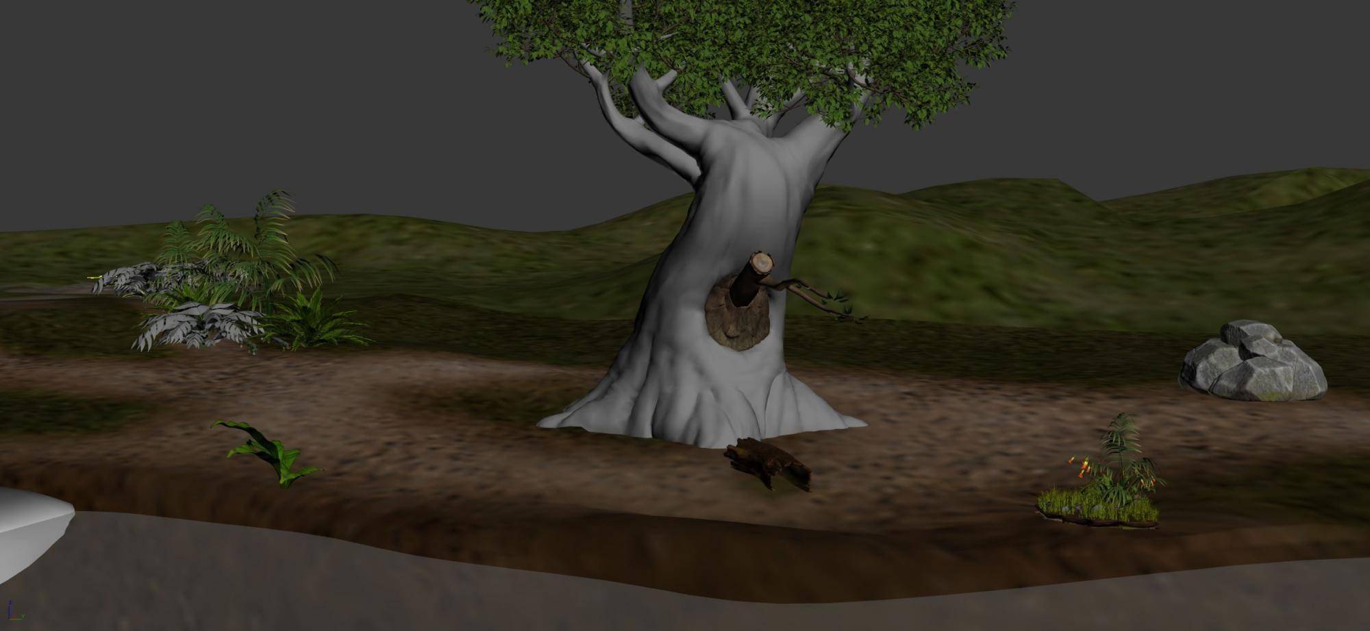

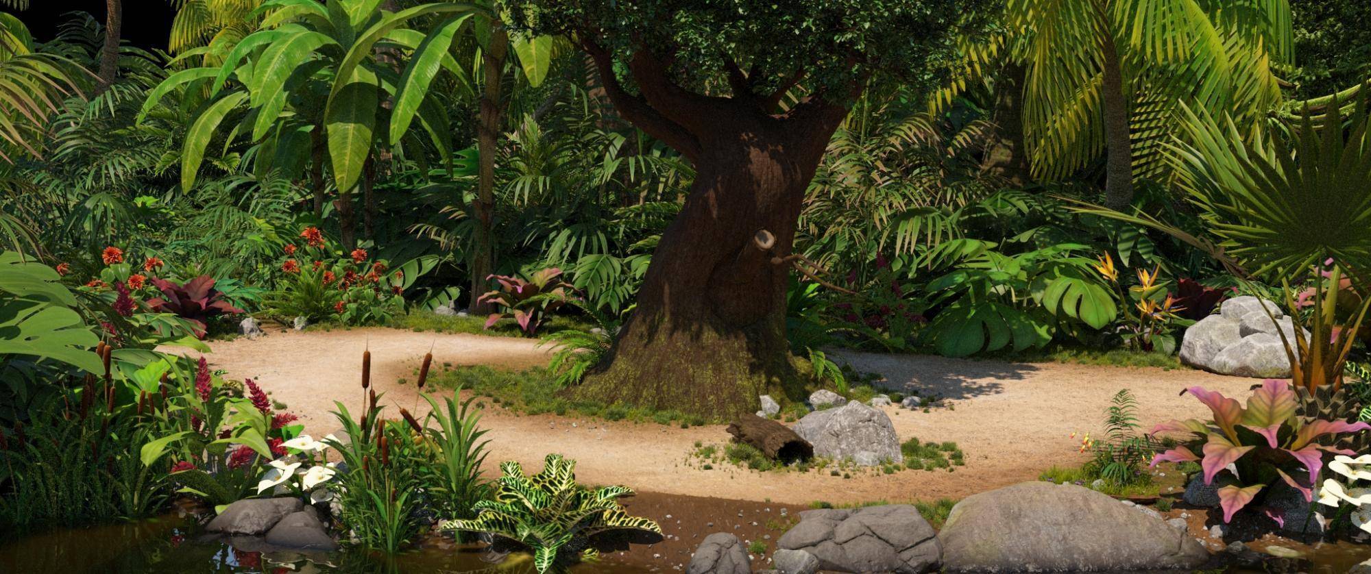

With the assets prepared, Romain tell us that the environments are typically built in 4 steps :
Step 1
“Creating the environment topology, the base terrain before adding any set dressing.
Step 2
“In the second pass the sets are dressed immediately surrounding the characters. These objects must remain accessible in case they need to be moved for layout composition, animation and occasionally for rendering cheats. For example a tree or another piece of vegetation behind a character may need to be moved a little bit to fine tune the shot.

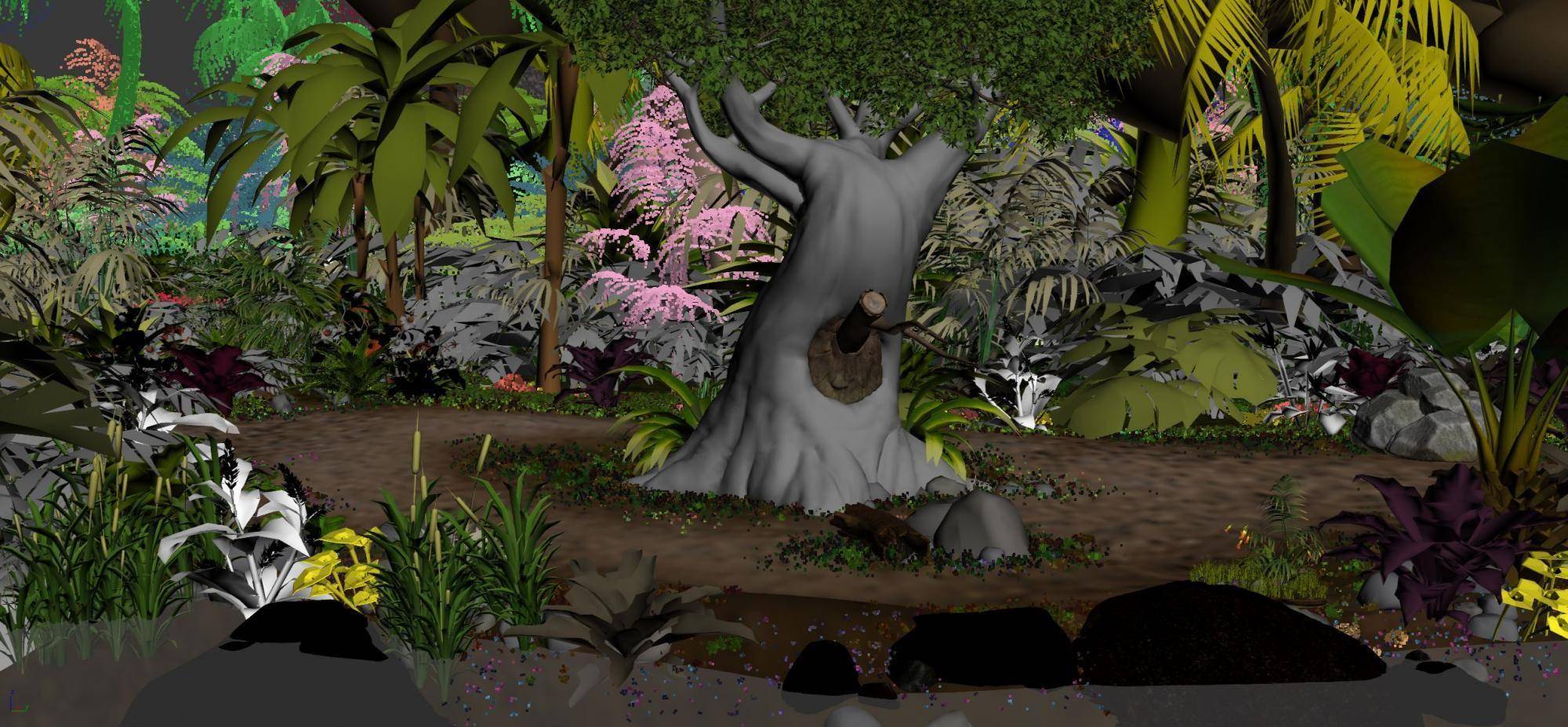

Step 3
“In the third step the surrounding areas are populated using Forest Pack using the Xrefs mentioned above. In theory these areas are forbidden zones for animators so they’re for rendering purposes only. The power of Forest is its ability to quickly fill larges areas while providing believable variation in distribution. One of my regrets on the Jungle Bunch is that we couldn’t use the forest color map slot for tint variations, because of the fact that we also had a lot of non-forest objects in the scene. Making the forest color map independent from the forest object could be a huge improvement for us.

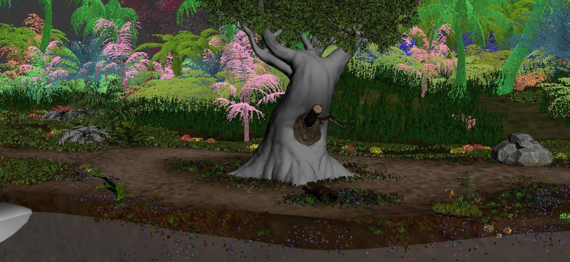

Step 4
Finally we paint smaller items all over the environment like grass, rocks or leaves.Forest Pack’s paint area function exclude splines features are invaluable for this as they give us powerful tools to work quickly and precisely at the same time. Another of the big advantages is to reduce the overall number of object’s in the scene and improve rendering efficiency."
