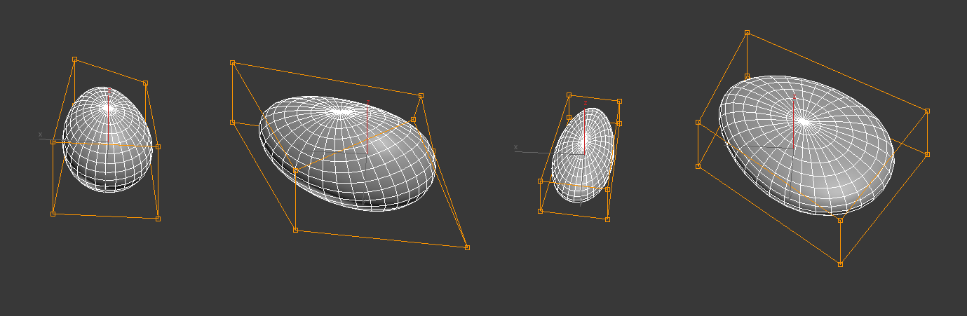

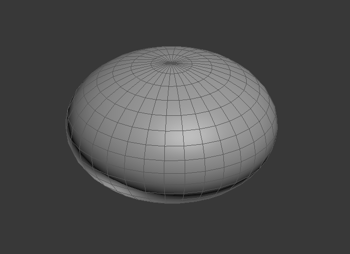

Create a sphere and squash it a little bit vertically. Add a FFD (2X2) modifier to it and deform it randomly. Duplicate it and tweak the variants so that you have enough difference between your grains.

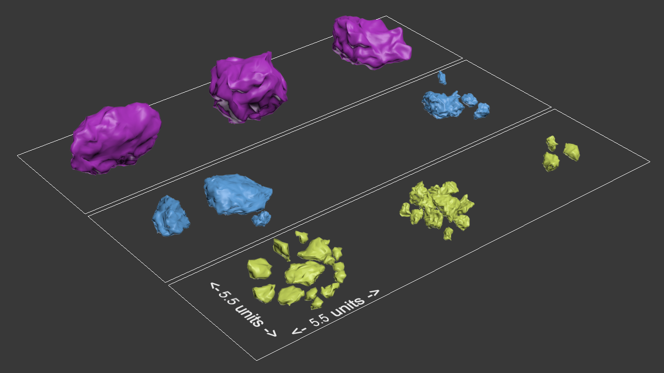

- Duplicate these grains and manually randomise their rotation, scale and position to create a little patch. you can randomise the vertical position, but not too much, otherwise your grains of sand will either float or go through the ground.

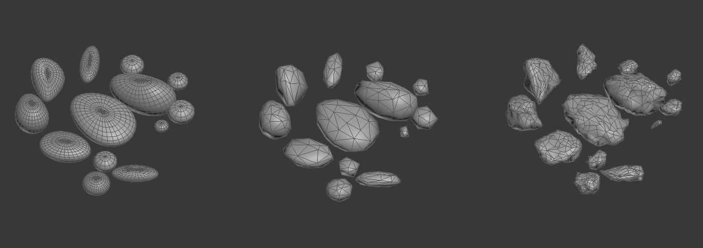

Once you have created your patch, add a ProOptimiser modifier to it, followed by a turbosmooth and a noise modifier. This is to break the roundness of your grains and add crispy details to catch specular highlights.
Repeat the process to generate different patches. In the image below, I created 8 variants: 3 single grains, 2 large patches, 2 medium patches and 1 tiny patch.
- For this scene, you will have to resize your patches so that they fit in a 5.5 by 5.5 units square. Also, remember to adjust the pivots so that they are in the centre of the patch, and a bit above the bottom of the object on the Z axis.

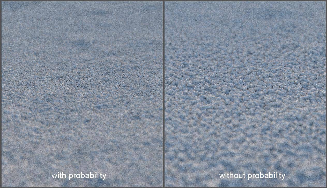

First, we'll need to fix the probability of our scattered items. The bigger individual grains are to be used sparingly to break the overall model and as such they need a very low probability.
You can edit probability by selecting an item from the list, and editing the value of the Probability parameter, just above the material slot button in the Geometry rollout. Here are the settings I used:
These settings give you a much more naturalistic distribution:

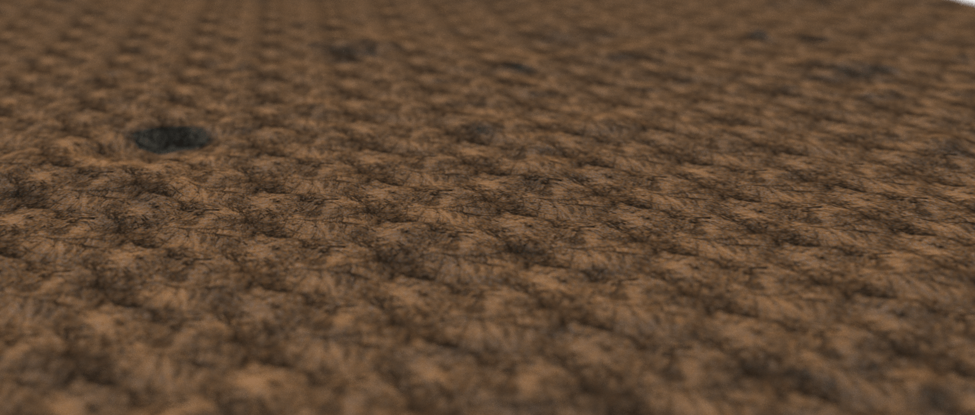

To refine further, In the Surface rollout, change the Direction from Up to Normal. This will force the patches to align to the surface of the beach and follow the small variations of angle.

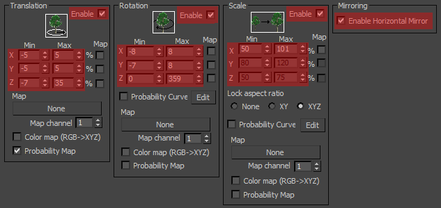

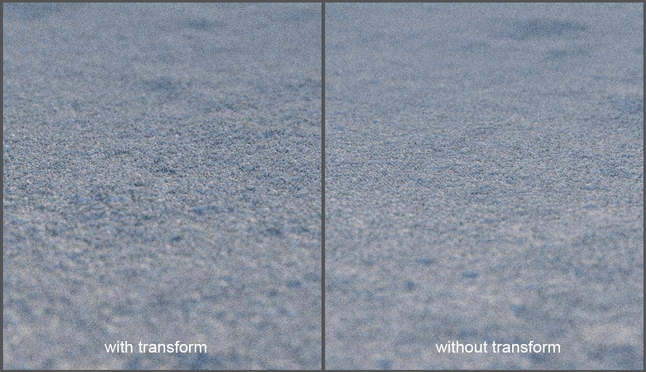

Finally, in the Transform rollout, enable Position, Rotation and Scale checkboxes, and use the following settings:
This will help breaking the grid pattern of the distribution map

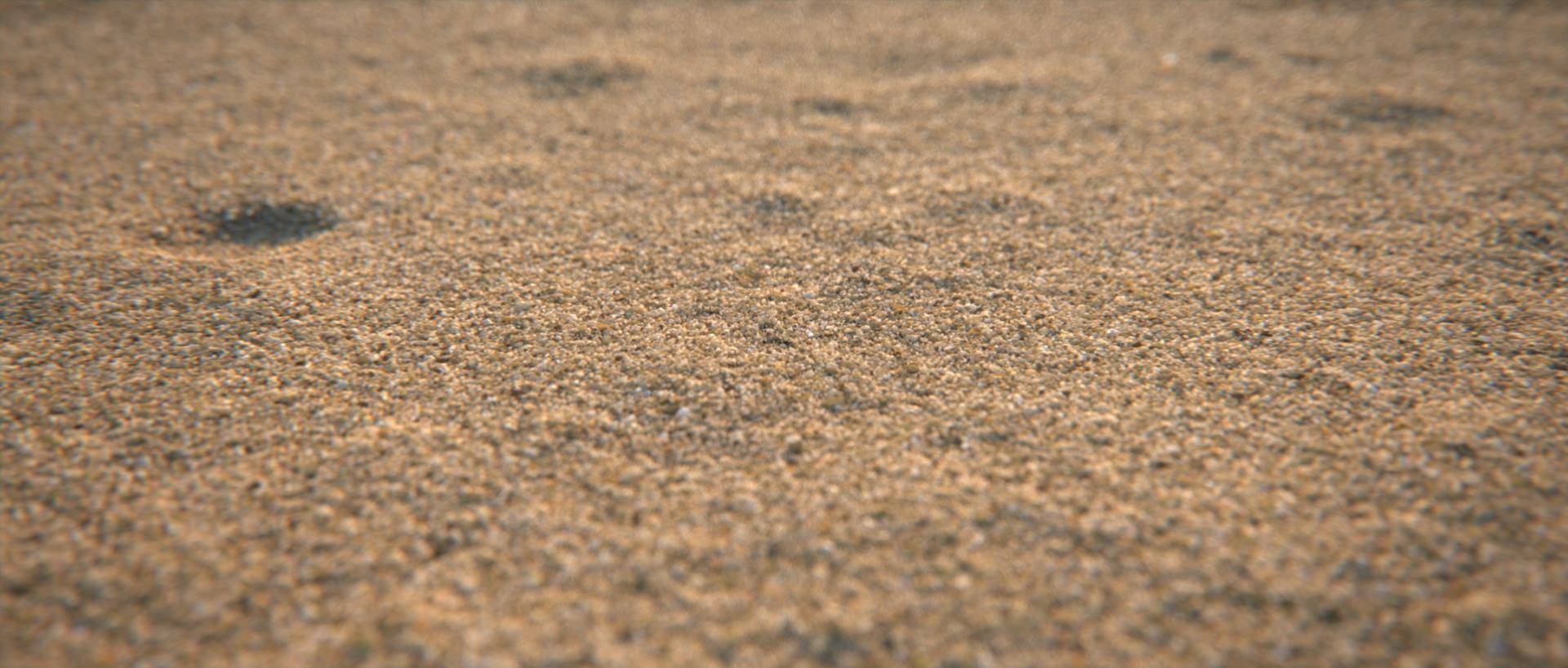

With all these settings applied, here's what you should get now:

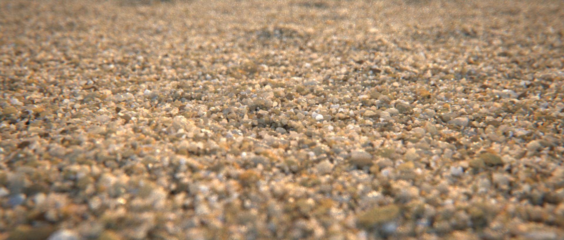

If you render now, your render-time will take a (very) serious hit, since you will basically be rendering thousands of diamonds - but your grains of sand will blend a lot better:
The effect is even more noticeable on a close-up.

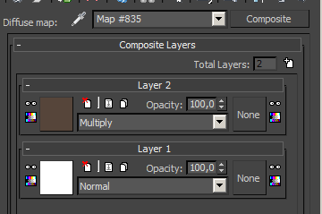

In the diffuse slot, nest the Forest Color map under a composite map, and add a new layer on top. Plug a brown V-Ray Color (value r:86 r:69 b:58) into this new slot and set to mode to Multiply. This will darken our sand to make it look wet.
