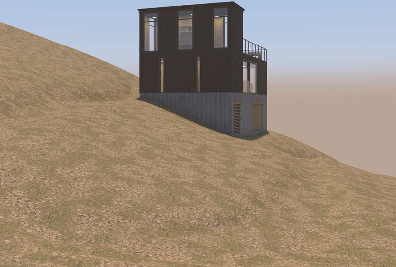

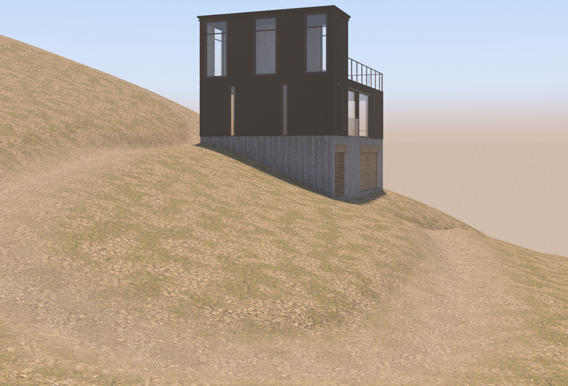

Scene setup and Surfaces
Megascans organise their assets into 4 categories: surfaces, atlases, 3D objects, and a new range of 3D plants. We'll take a look at each of these in turn as we build up a small woodland scene. Here's how the environment looks before we add scattered assets.

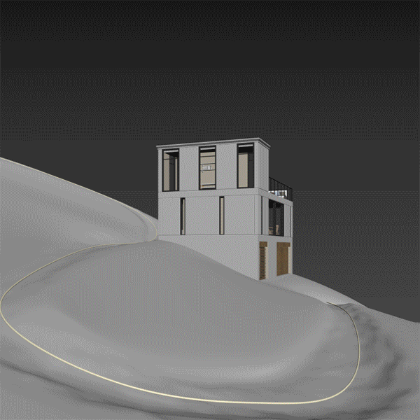

It's pretty basic, we only have a couple of terrains, one with a footpath,  plus the building to work with. We're also going to need one more thing: a spline that follows the footpath that we will use to drive nearly all of the Forest Pack objects. You can easily extract one from the terrain geometry by selecting an edge from the middle of the path and clicking Loop to select a centre line. Click on Create shape from Selection and use the default settings to generate the spline.
As well as being invauable for Forest Pack, this spline also gives us the ability to apply a separate material to the footpath area by using a distance Map. This works by applying a texture based on the surfaces proximity to the spline we just created. In this tutorial we'll be using V-Ray, but Corona and other renderers also have this feature.
For a Distance map to work, the spline needs to be a mesh object, so select the spline, go to the Rendering rollout and turn on Enable in Viewport. Leave Enable in Render turned off, otherwise you'll see the spline in the final image. The thickness can be left quite small, because it's the distance from this spline that matters.

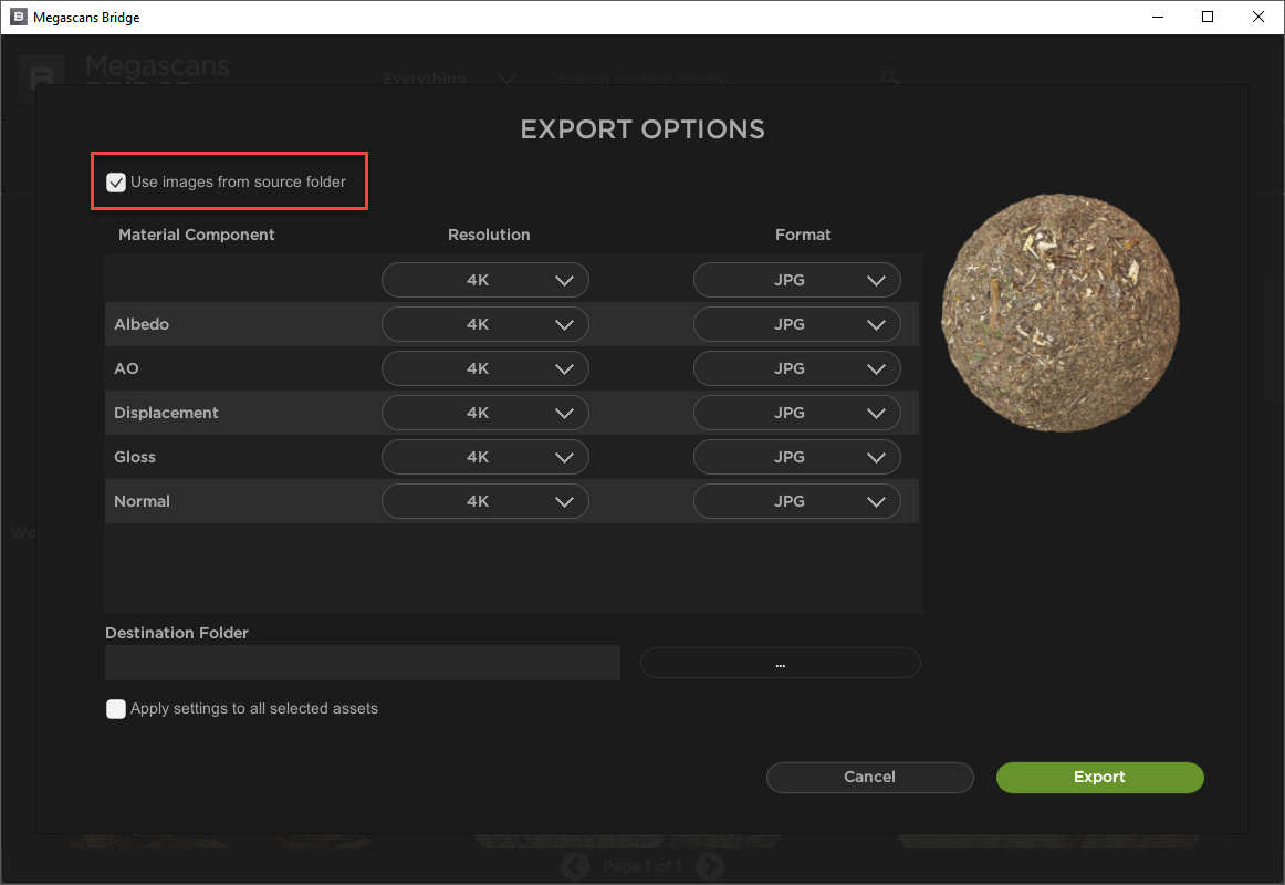

  3. From the Export Options choose the resolution and format, as well as whether to copy the images to another folder. Generally we turn on Use Images from Sourcefolder to leave them where they are.

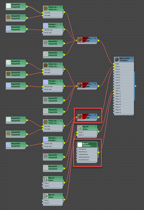

  5. You can now add this material to the existing V-Ray Blend material. Wiring it to a Coat input.

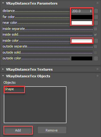

  6. Now we can add a mask to reveal this material on the footpath. Create a new V-Ray Distance Texture map and wire it to the appropriate Blend input.
  7. In the V-Ray Distance Texture's settings, go to the Objects rollout, click on Add and pick the spline we just created from the scene.
  8. Change the Far colour to black, and the Near and Inside colour to white. This will create a black and white mask that reveals the material in the area close to the spline.
  9. Finally to control the how far either side of the spline this material should show, increase the Distance value. A setting of 200 works in this scene, but you'll need to experiment.
If you render now, you'll have see the new material only where the path is. Because this is determined by a spline, you can easily edit the path and the textures will automatically update too!

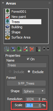

  5. To remove trees from the building, click the Add Object Area button and pick the building from the scene. If you want to change the distance around the building that trees can be scattered, use the Scale parameter, to increase the accuracy of the collision detection, increase the Resolution. (Internally Forest Pack creates a black and white mask by projecting exclude objects on the world's Z Axis).

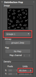

  6. To control the number and spacing of the trees, go to the Distribution Map rollout and change the Density to about 19,000 cm. You can also just judge this by eye. Feel free to use the X and Y Offset values to slide the Distribution map around on the surface to fine-tune the scatter.

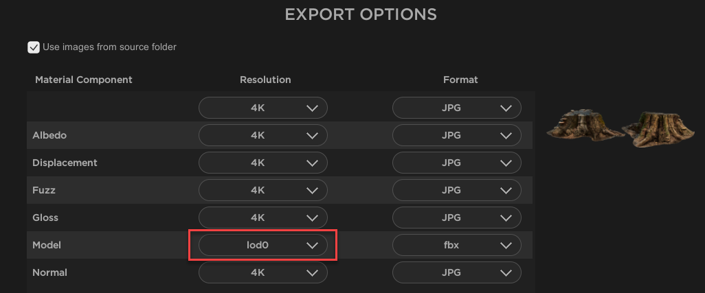

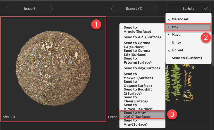

  1. Once you've downloaded your assets from the Megascans website, open Megascans Bridge.
  2. Select the model you wish to import.
  3. Go to the Scripts dropdown and select Max, then Send to Vray (GGX) (or a different preset if you are using another renderer).
  4. From the Export Options you can choose the LOD, texture resolution and format, as well as whether to copy the images to another folder. We're going to use LOD0 to reduce memory usage, but if you have a powerful system, you can go for the high poly versions.
  5. Click Export and the file will automatically be imported into 3ds Max. Materials are created from the maps and automatically applied.

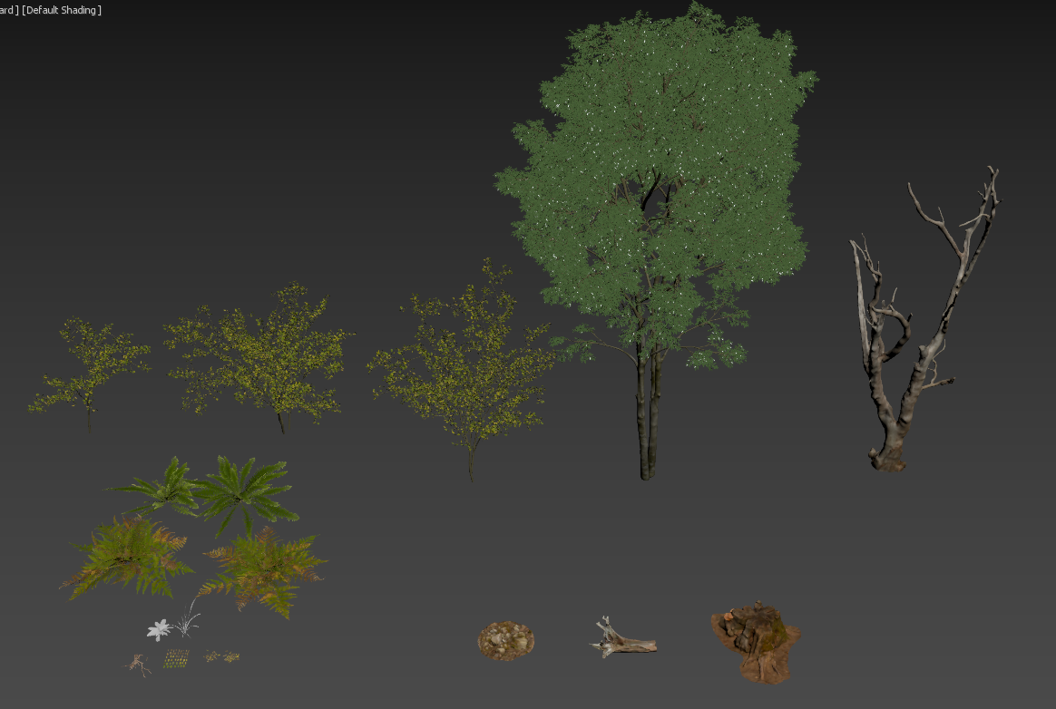

  6. Go through the same process for all the 3D models you wish to import. We're going to add a standing dead tree, a tree stump, a fallen tree, and some rocks.
Hero models like this would typically be manually-placed, but even so it's worth adding them to a Forest Pack object. In that way you'll benefit from impovements in memory management and render speed, as well as Forest Pack's transform and texture randomisation features should you want to use them. To use Forest Pack to manually position objects.

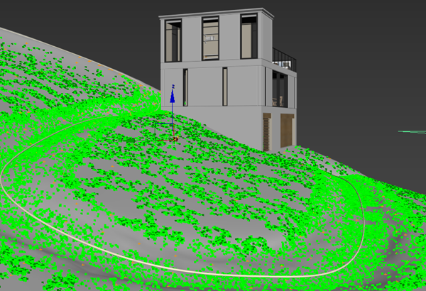

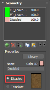

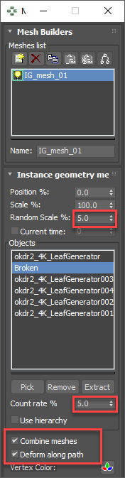

  5. Add a new Item and set it to disabled. This will add spaces in the scatter and when used in conjunction with the Clusters feature, can add gaps in the scatter where there are no branches.
  6. Now let's randomise these objects, go to the Transform rollout and enable TranslationRotation and Scale. Leave the Translation settings at their defaults. Zero the X rotation properties to stop the branches rotating through the surface. Change the scale to 40% Min and to 200% Max to introduce a much wider range of sizes.
  7. Enable Horizontal Mirroring to add further randomness to the objects.

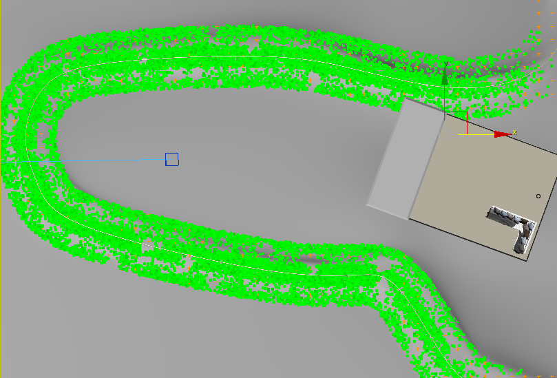

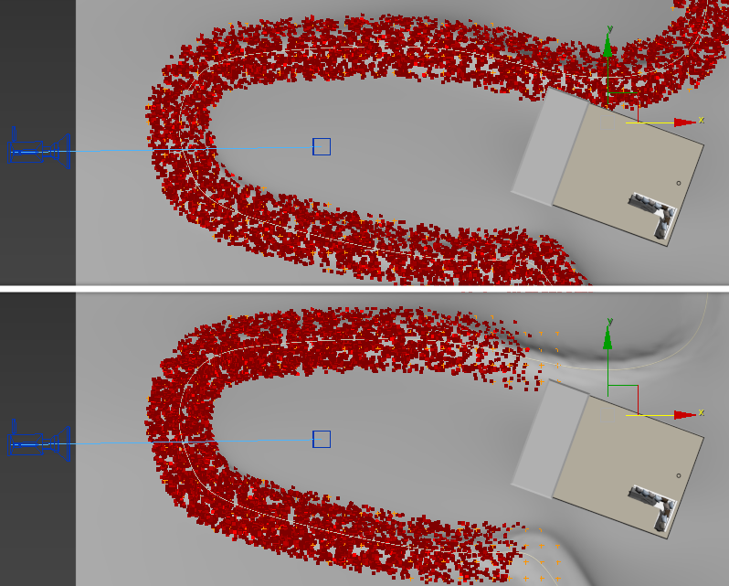

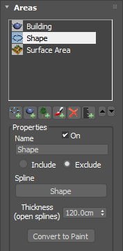

  8. These branches are a bit of a trip hazard! To remove them from the path, go to the Areas rollout and add a new Shape area. Pick the footpath spline from the scene and set the mode to Exclude.
  9. Increase the Thickness property until the branches are cleared from the middle of the path. Ideally you'll want to be able to see them at the edges, but keep the majority of the path clear.
  10. In the Distribution rollout, change the Density to 950cm, or until you have the desired coverage of branches.
  11. At the moment the distribution is pretty uniform across the whole area. We'd like to add some patches where no branches appear, and to do this we use the Clusters feature. This allows you to group together plants that have the same Colour ID. Remember all the sticks have been assigned to one Colour ID, and a disabled item has a second, different, colour ID. What this means is that we can create gaps in the scatter by creating a cluster of disabled items. To do this enable Diversity > Clusters and change the size to approcimately 100cm.

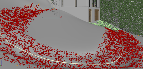

  6. Go to the Areas rollout. Currently we're scattering on the whole surface, but realistically we'll only ever see this debris on the path. To achieve this, turn off the existing Surface and add a new Shape area. Pick the footpath spline from the scene and increase the thickness until the twigs overlap the side of the path. About 205cm worked well in this example.

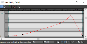

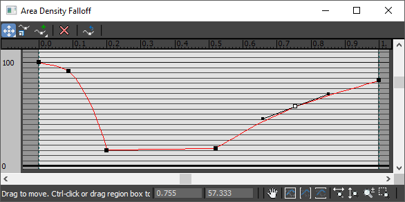

  7. Rather than stop apruptly as the twigs disapear into the undergrowth, it would be better if their density gradually decreased. To do that, enable Falloff > Density and increase the Include value to about 70cm. By default this feature uses a linear falloff graph to adjust the density based on the scattered items distance from the perimeter of an area. As we'll see later, these graphs can also be edited to create more sophisticated effects.

  8. Now let's change the global density. Go to the Distribution Map rollout and change the map to Groups 1. This will give us little clumps of twigs instead of the usual even distribution. Decrease the Density to 100cm to add more twigs and turn on Clusters. Reduce the size of the clusters to 50cm. You can also change the shape of the clusters using the Roughness setting, increase this to make them more angular.

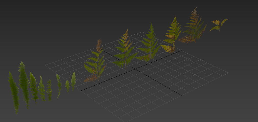

The Megascans library also includes atlases. These are cutout textures with an opacity map, fantastic for creating leaves and modelling plants. They don't include a 3d model so we need to do a bit of work before we can use them with Forest Pack. There are already a few tutorials published about this process that either hand trace the atlasses with splines, or use ZBrush. We'll demonstrate a slightly different approach that uses an application called SpriteUV. This is an easy-to-use free or inexpensive tool that was originally designed for packing sprites, uvs and textures, but it's also ideal for automatically generating meshes that match the shapes contained in an atlas. To Illustrate how it works we'll take this leaf material and create 3d models that are ready to be used with Forest Pack and GrowFX.

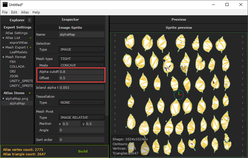

  7. Next go to the Mesh Export Group > Mesh Export options,set a path and assign a filename. The other important setting here is the Pixel Per Unit value. This is how the size of the resultant mesh is determined. The size of the mesh will be the resolution of the texture divided by this value. For example, if my scene units are set to CM, my opacity map is 1024 x 1024, and the Pixel Per Unit is set to 100 (the default),  therefore the size of the model when imported into max will be 1024/100, or 10.24cm. We'll use this measurement to set the size of the UVW map as we'll see later.
  8. Now we can configure the mesh - go to Mesh Format > FBX and change the Up Vector to Z and the turn on Flip Z.

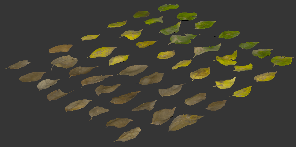

  9. Go to the Atlas Items settings. You'll see a preview of the mesh output. There are only a couple of paramters here we need to worry about. Offset, which adds padding around each leaf, and Alpha Cutoff which is a threshold used to detect the edge of each leaf. We try to get our mesh as close as possible to the texture to reduce the amount of transparency in the final render. This can really slow them down in some cirumstances. To get the mesh tighter, reduce the Offset value and increase the Alpha Cutoff
  10. When you're happy with the results, turn on Export Mesh Only and click Build. A new FBX file will be created in your save location containing a mesh for each leaf.

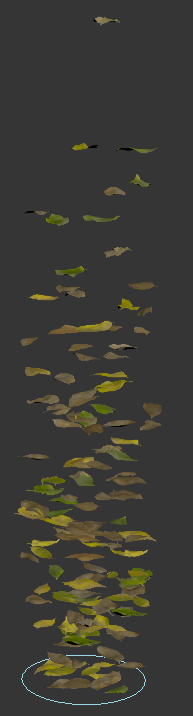

That's it for the SpriteUV section. All that remains is to import the FBX into 3ds Max, adjust the UVs, apply materials and make a few other small changes.
  1. Import the FBX file into 3ds Max. For some reason when viewed from above the object is upside down, so immediately rotate it around the Z axis by 180 degrees and then reset the XForm
  2. Apply the material imported from Megascans Bridge. If you show the diffuse texture in the viewports,  you'll notice that the UVWs haven't been calculated, so we need to add them ourselves. Fortunately this is very easy.
  3. Apply a UVW modifier to the leaves. Set the size to 10.24cm x 10.24cm. You'll remember from earlier that this size was calculated by dividing the resolution of the original map by Pixel Per Unit value specified in SpriteUV.
  4. Go to the Gizmo sub object level and use the Align tool to alight the gizmo to the leaf object's pivot. Your textures are now perfectly aligned to the mesh.

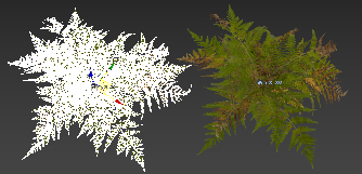

  8. Add a Smooth modifier and turn on AutoSmooth. Our leaves are done and you can collapse the stack. All that remains is to detach them into separate objects and align the pivots.
  9. You can detach leaves manually by selecting each element and using the Edit Poly object's Detach option, or you can use one of the many scripts that are available to automate the process. We have RappaTools installed and we use the Explode Object option to speed up this process.

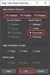

  10. The leaves are now separate objects, but you'll need to align the pivot for each one. Once again you can do this manually, by going to the Hierachy rollout, activating Affect Pivot Only and moving the pivot manually; or you can use a script. We're using Rappatools again to align the pivot to the center and then the bottom of the leaves.
  11. Select the leaves you wish to keep and delete any extras or other bits of the original atlas you don't want to scatter.

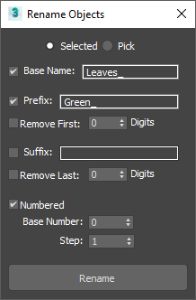

  12. To make it easier to identify the leaves in Forest Pack you should rename them. Launch Max's built-in Rename Objects tool found in the Tools menu. Select all the green leaves and enter the colour of the leaves in the rename tool's Prefix field. Enter Leaves in the Base Name field and turn on Numbered. Click Rename to update the names of the selected objects. Do the same thing for the yellow leaves and then the brown ones.

  6. To create gaps in the scatter add a new item and set it to Disabled. Make sure it has a different Colour ID to the leaves so that the Cluster feature works correctly.

  11. At the moment we're scattering on the entire terrain, but we only want individual leaves on the path (we'll fill in the terrain with larger patches in the next section). To confine the scatter to this area, go to the Areas rollout and turn off the Surface area.
  12. Add a new Shape area and pick the footpath spline. Increase the size until the leaves cover the width of the path and up the sides, about 1.8m works well.
  13. There is a dip in the middle of the path where you'd expect more leaves to accumulate. To create this effect you can use custom falloff curves. Enable Density falloff and click the Edit Curve button and a graph opens.  The X axis represents the distance from the edge, with the edge being on the right of the graph. The Y axis represents Density. To create a more leaves in the center and at the edge you should create a graph which has a dip in the middle, like this:
  14. Now you can change the Include distance to set the range over which this graph is calculated. I used about 140cm, but you can adjust it visually.
  15. The Distribution settings are very similar to the ones we used for the twigs. Choose the Groups 1 map and increase the number of leaves by reducing the Density setting.
  16. Turn on Diversity > Clusters and set the size to about 150cm to create some decent sized gaps in the scatter.
  17. Make the clusters more ragged by increasing the Roughness value, and blend the boundaries between clusters by increasing Blurry Edge.
You'll now have leaves that follow the path, with a greater density in the center of the path and at the edge, broken up with occasional gaps.

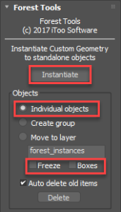

  4. Next we need to convert the Forest Object to native Max instances. To do this, go to the Utilities Panel, Click on More and load Forest Tools. Change the mode to Individual Objects and uncheck Freeze and Boxes. Click Instantiate and the leaves will be created in the scene as individual items.
  5. Next we'll use PhysX or MassFX, depending on which you have installed, to drop these leaves into a pile. To do this make sure you have the PhysX or MassFX toolbar visible,  select all of the original leaf source objects and click Set Selected as Dynamic Rigid Body Using Megascans products with Forest Pack-image2017-9-11_22-48-15.png.
  6. Open MassFX Tools and go to the Multi Object Editor tab. From here we can adjust the properties of the leaves. Change the Physical Materials >Bounciness value to 0 to minimise the amount the leaves will spring out of the stack when they land.
  7. Go to Simulation Tools and press the Start Simulation Without Animation button Using Megascans products with Forest Pack-image2017-9-11_22-52-0.png. The leaves will drop into a pile.
  8. Click Capture Transform to lock in the new position. Select a single leaf and attach all the others until they are a single object. You can use a script if you have one, I'm using Rappatools again in this example.
  9. Reset the Xform and edit the pivot and you now have a new patch, ready to be scattered with Forest Pack. You can run this process a few times to get different variations and help disguise repetition in your scatters.

The leaves for the ferns and in the saplings in this scene were created from Megascans atlases prepared in exactly the same way as the previous example. This time they were used in conjunction with GrowFX to create plants. There isn't time in this tutorial to go through the full GrowFX process, and there are several helpful tutorials on Exlevel's website that can help with this if you want to learn more, but here's a couple of the most salient points.
  1. For GrowFX the leaves should be aligned so that they point up, along the Z axis. Their flat side should point along the Y axis.

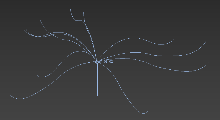

  2. GrowFX Object were prepared in the usual way, with paths to define the placement and deformation of the leaves
  3. In GrowFX, use the Instanced Mesh builder to add the atlas geometry to the plant. Just like Forest Pack, you have options to control the probability of items, randomise the scale and more. If you want to deform the leaves to follow the splines, make sure that you enable Combine Meshes and Deform Along Path.
In case you don't have GrowFX, We've included meshes for the saplings and the ferns in the scene file. All you need to do is import the same atlases that we used from Megascans Bridge, and apply them to the models.

  4. To remove the saplings from the path, go to the Areas rollout and add a new Shape Area. Pick the path spline from scene, set the mode to Exclude and increase the Thickness until the trees are removed from the footpath.
  5. Remove the saplings from the building by adding a new Object area and picking the house from the scene.
  6. We also want to remove saplings from around the existing trees. Add a new Forest Area by clicking the Using Megascans products with Forest Pack-image2017-9-12_13-42-37.pngbutton and then picking the trees Forest object from the scene. The collision detection takes into consideration the tree's canopy, but we're really only interested in the trunk. To compensate for this, reduce the Scale value.
  7. Add a second Forest Area and select the Forest Pack used for the hero models to ensure they are not covered by the saplings. Again you may need to reduce the scale a little.
  8. Finally, go to the Distribution rollout and adjust the Density settings until you're happy with the amount of saplings.

  1. Using Megascans Bridge, import the plants you wish to scatter. The process is exactly the same as for importing the 3D models.

  8. We want to remove grass from the center of the path, to do this, edit the falloff curve and create a graph that spikes on the right hand side, as shown below.

  10. Open the DistributionMap rollout and adjust the Density to get a good packed distribution of plants. Our scene is now complete and ready to render!

This concludes the tutorial. We've layered up 10 Forest Pack objects onto a single surface, each affected by the same spline so that if you wanted to adjust the path, you'd only need to edit one object. Enabling each scatter  in turn we can see how they interact.
We have one Forest Pack object each for the twigs, the leaves on the path, the fallen branches, the patches of leaves, the grass on the side of the path, the hero models, the saplings, the ferns, and finally the trees. Although here we looked at a particular scene the principles should be easy to adapt to any other combination of splines and surfaces as well as other types of assets. If you use these tutorial files, or the techniques shown in this tutoral, to create any variations on this scene we'd love to see them on our forum. Otherwise, stay tuned for our next tips and tricks installment and check out our other videos in the tutorials section of the website
